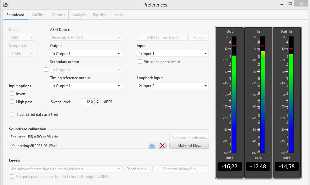

Focusrite Solo Calibration/loopback:
When soundcard calibration was made, I looped Output 1 (TRS connector using TR tabs) to Input 1 (XLR connector pin 2 & 3). I also connected Output 1 (TRS connector using TR tabs) to Input 2 (TRS connector using TR tabs).
Note: Input 1 (XLR) is a mic input at Solo, and not a line input as in some other sound-cards offer. Hence I use a 10:1 attenuation (voltage divider) when measure speaker output signals (see below for detail). Input 2 is a line input.
In REW Soundcard Preferences, the setup were done as below. Levels were adjusted according to the bars and a calibration file was generated. With the calibration file used the frequency response is ruler flat from some Hz to +30kHz.

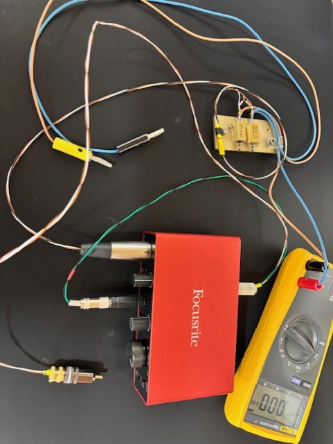

Measuring DUT:

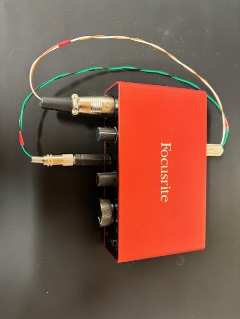

When measuring the device I removed the loop back harness, and instead used this one.
The power resistors are two resistors of total 8 Ohm. Banana plugs are connected to speaker outlet respective to a Fluke true rms ac volt meter.
Parallel to the power resistors there is attenuation network of 100K resistor in series, and between them two 10K resistors, making a virtual center tap and a 10:1 attenuation for each leg.
This "pseudo balanced" signal (two hot and one virtual ground) was connected to the XLR at Soundcard Input 1
Soundcard Output 1 (TRS connector using TR tabs) connected to av RCA male attached to the DUT input. and also to Input 2 (TRS connector using TR tabs)

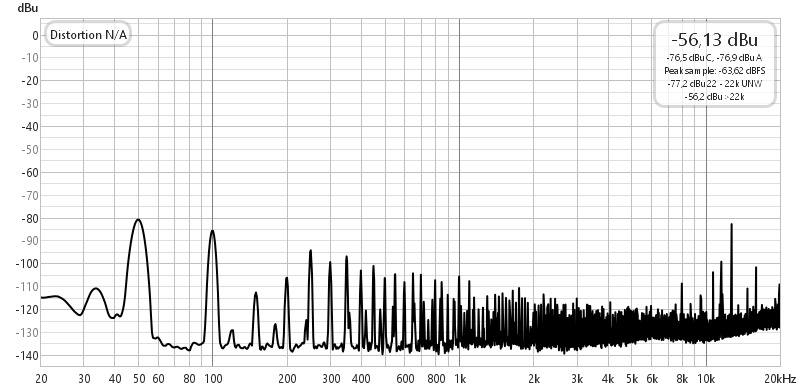

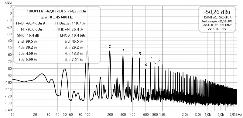

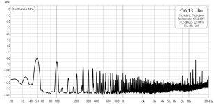

Turning the DUT on with no stimuli added. this is what the FFT-plot shows. As seen there is an annoying peak at 50Hz and it´s harmonics. Note that there are also peaks in the 8kHz - 13kHz region. I have no idea what causes that?

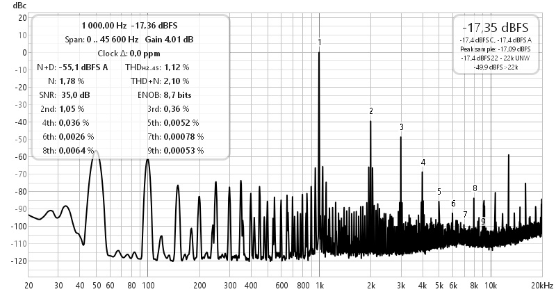

Measurement 1W output (2.82Vrms /8 Ohm)

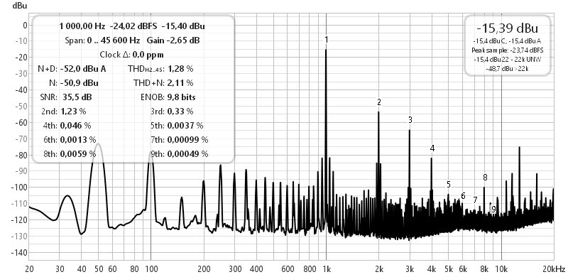

With 1kHz stimuli added the plot shows as below. 50Hz peak increased to -60dBc and one can see that the 1kHz stimuli (and its harmonics) are modulated.
Anyone seeing anything odd or faulty done in this so far?

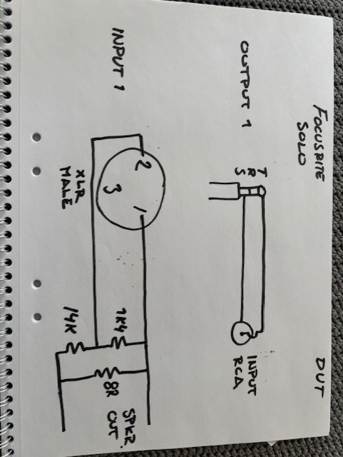

One of the (few) cons of Diyaudio is that it´s hard to summarize the long threads, reading afterwards. It´s very easy to misunderstand if discussions is´t followed then they are present. Obviously I have misunderstand some of the older posts regarding how the measuring harnesses shall be connected.
Just to make one thing clear. I only measure single end amplifiers and if not exclusively, mostly low power tube amplifiers.

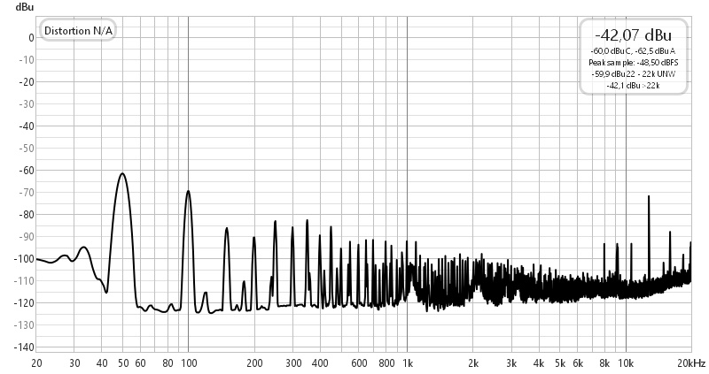

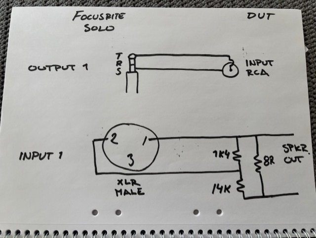

Now, this is how my new harness is connected.
And this is the plot when amplifier is turned on, with no stimuli. Note the 50Hz peak are still there at -80dBu. But H2 is -54dBu.
When 1kHz stimuli and 1W output, the 50Hz peak is -57dBc. Pls. note that the previous plot was measured in dBu, and is now changed to dBc (decibel to Carrier).

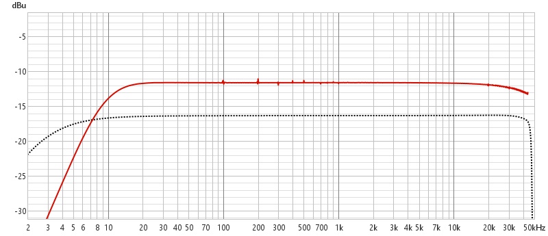

I also made some frequency response measurements. Besides some small ripples, I see no abnormalities here.

Look at this circuit: measurement setup
I previously made that virtual ground network between amp output and Solo input. But I was told that this was only suitable for H-bridged amplifiers and not for single end.
Now I don’t know whom to listen to?
This circuit shows a balanced amp output - pointing into the wrong direction
Do you mean my circuit or the one linked to in post #10 ?
If mine. I don’t see what’s wrong. XLR pin 1 is gnd. Hence pin 2 sees 1:10 of Voltage feed by the amplifier over the 8 Ohm load.
