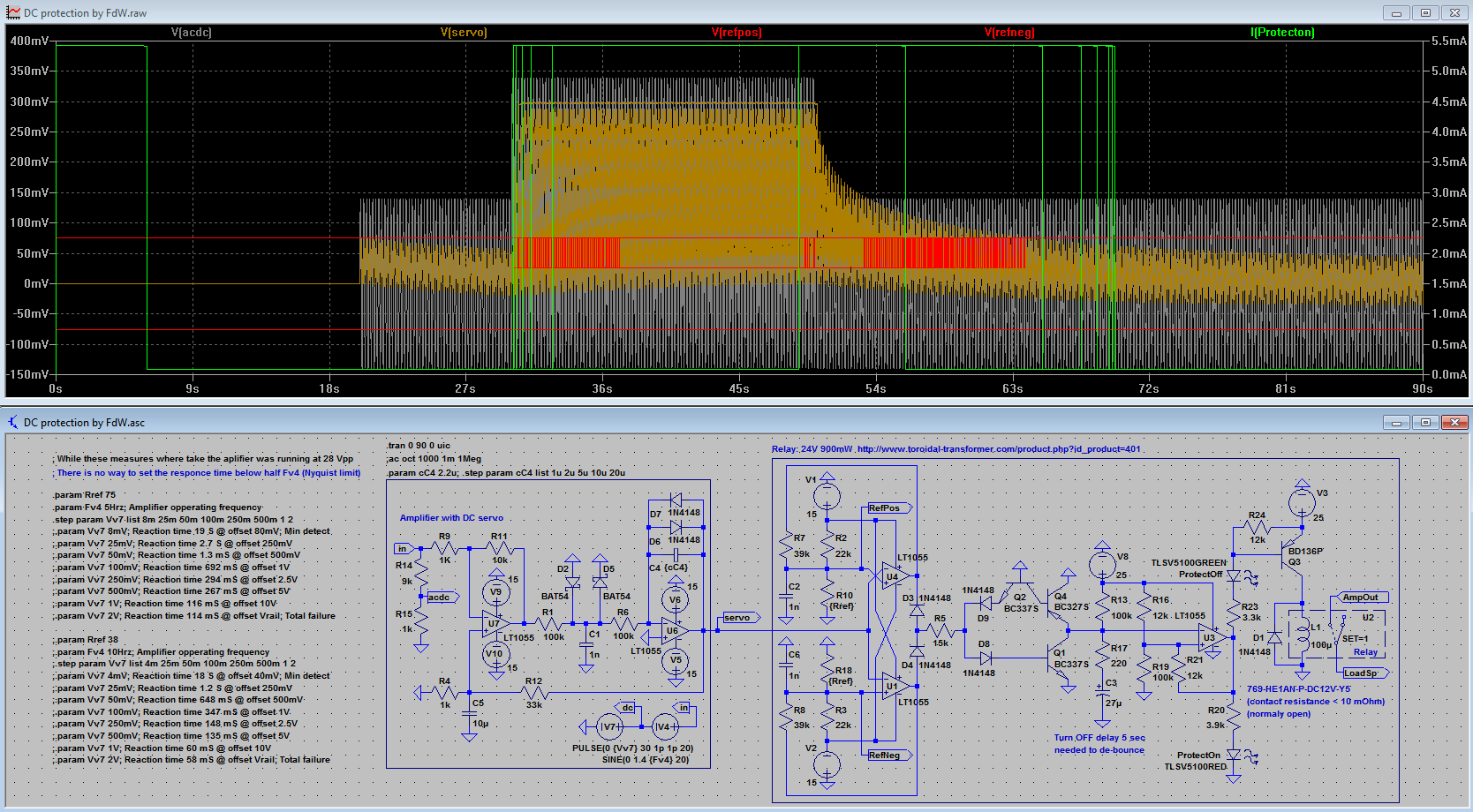

This may be the truly final one, the response times are very near the theoretical limits, for the 10 Hrz max output signal it is now down to 58 mS (where 50 mS is the lowest possible). Anyway, as before, I would appreciate comments.
The one thing that I still have to do is select an relay. So if you have an idea witch one to use, then let me know. It may be a bit expensive (let’s say up to 40 Euro (50 $ US)) but I would like an contact resistance below 50 mOhm (near 10 mOhm if possible).

a new strtegy to compare to your existing.
The DC servo when fed from +-15Vdc will have a maximum range of output (correction) voltage of about +-13Vdc.
When the amplifier is working properly and there is no external DC voltage leaking in I would expect the DC servo's output correction to be <=+-100mVdc.
If the correction becomes larger then something is going on that should not be happening.
If the correction reaches either of the +-13Vdc limits the Servo can no longer correct the error and the output offset goes off scale.
apply your window comparator without any filtering to monitor the servo correction voltage. If the window comparator is set to +-12Vdc then the servo is still controlling but there is a serious fault. The comparator shuts down the output, BEFORE the damage is done.
Except when it is a fast failure when the servo's own filter will delay the detection of the excessive correction voltage.
This strategy has only one filter in the system. It should react as quickly as any other, and maybe faster.
You can add on bells and whistles. eg input mute, rail shutdown, output relay isolation, locking relays etc. Each can be triggered by either input offset, or output offset.

There is no way in the world that you can react in less than '1/2 * 1/Hrz' seconds (that is 50 mS for 10 Hrz (actualy 58 mS)) this exactly what my circuit does. If you are going to allow 5Hrz then the reaction limit will be 100 mS.
If you have a look at the diagrams (servo output) then you will see that you need to add some hysteresis to the window comparator and the output buffer (to filter ‘fast re-triggering’).
If you allow the DC-servo to go to full swing, e.g. 13V +/-, then it will take up to a few minutes to recover/return to below the detection limits. That is what is prevented by D6 and D7.
If you remove D2 and D5 the your detection limit will be lower, due to the fact that AC then is an even larger portion of the input signal (to the integrator).
