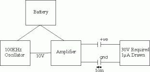

That's pretty much what I need to do yes. The device on the other side of the plates is passive but the capacitive coupling should still work. The gap needs to be about 1cm and 30V is needed on the passive side. There's no way to amplify the signal on the receiving side which is why I wanted to send it using a high voltage. I'm a little bit confused by the requirements now! What sort of voltage do you think would be necessary using a 1cm square plate and having a 1 cm gap. We did a capacitance measurement of a smaller gap and it was in the picofarad range.
It's probably best for you to draw out as a block diagram what you want, and put in signal sources and levels.
What do mean by "the device on the other side is passive" ? but needs 30 volts ? don't understand 🙂 Passive... no power... why 30 volts. Do you mean you need 30 volts of signal coupled through the gap ?
What are you going to do with the signal on the receiving side, just measure it in some way ? how ?
I've uploaded a block diagram of the main parts of the design. The "passive" device evidently isn't passive - it's not my part of the design but i think it was called passive due to the lack of battery but it it evidently isn't as it needs 30V to wake it up! The signal is rectified on the other side to power the components. Can't really say whats happening on that side due to NDA.
The parts to the left in your diagram are pretty straightfoward.
It's what's on the right that's not. You can get the "signal" onto the receiving side, but to me the 30 volts 1ua bit doesn't mean anything.
There are a lot of practical problems. Whatever you use to measure or receive that signal is going to have to be powered (active).
If you apply the signal to the left plate (say 100khz sine) then it should be recovereable on the other side, but only with some carefully thought out electronics... perhaps an opamp using guard rails around the inputs to maximise the input impedance although that is more for DC measurement.

Thanks for the help 🙂 The NDA states that I can't give details of the project so can't really say what its all for which is a bit unhelpful unfortunately! The device on the right is already designed elsewhere and the monitoring of the transmitted signal is sorted however i will have to match the impedance's to avoid reflections in the transmission. For now I will just look at a suitable way of boosting the voltage.
