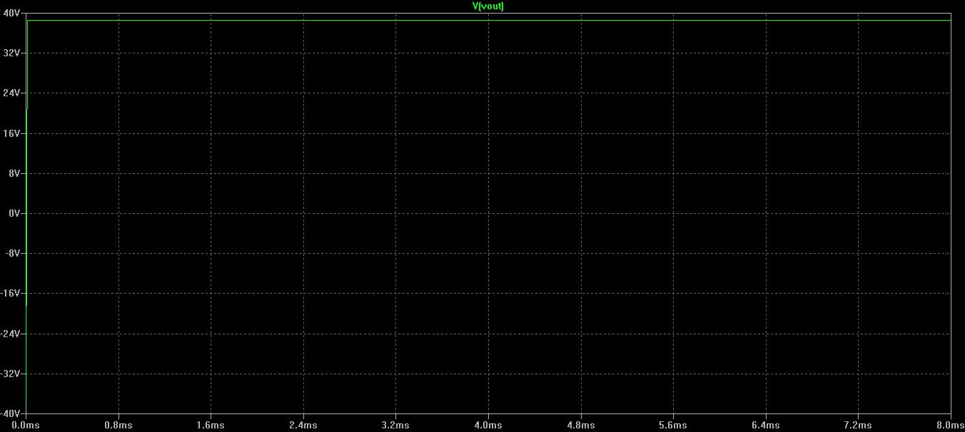

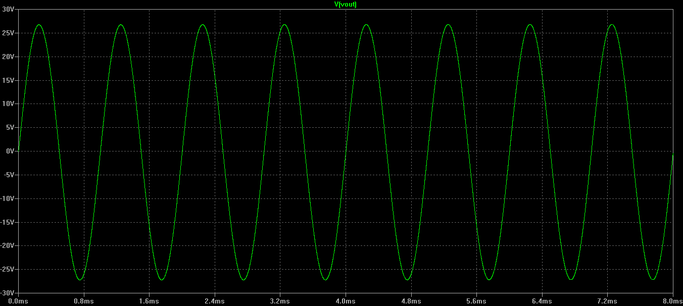

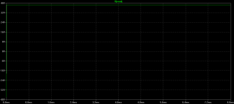

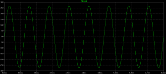

Hi everyone,
I'm simulating an amplifier based on one of Bob Cordell's designs, but in the simulation, when I use 5, 7 and 13 ohm loads the output stays at 40V, I don't know what is causing this, for 4,6,8 and 16 ohm the output graph is ok, what's happening?
I'm using LTSpice.
Attached examples of the outputs, simulation file and Bob Cordell's models.
Best regards,
Daniel Almeida

Spice does funny things if inadequate accuracy settings are chosen. If you simulate for extended times, the automatically chosen timestep might be too large, causing the simulation output to be garbage.
Rundmaus
EDIT: Looked into your file. I wouldn't trust a simulation starting at time zero. Let it 'run' for 10-20s and start taking data then.
you may also want to use the "startup" and "uic" options to see exactly what the circuit will do from power up. let it run for 5-10s like that and you will see any powerup oscillation and the effects of the input/feedback caps charging

Yes those comands after tran also works, but the problem is that I've no op.
If I use .op instead of .tran 8m startup uic it gives me wrong values, with .tran 8m stratup uic the transient is fine, but I have no operation point.

OK...I have duplicated the problem.
It's a latchup issue in the simulator, that might actually happen in the real world.
The simulator starts at a bad output voltage, that puts a bad voltage on C3, and pretty well ruins the operation of the input stage, and then everything stays bad. Place back-to-back 1N4148 across C3, which is probably a good idea anyway, and the problem is solved.

That's the interesting question.
The diodes are a good idea, as it prevents too much voltage across the cap under fault conditions. Still, the funny thing is that C3 starts out with about -37 volts across it...that just wouldn't happen in real life unless the positive rail was missing.
Interestingly, if you let it sim for 800 ms, it comes out of the funny state around 700 ms.
More interestingly, I changed Q2's model from the 2N5401C model to a different 2N5401 model on my machine, and the problem went away.
Hmmm...I'll report more if I see something definite.
Dan
