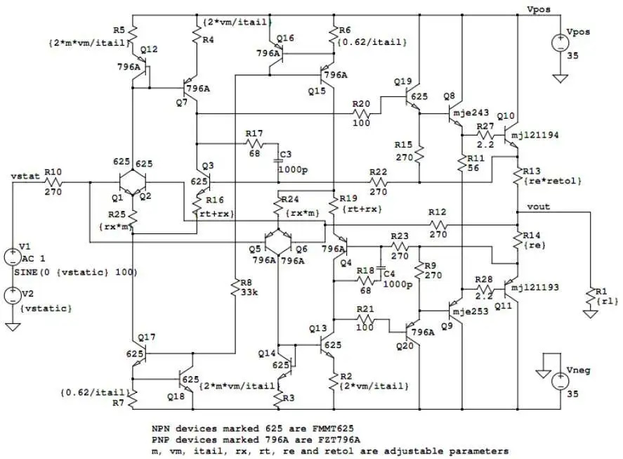

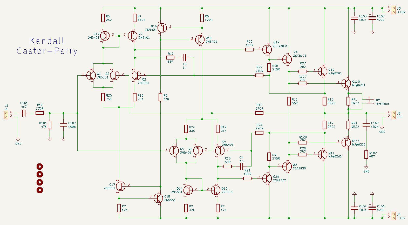

I know I am late for the party, but I wonder if you or anyone did make this amplifier?
After looking at the KCP amplifier previously referred to, I wanted to make one. But I couldn't figure out how to make it complete...
Is the original KCP amp only an 0dB OPS, needing an IPS? With or without global feedback?
Here is what I have done so far:
Original schematic, I think:
Thanks for any answers!

The GNFB is taken on top of 0.22 Ohm. The GNFB approach looks like MF-A1, but it could only be used as a unit buffer. I don't think it is worth your time to build it.I know I am late for the party, but I wonder if you or anyone did make this amplifier?

There is feedback via Q3 and Q4.
It's a unity-gain voltage follower meant as an amplifier output stage with a very subtle distortion compensation method in it. It is described in detail in Kendall Castor-Perry, "Look, Ma, No Distortion! The Class i output stage", Linear Audio vol. 2, pages 65...88, September 2011. Don't ask me how it works, as I never really understood it.
It doesn't seem to have anything to do with post #1, nor with the thread title, so I wonder why it is in this thread.

The amplifier in post #12 is applying feedback individually to the two complementary halves. The purpose seems to be to regulate the bias (note that there is no Vbe multiplier).
I don't believe a class AB amplifier can ever be made distortion-free. Even if the crossover can be done perfectly, any mismatch between the complementary halves will produce even-order distortion.

I finally understand dreamth's association between the thread title and class i: the distortion compensation method in a class-i output stage ideally leads to a small, predictable and signal-independent output stage output impedance.

This is a non-switching amplifier. The reduction in distortion is due to feedback. The output transistors' emitter resistors are outside of the feedback loop.

Indeed, but with separate feedback loops around the push and pull sides that gradually go from voltage follower behaviour to current source behaviour, designed such that they complement each other very well.
I guess the usability of the class i voltage follower as an output stage in an amplifier with overall negative feedback will depend on how wideband the class i circuit can be made, as its poles and zeros affect the overall feedback loop. Of course the same holds for the more conventional voltage followers that are usually used as output stages (such as Darlington emitter followers and Sziklai pairs).

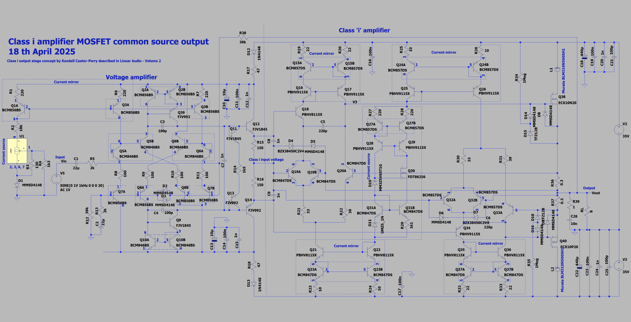

I have also been experimenting with this concept and made various changes to create a working prototype.
The prototype includes a voltage amplifier and overall feedback to make the output impedance low.
The tests on the prototype used an unregulated power supply:-
Voltage gain at 1 kHz = 19.5, 27.7 dB.
Small signal frequency response 3.7 to 255 kHz.
Power bandwidth to 1 % distortion, 8 ohm load, 58 kHz.
Slew rate 11.5 V/us
Harmonic distortion, 8 ohm load, 40.5 W:-
1 kHz, 0.006 %.
20 kHz, 0.03 %
Output impedance, difficult to measure with accuracy, but my best attempt was 6 mohm at 20 kHz, measured at the feedback take off point on the PCB.
The distortion performance is mediocre but cross over distortion is low because the output stage doesn't switch and the transition between supplying output current and idling is smooth. Most of the distortion appears to be due to the non-linearity of the voltage amplifier.

Hello M0rten, Thanks for your interest. In my first post I attached an LTspice XVII file that contains the following schematic.
