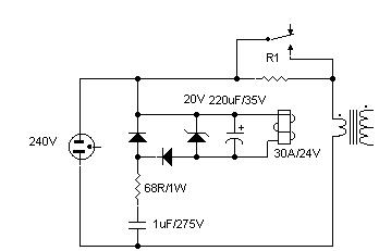

Soft Start Circuit
Below is a soft-start circuit lifted from a pro-amplifier.
The delay is about half a second or so, and this seems sufficient.
As for protection, crowbar shorting (scr) of the DC rails causing 240V input fuse or breaker to trip would be the sonically least damaging configuration possible.
Eric.
