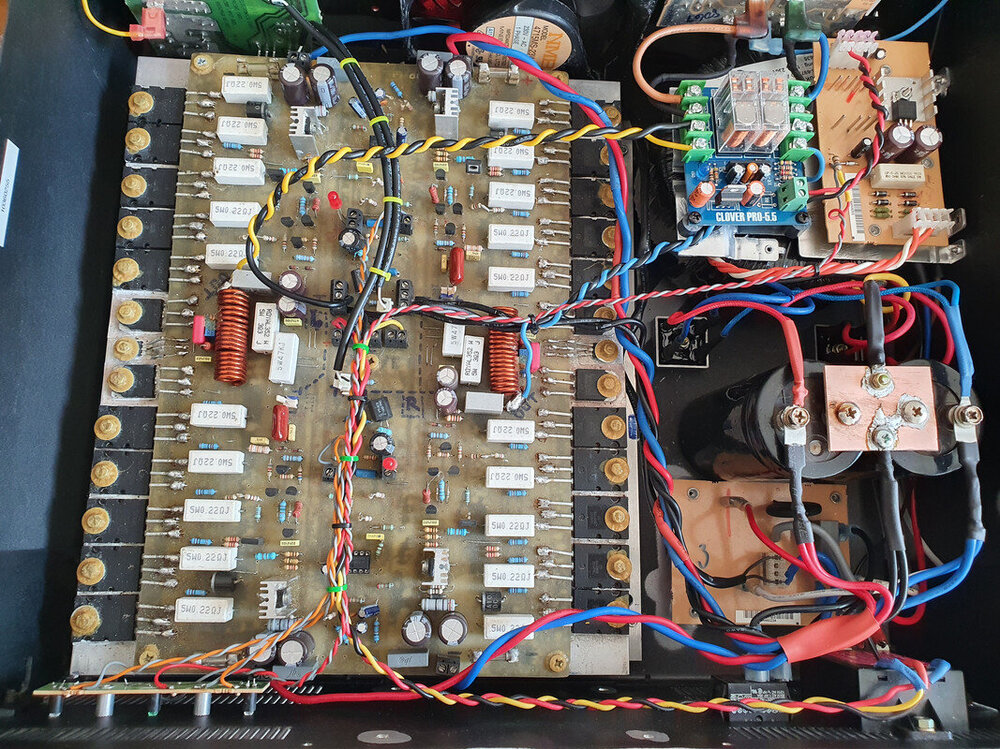

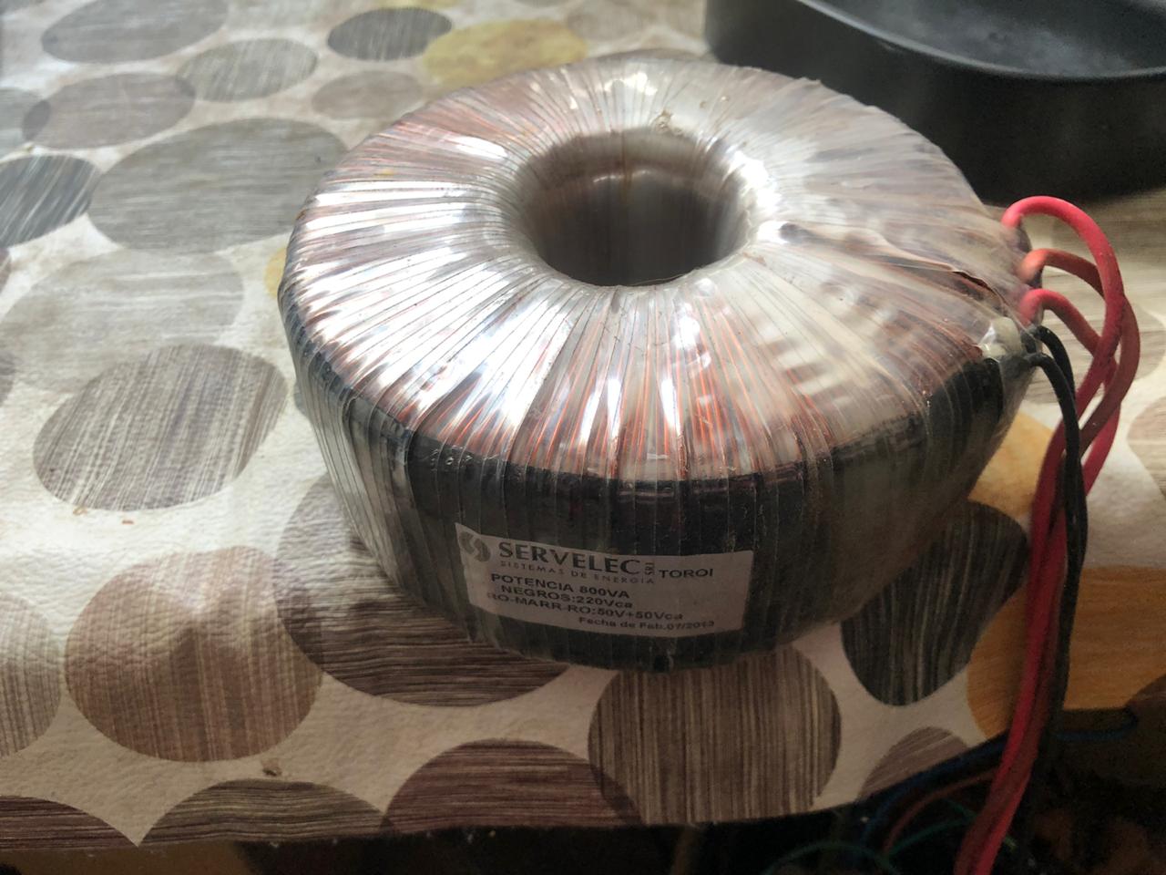

Sorry I got confused 70 + 70 CC 50 0 50 ac 800 VA.
I was thinking of making the Apex AX 14 Golosa or NMOS 350 how it would behave with 70V
That is the correct size for 200 w/ch 8 ohm, 300w/ch (maybe a bit more) at 4 ohm, and would run 2 ohms without serious overheating. Use 5 TO-3 or 6 to 8 plastic output pairs.
