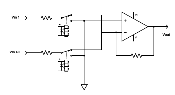

With all of the 40 inputs going to a single mixer IC inverting input, the noise gain will be very high.
For each source you could use a series resistor selected for proper gain, which then goes to a relay.
The relay selects sending that signal line to either audio ground (off), or to the op amp virtual ground (on).
In this manner, only eight lines are connected to the mixer op amp's negative input at one time,
so the noise gain is five times lower than having all 40 lines connected at the same time.
Because of this, the noise floor will be lower, and the audio high frequency bandwidth will be higher.

If the channels are summed in the digital domain, the concept of noise gain does not apply.
That is only for an analog op amp with feedback. It's not really about noise per se, but more
about how a real op amp functions in a circuit.
Noise gain is the effective gain referred to the positive input, even if there is no signal applied there.
All the 40 audio lines applied through a resistor R1 to the inverting input are in parallel for noise gain,
so the noise gain is 1 + R2 / 40R1, even though the signal gain for each line is - R2 / R1,
where R2 is the resistor from the output to the inverting input.
So there would be narrower HF bandwidth and a higher noise level.
