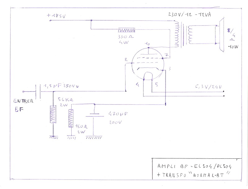

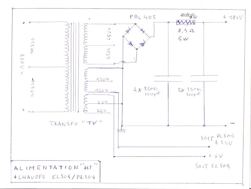

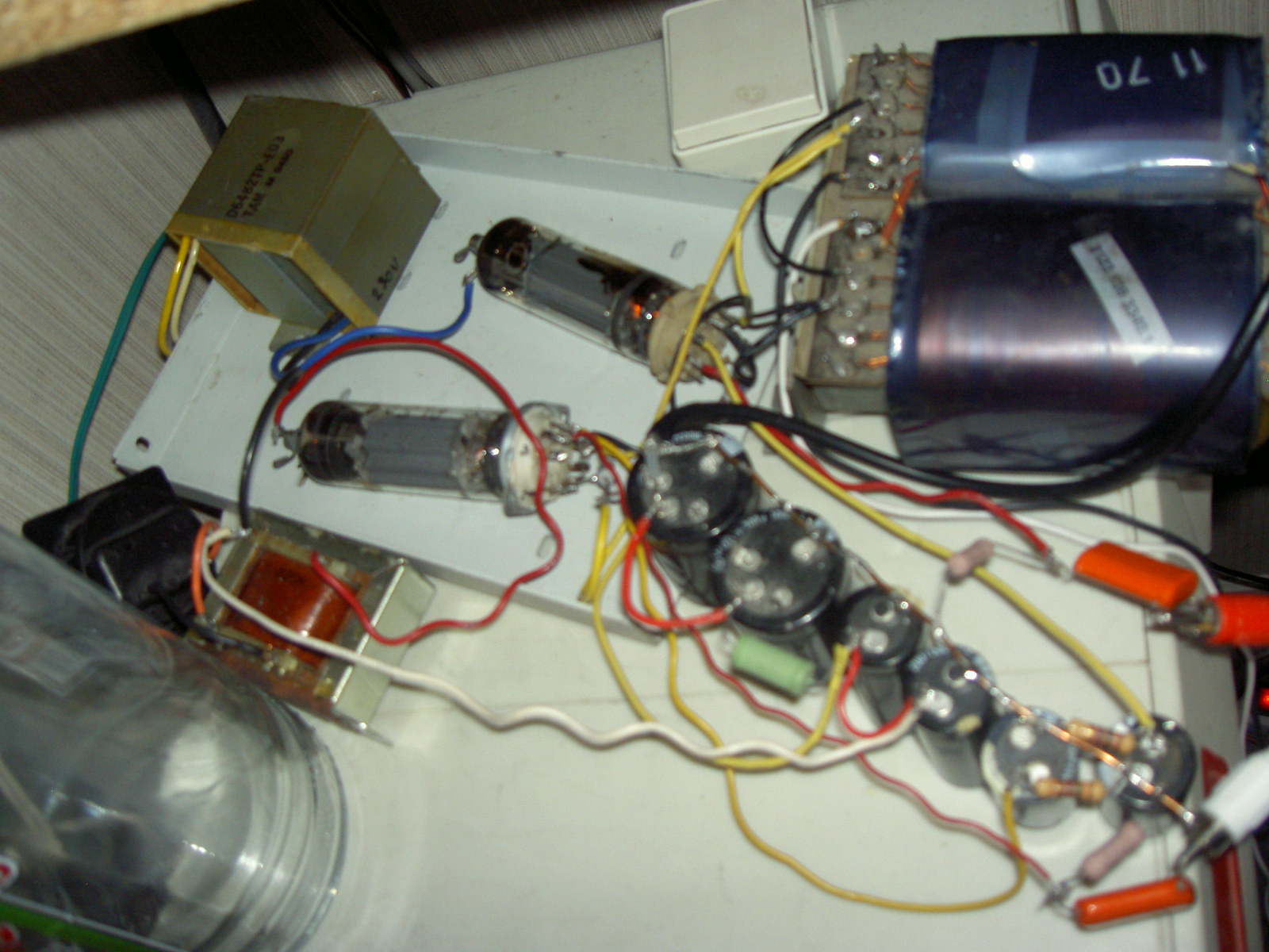

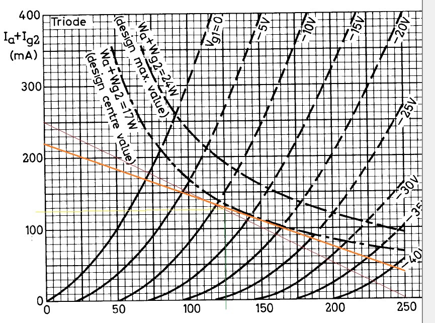

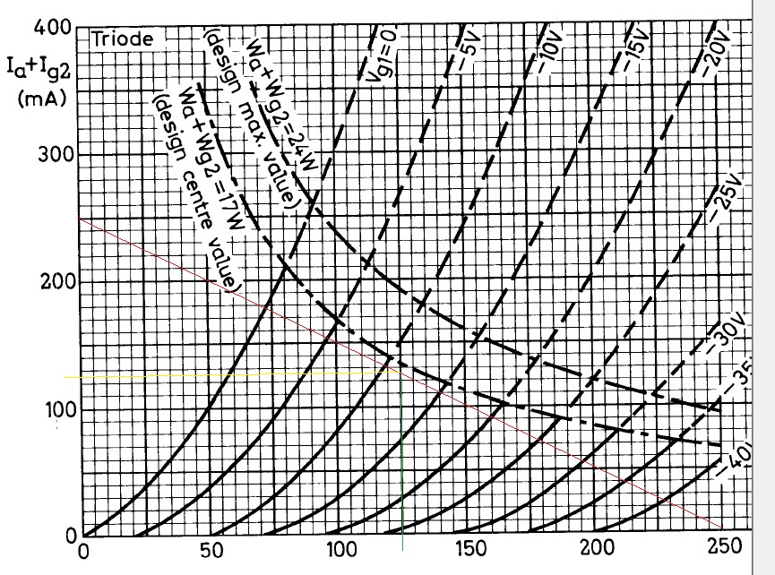

Amplificator Class A 2 X EL504
We have already tried thoroughly to explain him that he was on the wrong way, in many french forums, but he still refuses to understand our explanations.
The best to do is to give up, because he's absolutely certain to be guided by a divine truth.
As he described himself as a genius, we think he does not need any help.
He'll rather soon teach us how we should all do...

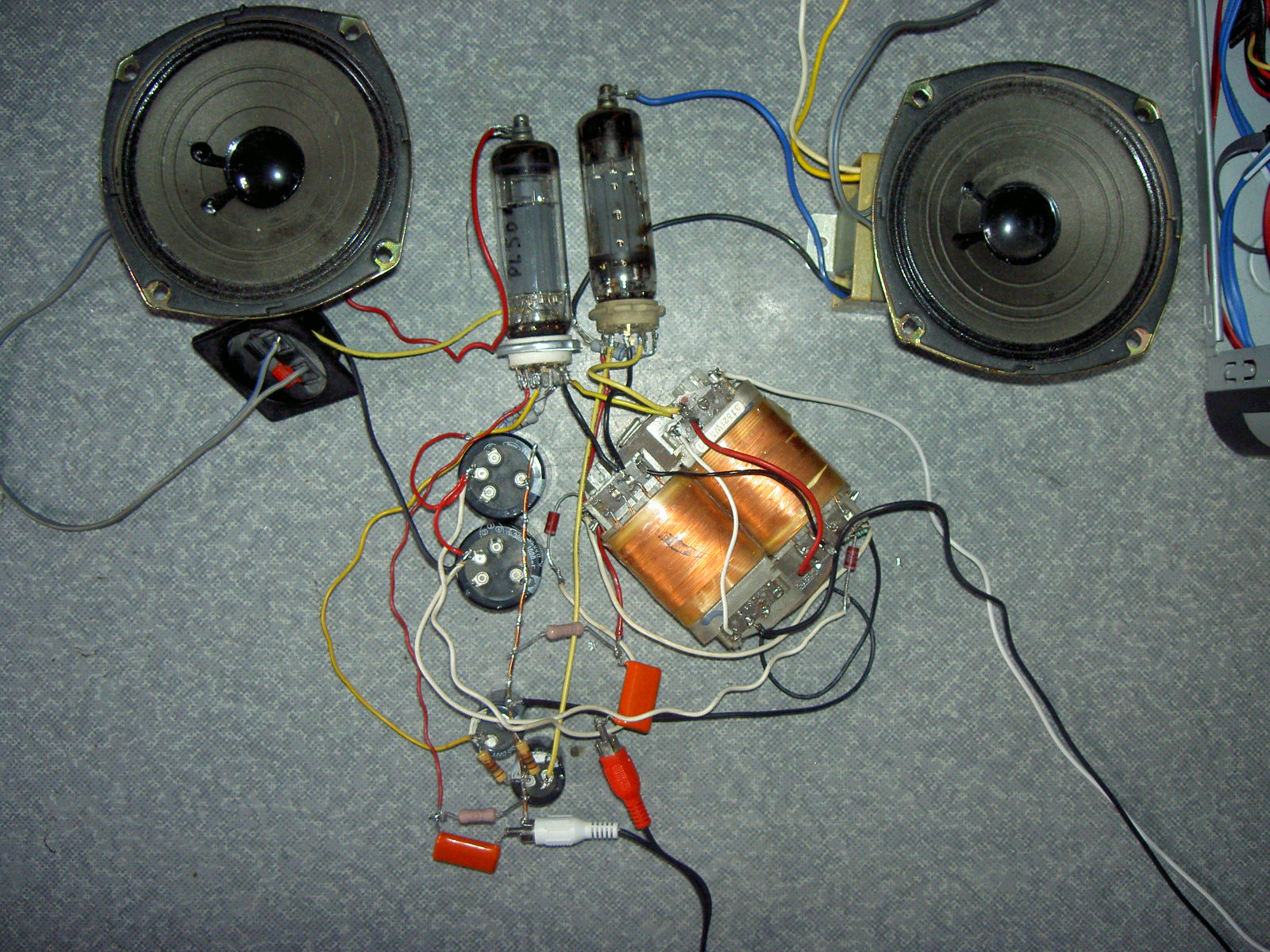

hello ,

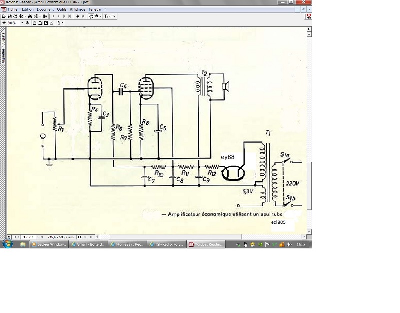

I do not refuse d to have of better performances but I am limited to the price d purchases of the audio transformer, the blow with not much way, j have to take up a monster who would much more give with parts to adapt closer of this assembly, c is the case of my ampli ECL 805 which gives to him of very good result but to the detriment of his minimum price, we cannot have the material has discounted price and performances deserving of the best constructio current!
" ou comment avoir le beurre , argent du beurre et la crémiere " !!!
:sad:
