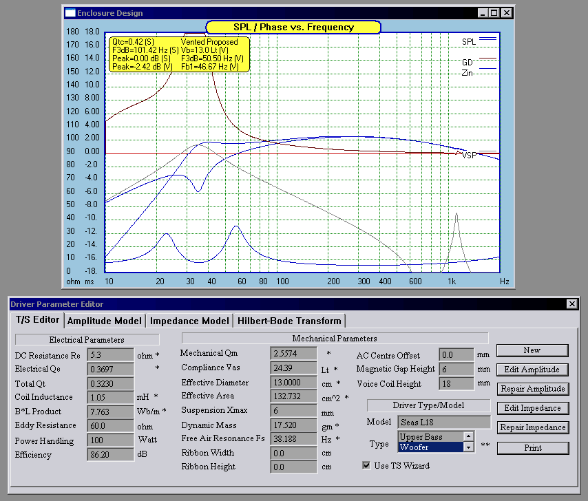

I want to ask you, is it good to use the L18RNX-P in a 30L vented enclosure tuned at 35Hz?
That box is a little on the big side. There would be some drooping in the midbass, and power handling would be pretty low. Somewhere between 14 and 18 l with a tuning of around 40-42hz would be better.
