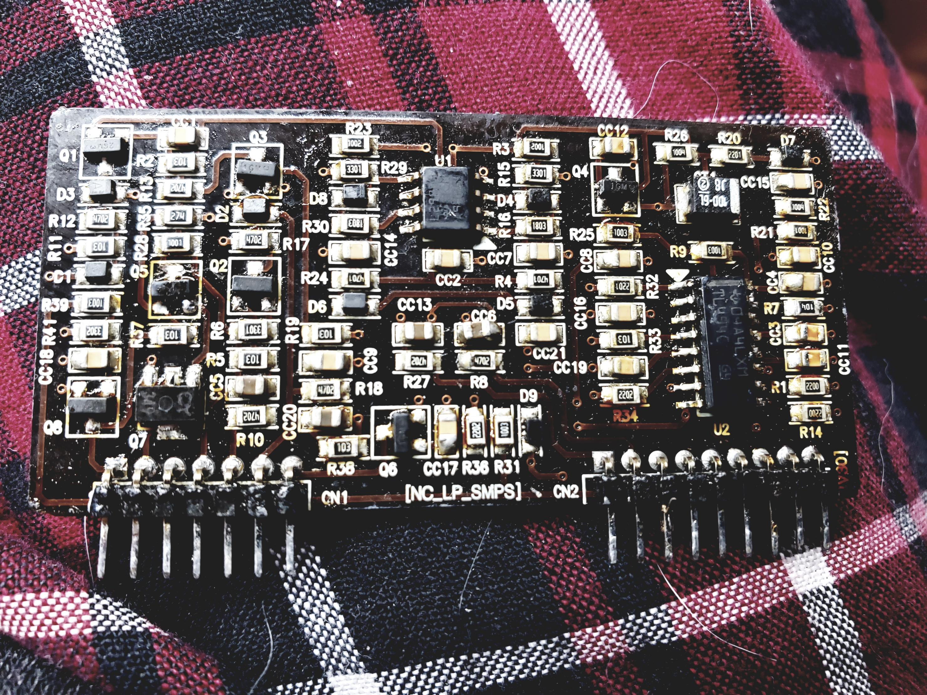

This amp came in with a blown ps. I replaced the emitter follower pairs and have good drive on all banks. After installing the fets i powered it up and something popped but I can't figure out what it was and now when I apply power the amp turns on without the remote connected and the fets on one of the banks is heating up. When i pull the fets out of that bank the amp powers up fine and the voltages and drive signal on that bank are normal.
