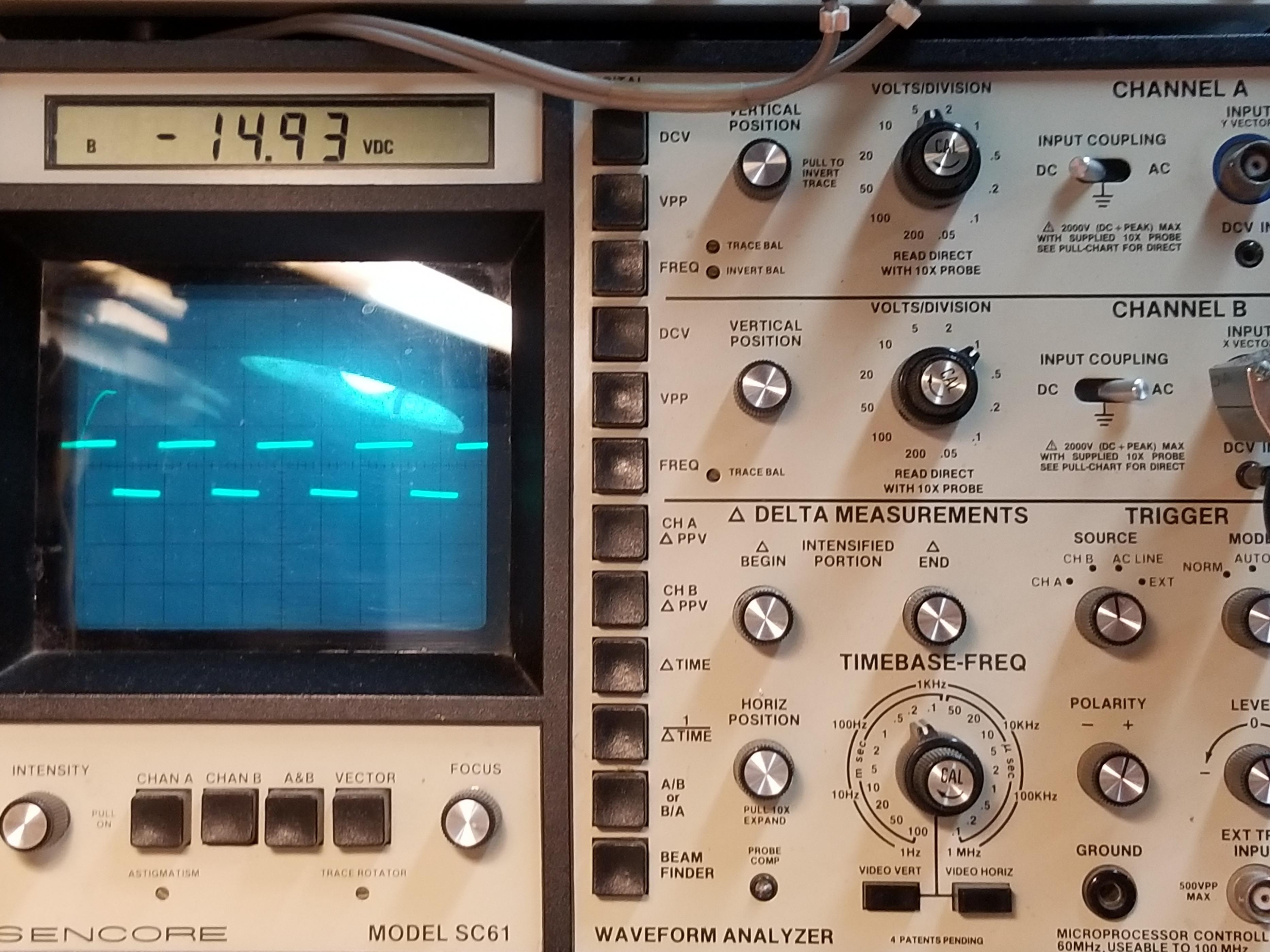

I rebuilt the drive module. Replaced the TL072, LM211, LM2903 (I used a LM393) and both 21844's. Being very careful not to over heat them. I have good low side drive. Put a 9V battery on the high side. Negative to pin 11. Positive to pin 13. No high side drive. Removed the battery and put 2 outputs in just to test. I get a high pitched squall out to the speaker. Doesn't pull current. Lamp doesn't glow. Any ideas?

Both driver chips are missing the high side drive. I guess I could have knocked out both. I did ohm check them after installed. I use a fine bead of solder paste to install them. Takes very little time to flow. Then I clean them up. I'll change them again.
Use the terminals on the IC. That diagram is useful but the references are random. You earlier stated that you had the battery across 11 and 13 which is correct.
What's the DC voltage on pin 2 of the 21844? (black on negative rail)
What's the amplitude of the drive signal on pin 1?
Attached the 9V battery to pins 11 & 13.
DC voltage on Pin 2 is 5.16volts.
Attached pics of the input signal pin1.
For all but the high-side terminals, you place the black probe on the negative rail to measure voltage.
For the waveform, you need to use DC coupling. The voltage is low enough to allow that. Make a note of the negative rail voltage or post a photo of the scope trace on the negative rail.
