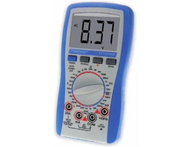

Hi.
So I truned the amp on. After changing resistors I got +49V on the output.
My DMM is looking like this http://www.ehighend.de/pics/peaktech/2010/2010-product.jpg
I measured it not in the 200ohm mode but this mod has a diode drawn on it and you can make it beep if leads are shorted. (sorry for this bad description)

No, the description is fine.My DMM is looking like this http://www.ehighend.de/pics/peaktech/2010/2010-product.jpg

I also found your Multimeter Manual, but even without it, your diode (1N4007/4148) measurements confirmed it 😀
NOW I can trust your measurements 😉
