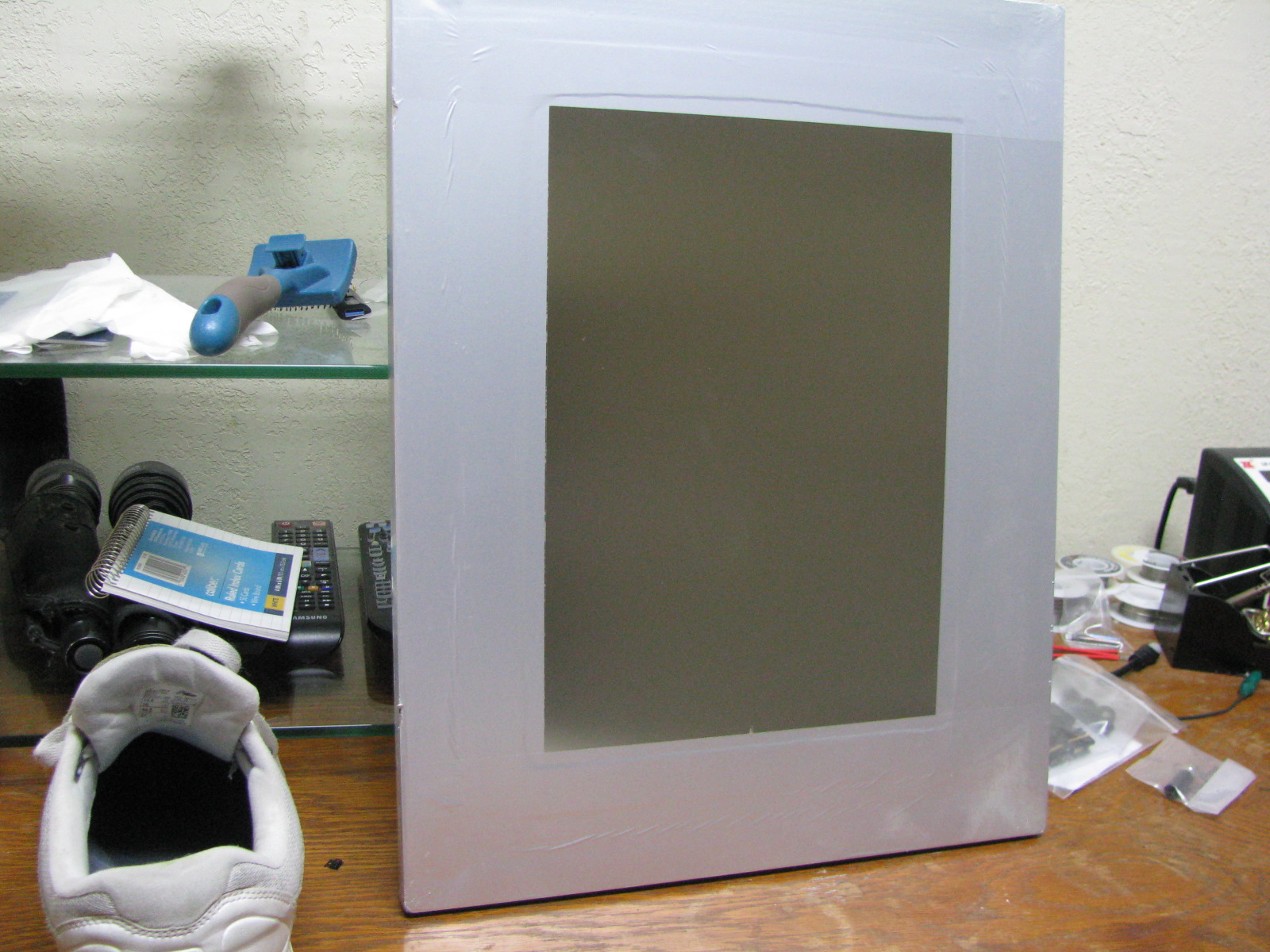

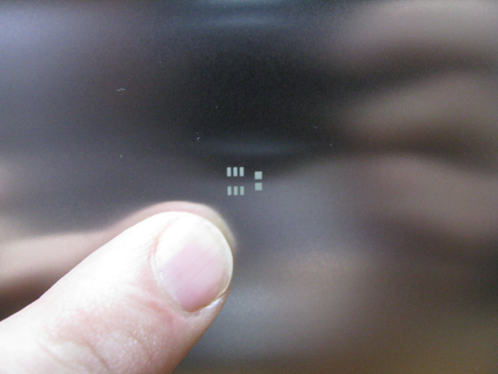

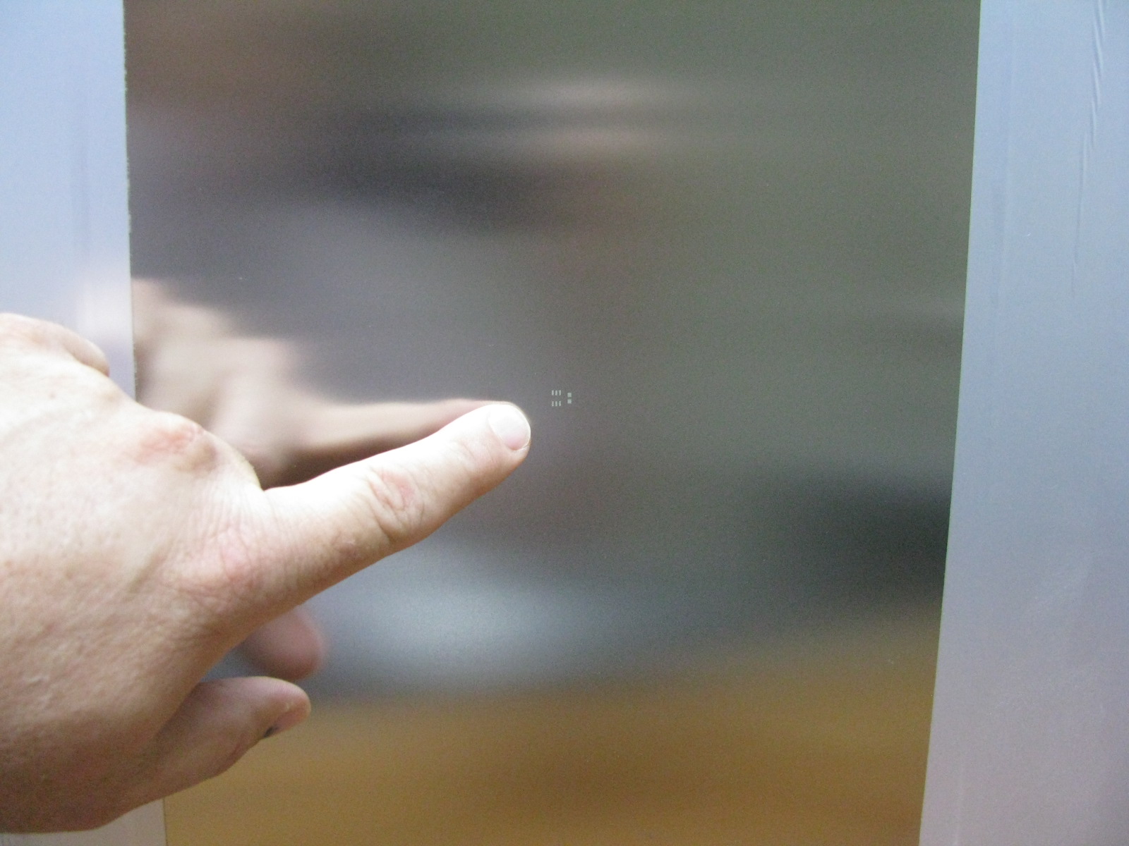

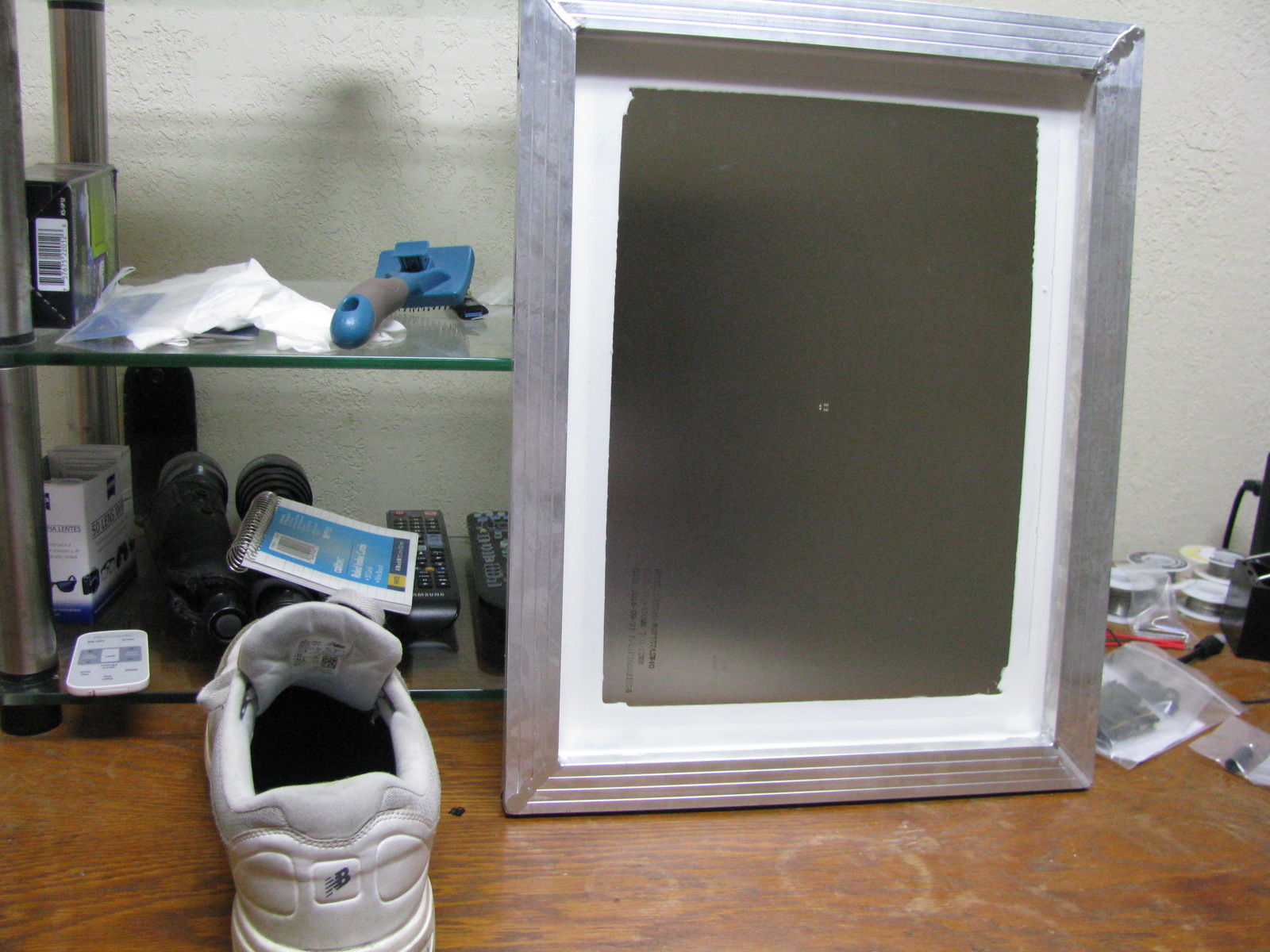

Last summer I had laid out a OPA1622 adapter board, since abandoned, to use on V1.0 of the Super CMOY. I was going to wrap the OPA1688 around it as a plug-in option. I had the PC boards fabricated at pcbway.com where I've had a bunch of other boards fabbed.
I wanted to try a stencil but knew nothing about them. I noticed that pcbway had a "add stencil" option, so I figured why not. Lets see what these things are. $20 for the stencil, plus $8 more in shipping which seemed a bit odd given how small the OPA1622 chip is.
Below is what arrived. 😀 The shoe is there for size comparison. 18.5 inch x 14.5 inch (47 cm x 37cm) on a beefy aluminum frame. 😱 And yes, there are in fact OPA1622 holes right in the middle, as the 4th photo shows, at the tip of my finger.
A real conversation piece to hang on the wall! I'm guessing this fits in an industrial soldering machine somehow. I kept it thinking maybe someday I can cut the little OPA1622 part in the center out and make use of it.
So here is a mistake not to make regarding stencils. 😛
