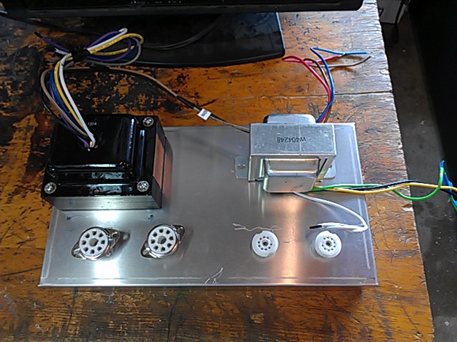

Yeah I know the 90 degree rule. but my PT is flat mounted.... I want to mount the OT as shown. Is this orientation OK? Thanks!
Yes, that's fine, but the tubes are kind of close to the power transformer. Take a look at these.
http://www.thehistoryofrecording.com/Manuals/DynaCo/Dynakit_Mark_IV.pdf
http://www.thehistoryofrecording.com/Manuals/DynaCo/Dynakit_ST70.pdf
Think about it, what is the relationship between a flat one and a vertical one? Is that not going to be 90 degrees?
I might worry about the preamp tubes being next to the power transformer, but thousands of guitar amps have their power tubes next to the power transformer without issue.
