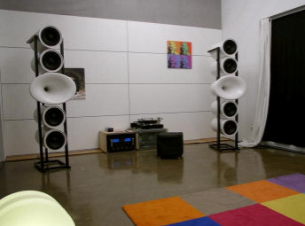

speakers are active, and the crossover is software based at the source end (JRiver media player) so no crossover components to soak up the efficiency- unfortunately this would actually be a good thing in this case!
Yup, noise is a hiss.
Photos wouldnt do any justice as they arnt assembled in any real way at the moment.
The finished thing should be somthing like this-
Im running a tripath class D amp at the moment, so i appreciate this isnt going to be the best, but i have also tried several other amplifiers that proved marginly better- but not anything like good enough.
http://www.jblproservice.com/pdf/Discrete Sales Models/2452HJ.pdf
in a JMLC 350hz horn.

Hi bear,
When you say 'short the amplifier input' I just want to confirm- you are suggesting bridging the + AND - terminals of the power amp rca input (obviously with no source connected)
The amp is a connex unit-
Connexelectronic
mine is a slightly earlyer one, with no vol pot. and the appropriate smps 1000 power supply.
I was under the impression there was no evidence that class A was an audiable advantage over any other??
Up to this point I have owned and used several brand name amps and have found the differences between them subtle at best. Im not knocking any particular brand, its just that Im looking to only spend what I need- so Im looking for the cheapest option that will do the job propperly.
I dont want to cause any arguements over 'this sounds better than that' Its just that I want to stick on solid ground of cheapest proven audiably better only for now.
Could anyone suggest what might be the cheapest <100w amplifier that meets the low noise criteria?
Im also under the impression that a lower output power amp will likely have lower self noise as the gain is less??

Jbl 2452sl as mid/tweeter, pair of jbl 2226h bass, as 2 way. Crossover set around 700hz. Later on the plan is to convert to 3 way with a dedicated tweeter that I haven't decided on yet.
The system at the moment is a computer sound card direct into the connex power amps, all running from JRiver media player. JRiver is doing the room eq (calibrated in REW). Crossovers will be done inside JRiver to multiple sound cards or single FireWire external 12channel sound card. Everything below 65hz is sent to my sub, (jbl 2242h) so I suppose it's actually going to be a 4 way system.
I see... well it seems to me that you will need considerably more power to the mids and the woofers. To match to the horns (assuming you want the same max spl?), which will be scary loud and assuming the realization of 6dB more gain from the parallel connection of a pair of drivers, you'll need about 10-12dB more power. That's if you want the amps to clip at the same time... which isn't really necessary unless you play things crazy loud.
