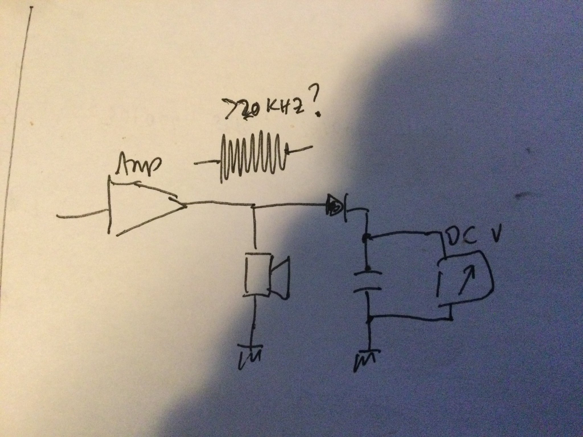

If you had even minimal test equipment, you could determine whether or not current is flowing through the speakers with no audio signal.
If an amp runs cool with nothing connected, but runs hot as soon as the speaker is connected without music playing it is probably oscillating. Chip-based amp designs are often poorly implemented because the designer makes too many assumptions and overlooks things - so it CAN happen. To see if that is happening with minimal test equipment, connect a peak detector circuit in parallel with the speaker (1N4148 diode and .01 uF cap) and measure the DC output. A properly working amp should read zero with no music. If you get several volts of output that you cannot hear it would explain why the amp runs hot.For a little more info, the amp doesn't seem to get hot if the speaker wires aren't connected. Does that mean even without music playing the speakers are pulling from the amp?
Some of these chips run hot anyway with no music playing - but if it is oscillating it will run hott*er*. A lot hotter.
The speaker will draw very little from the amp with a large ultrasonic signal. The tweeter’s voice coil impedance goes high and inductive so not much power makes it into the speaker. It is the chip frying itself that causes the heat - if that is occurring. If this does turn out to be the problem it is a DESIGN issue that needs to be addressed. If it’s not the problem you‘ve got to keep digging.

It seems that you just might have an oscillation going on...I take it your not really a "techy type", don't have a DVOM, (Digital Volt Ohm Meter)...nor any other kinda stuff? It is somewhat hard to diagnose these things by "remote".
The TDA-7265 does have a built in thermal shutdown at 145 degrees C, with a nominal upper operating limit of 85 degrees C. We can see how they arranged that power-chip inside with a somewhat crude rather thick angled chunk of aluminium, & attached it directly to the chassis...not the best of ways to do it. Many commercial amps will try to stuff things inside too tight, making servicing nor modifications easy or possible. Those of us who build-em ourselves, it is much easier to use an oversized chassis, fat fingers & all.
Have you ever contemplated buying such devices, tools, so you can learn more about electronics, by doing stuff? A fifty 'dollar' DVOM would be a great & ultimately useful tool.
Do you know of a local electronics shop who can hook up your amp, setup an oscilloscope & look at the output of your amp, looking for that oscillation?
