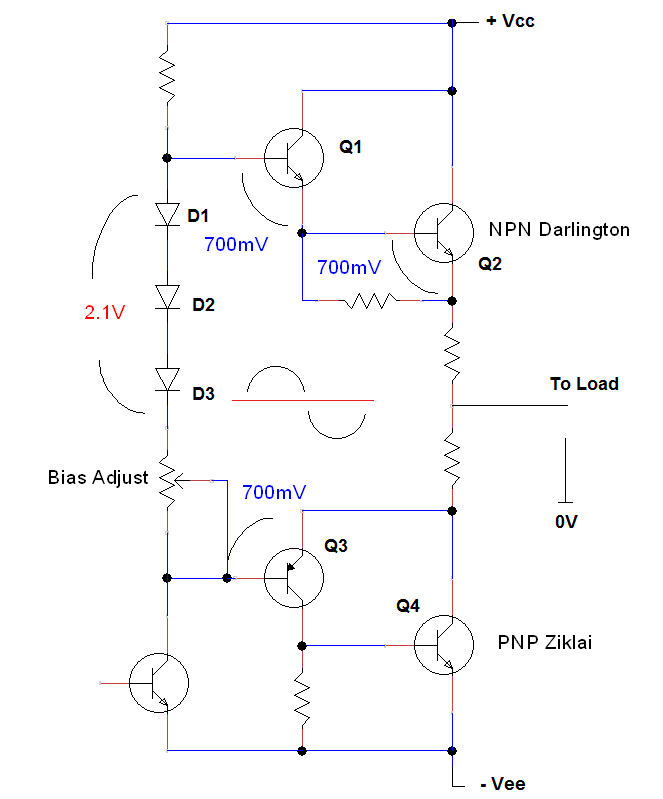

Hi there. I picked up this amp recently for next to nothing. It's a high power (approx 200W into 8) , single ended input amp. It's sounds OK, but lacking some fidelity in my opinion. I'm wondering what kind of amp uses all the same output devices? In this case MJ15024.

Back in the ol' days when it was much easier to manufacture NPN transistors than PNP transistors, they used this configuration. It allowed 'push-pull' operation without requiring a high power PNP. Now that high power PNP and NPN transistors are both available, the quasi-complementary config is less often used.
Thanks for the info - could you tell me why this configuration is rare or unpopular? Do they have a particular sonic signature?
No idea what a "sonic signature" might be, but they have more cross-over distortion than symmetric schemes, all else being equal, although with a Baxandall diode they can be tamed somewhat.
