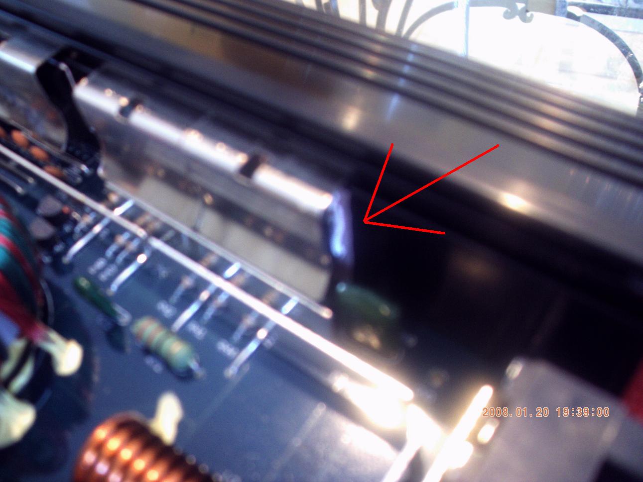

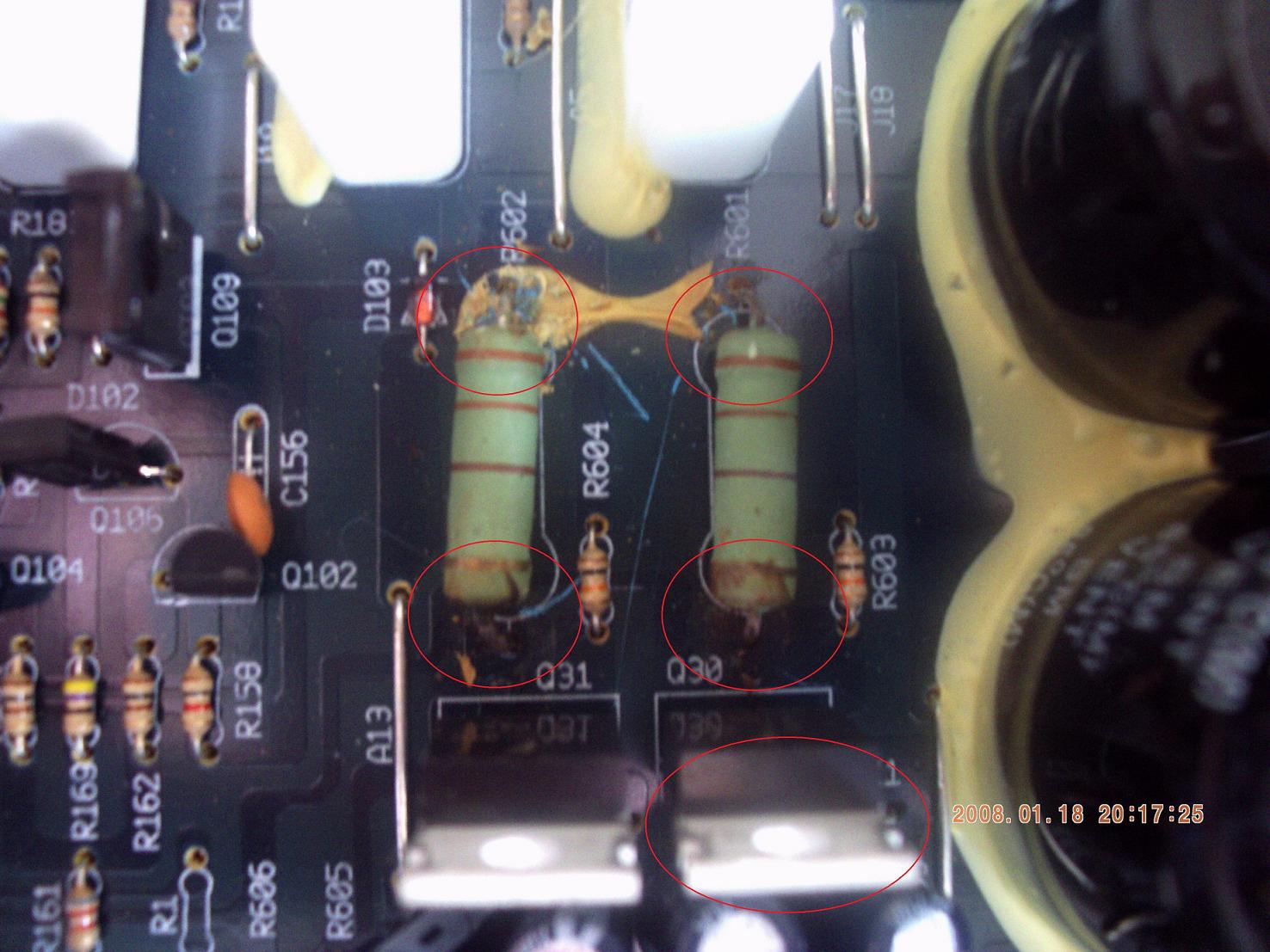

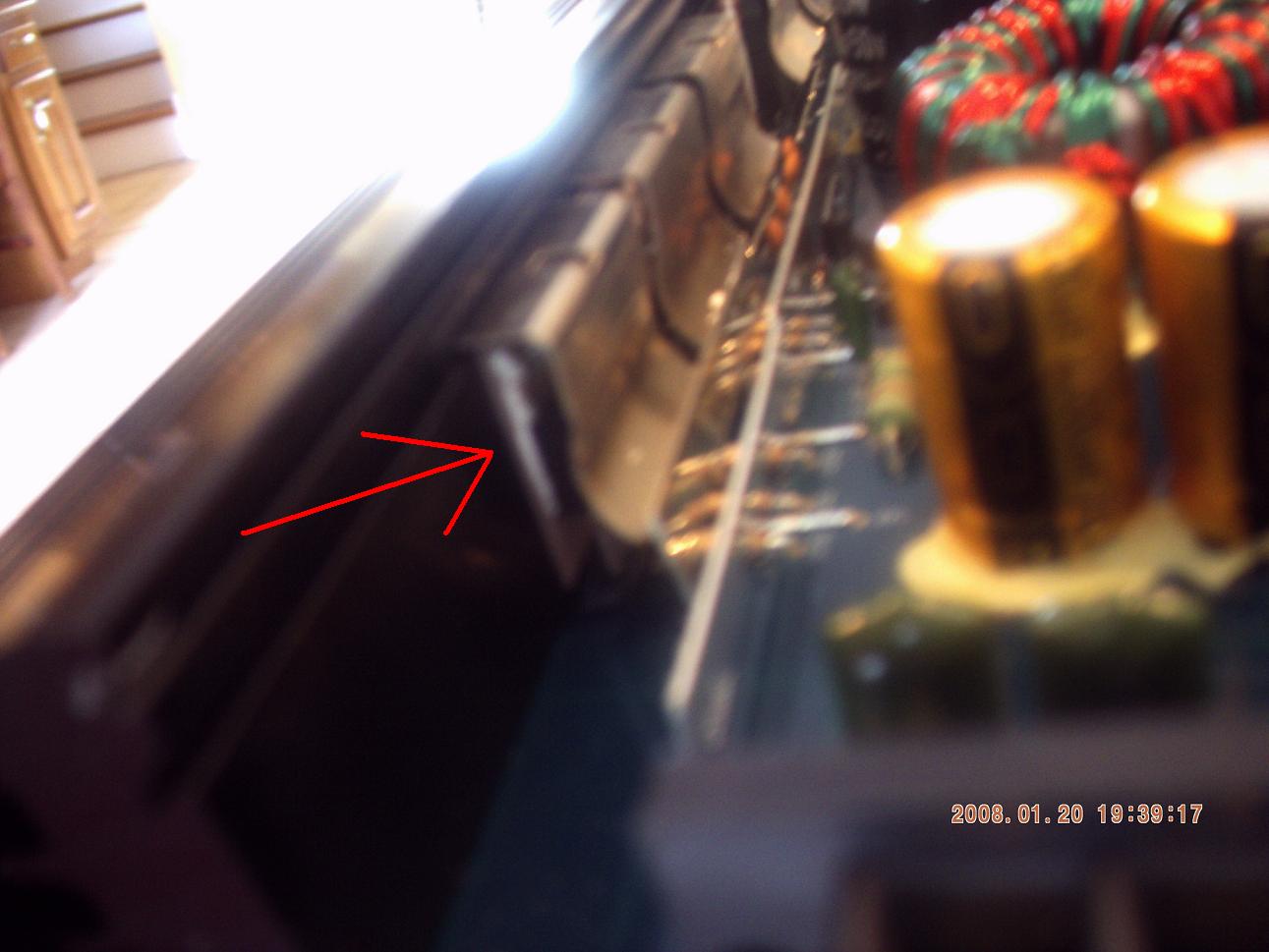

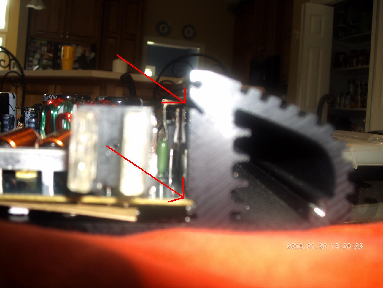

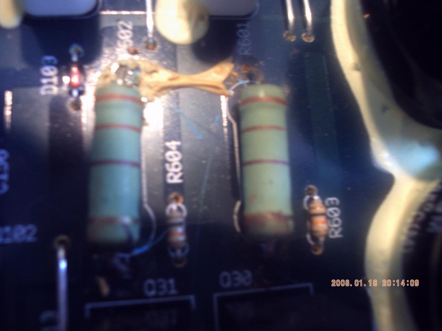

I hope they do because I dont think those are going back on. I got the circuit board off and the underside of the bad transistor and around it is darkened. It looked like one solder point might be bad.

My camera wont focus up that close. But can you still think about what it might be? The amp wont turn on at all, one of the transistors isnt getting power, the heat sink around the transistor was burnt, the back of the circuit board was a brownish color around the area of the broken transistor, and it appears that one of the solder points is missing its solder.
The clips are generally unavailable. If you find a source for them, post it because a lot of people need them. For future reference, this is how you get them off and back on.
http://www.diyaudio.com/forums/car-...sistor-clamps.html?postid=1317683#post1317683
Are the clips damaged? If they are, the amp may not be repairable.

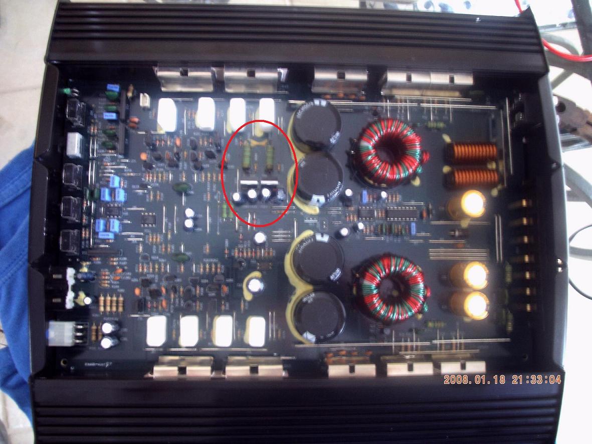

The transistors and large green resistors are the voltage regulators that produce the ±15v for the op-amps.
If neither of the transistors had significant voltage on any pin and there was no voltage on the green resistors, the power supply isn't producing rail voltage.
Check the power supply FETs. They will have their center legs directly connected to the power transformers. Measure the resistance from leg 1 to leg 2. Do any read near 0 ohms? Do this with no voltage applied.
Well great that is not good news because the clips are broken. I'm not sure what I need to check the transistors for. They all have power except that one transistor, and if by numbers you mean the part number, I posted them on the first page of this thread. Both of the green tubes are getting power but the right one had a higher voltage than the left, and both of their resistance measured at .327 ohms. One of the transistors is getting power, but the right side one isnt. I dont know too much about the parts on the amp, but I do know how to check the voltage and resistance of them if you could just explain what the parts I need to check look like. I'm not sure what the op amps are or what the power supply FET's are. I see 4 large black cylinders standing up and 2 round objects with what appears to be green and red copper wire wrapped around them. Are any of these what I need to be checking?
