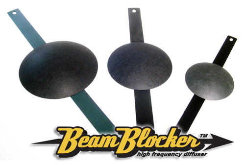

I guess most if the treble is being thrown forward. If you equalize it to sound good on axis, then it'll probably sound dull at 45 degrees. Maybe you could mount something directly in front of the cone to soak up some treble or scatter it around?
Its a standard Celestian guitar speaker , it is rebranded as a fender replacement speaker ....... It doesn"t have a covering over the speaker so I"ll try putting a speaker cover over it and see if it dulls down some of the trebble .....

Well I used a round piece of memory foam about 4 in across and mounted it on the grill in front of the center of the speaker and it helped quite a bit , It made the sweet spot larger but I still could not be directly in front of it without being blasted with trebble ..... I"ll try a bigger piece next ......

Putting something in front of the speaker is not such a good idea, firstly because it will lead to a lot of hard to predict interference problems. This translates into a ragged frequency response. Secondly, in effect you create a ring radiator, which has twice the directivity of a pistonic radiator. Hence, it is bound to exacerbate the beaming problem, rather than ameliorating it.
Therefore, the best solution would be to cross-over and use a smaller transducer for the high end, or a transducer with controlled directivity. Try a cheap horn crossed over at 1500-2000 Hz and your problem will be solved.

I doubt that the speaker would end up a perfect ring radiator, but I suspect the outcome to be preferable to a laser beam of deafening treble, with everyone off-axis struggling to hear the guitar cut through.

Truth is, many players like the sound of "beam blockers". They also like speakers mounted on the back of the baffle, and they miss the deep frame around the edge of the cabinet if you take it off. They like thick grille cloth and ports that leak midrange. They prefer 4x12s and 4x10s rather than a point source because of the interference patterns.
Technically, the problem with trying to fix the beam is you'll also mess up the off-axis response, and that's what most people in the room are listening to.
Remember, guitar speakers are not mic'd on axis. Unlike hifi speakers, if you sit on axis with a guitar speaker, you're not hearing the speaker at its best. I'm not sure I buy into the idea that since the on-axis beam of a guitar speaker sounds harsh and piercing, the secret to good tone is to spread that sound around the room. 😉
