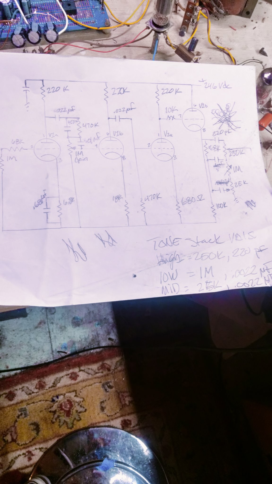

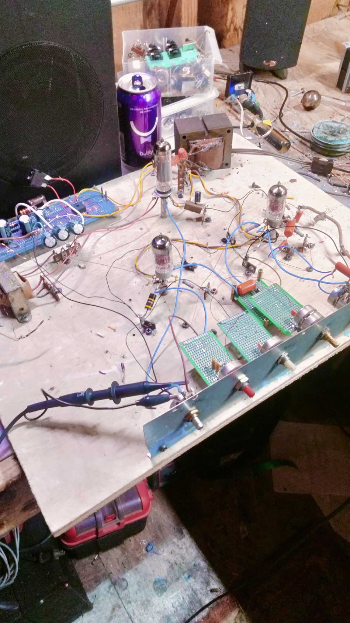

Amp signal fades to a distorted noise no sustain
Aloha,
Does anyone know why an amp would have no sustain and the notes just sort of fade into a distorted noise attached is a schematic some pics and video of the noise it makes.
Mahalo ,
Gomez 3
