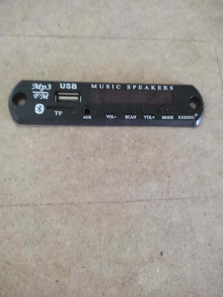

in fact not all bluetooth module have this power on annoying speech" the bluetooth device is ready to pair" ... my bluetooth module i used instead when turn on it will blinking when ready to pair and steady light when paired
Which one do you have? And can it use AptX HD?
this one ... it does have bluetooth function ... when turn on it will flash meaning ready for pairing and steady light when successful paired ...

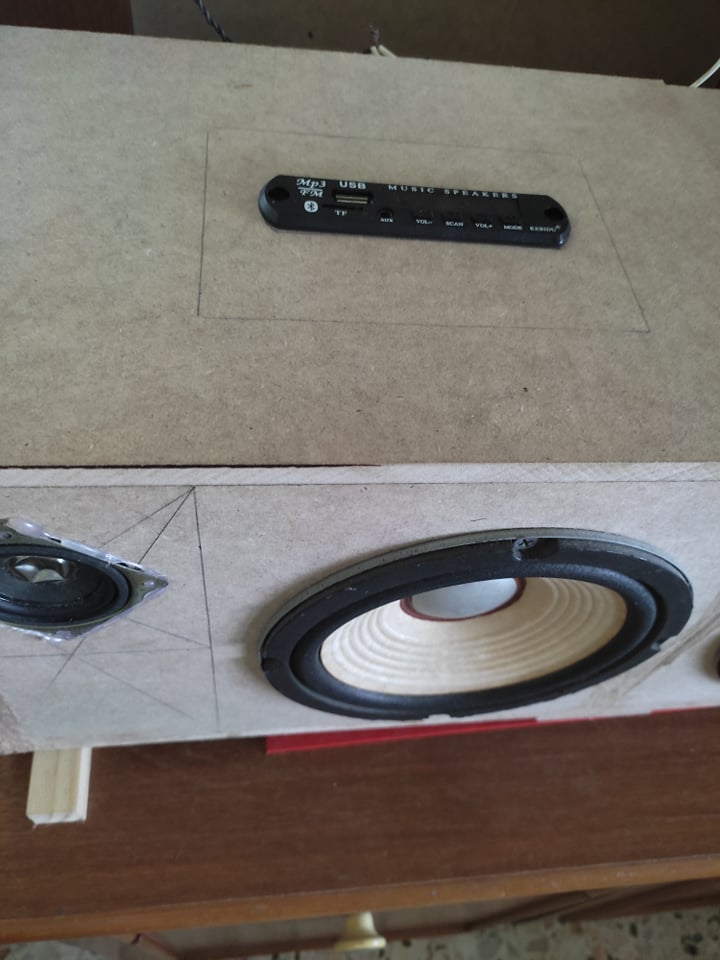

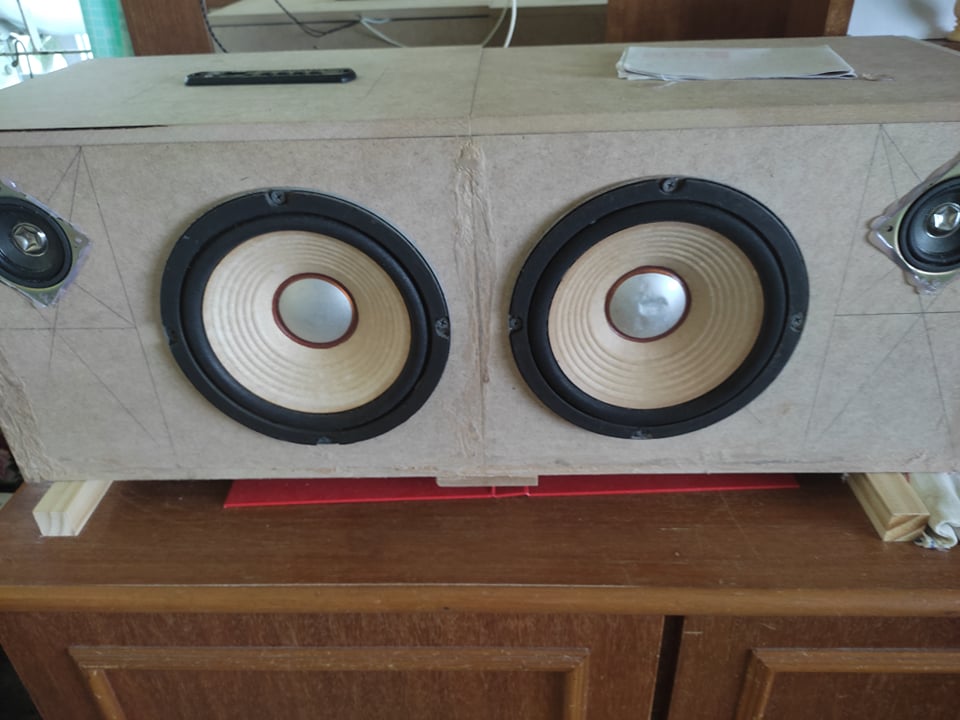

this is my diy boombox with a TPA 3116D2 inside ... unfortunately like many people did this module too suffer from loud turn on transient
So not an alternative then, unfortunately. Thank you for posting!
With a boom box I try not to put the controls and plugs on the top side because in sunlight you can't see the LEDs or display and dust, sand etc can easily fall into the plugs and it's really annoying to swap USB or a SD-card plugs (if possible at all).
