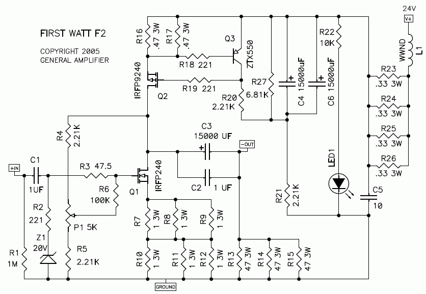

I would like to try building a new amp. The son of zen and related designs look very interesting, but since I've never built anything like it I haven't the slightest idea how to start messing with the schematics.
I've done a tube amp that I love and a chip amp that sucked. However, the chip amp required a pretty expensive power transformer that I would like to reuse if possible. It is 225VA, 2x24v. Does anybody have a design that would work well with this power?

If you want to build a design by Nelson then I don't see why the trafo you have can't be pressed into use. You can build a Class A amplifier with this trafo.
I'm not familiar enough with Nelson's amplifiers to suggest the 'best' one for you, but I would suggest that you choose one with an available pcb (again, not sure of what's available)
One option for a simple amplifier is Zen4, it recommends a 300VA trafo, but if you can accept a more limited headroom and lower bias current you could at least start with your 225VA.

225VA 2x24V will do ONE channel of F5 if you add a regulated power supply as per Zen Version 3.
Too much voltage and too little current for 2 channels I am afraid.

It has nothing to do with the DIY spirit. It has everything to do with basic math.
34V rails with an 8ohm speaker requires 4.5 Amps per channel. x 2 x 68v total = over 600 va

If it was a 600 VA transformer, I would suggest a regulator to lower the rails to 24V and build an F5. But 225 VA is really not enough, especially if you burn some off in the regulator. And Choke input would help, but spending $50 to use a $30 transformer seems a bit silly. On the other hand, we are silly types hereabouts!

With that transformer (2x24V, 225VA) two channels of F2 could be built with somewhat lower bias - one channel per secondary. Some regulation can be added to lower the voltage to +24V (CRC or active, F3 style).
It's simple, it's class A ...

That's if you're using split +/-34V rails.
How about ZV4 without a regulated supply? I think that
would get you to 10 watts.
