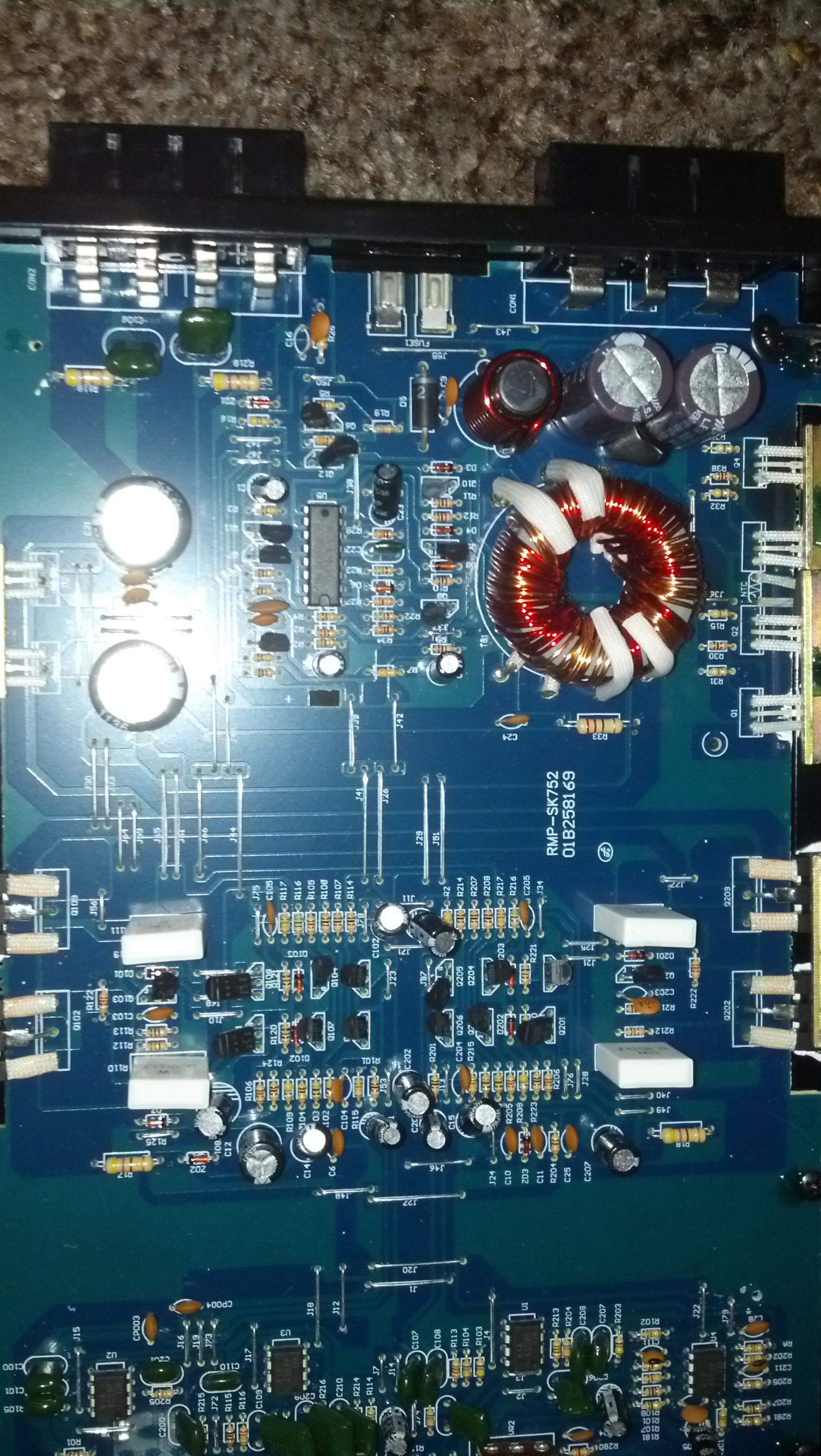

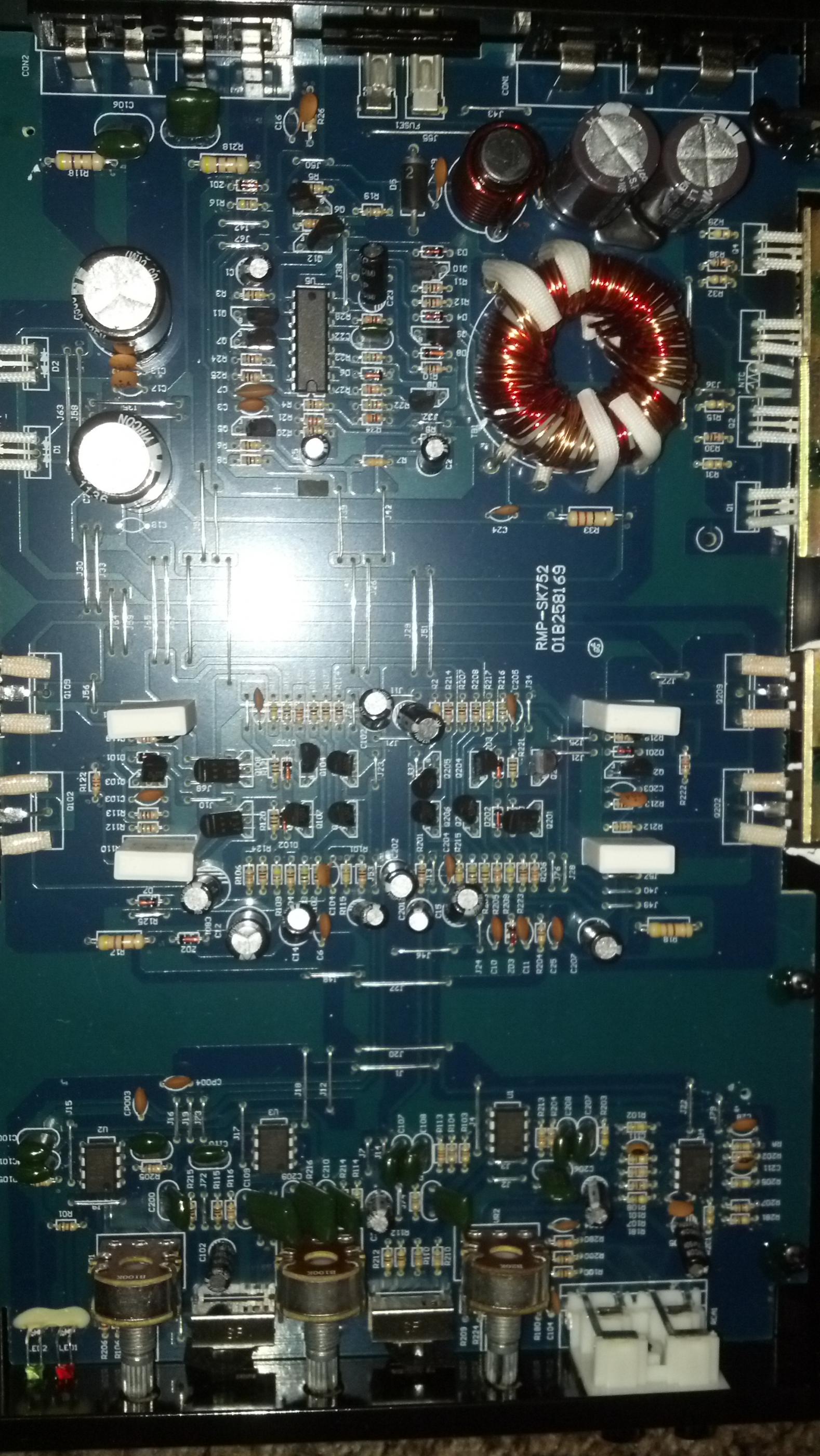

I just got a Konaki amp ko 3662. 1000watts. The only problem is it didn't have a fuse and it doesn't say on the amp what size it uses. If anybody has this same amp can they help me out. Please and thank you
A 35 amp fuse should be OK.
It appears that the board may be damaged. There is a black area under 2 of the power supply FETs. It could be that the trace is burned on the other side of the board.
