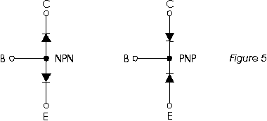

shallenn said:i dont really know how to test transisters
If you have a multimeter with a diode tester you have to measure a diode between the base and the emitter, and between the collector and the base (see pic.), if your multimeter detects a short circuit (beep) or your multimeter cannot detect a diode the transistor must be replaced.
It sounds like a bias problem to me, lots of distortion when playing at low levels and less distortion at higher levels, and the transistors not getting warm. Check the wiring and the parts of the bias circuit.
