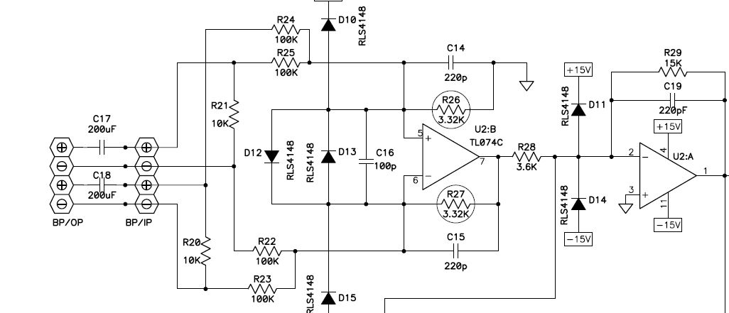

The LG 55UM7000PLC internal speakers are chip amp powered from the board, and my question is if this is a traditional amp - speaker setup, or if it is something else.
My reason for asking is that the TV lacks variable line out, or any analog audio output for that matter and I wanted to get a couple of rear surround channels out of it.
The way I want to accomplish this is by connecting the +left and +right from the internal speakers to the primary side of a 15kOhm 1:1 line transformer after having taken down the speaker level to line level using one 10kOhm resistor on each speaker level feed.
On the secondary side of the line transformer I choose one lead as ground and the other as signal and connect these to an external amp to get the rear surround, these will then only put out the difference between the two front channels.
The problem is that all I get is noise in the rear surround channel, so I suspect there is something going on with the internal amps output to the internal speakers, of which I get my line transformer inputs as described above.
Any ideas or thoughts on why this might be?

since I can't seem to get the +right and +left internal speaker feed to cancel each other out
Probably the amp chip works in BTL bridge mode.
With the TV off, measure if there is continuity (near 0 Ohm) with one of the wires & ground.
This was my suspicion, is this common for this type of application? Also would this mean that there is no common ground? That the output is "floating" as in not symmetrical balanced between the channels?, I don't have the possibility to meassure just now, but a common analogue amplifier also usually exhibits a very low output impedance, could be hard to tell.
If I get the possibility I will try to see what chips are powering the speakers, if these are easily identified and not baked into something else.
This is a stereo TV but it has no scart, and would converting the ARC as suggested being me a variable analogue out, my suspicion is that it would be fixed, as would my rear channels in that case.
Things sure where simpler in the old days when variable analogue outputs and conventional amp apologies rained supreme
Pretty standard these days with tiny chip based amps.
Check this input schematic from my JBL sub.
Note there is no common ground.

The internal amplifier can operate in class D (pulse) with a bridge circuit (no ground). There is no difference signal You need 2 transformers - one from each speaker. The speaker is involved in filtering impulses.

That tv, and a lot of them today, use an audio output chip that drives the internal speakers - which DOES NOT have a common ground as in older traditional sets.
So..... DO NOT assume or connects both speaker outputs together in any way!
You will fry the chip.
