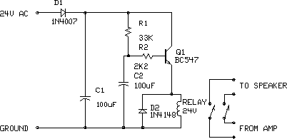

I would like to build a basic delay circuit to avoid turn-on thump on power amps. There's a circuit on the web that's on a few different electronics web pages that looks easy enough. Minimal parts. I have a couple of questions.
Does the BC547 need to be a certain grade for this circuit?
For example, grade BC547A,B or C? Coil current is (required current?) 16.7mA.
Also does the 1N4007 convert the 24VAC to 24VDC? The relay I chose is 24VDC. If using straight 24VDC, would it need the 1N4007 rectifier diode?

A circuit like that is designed for AC.
The 4007 diode naturally only conducts on half the AC cycle, adding some delay in charging the capacitors.
Using DC with it would shorten delay time, requiring an increase in C2/R1 to compensate.
A good delay time would be about 5 seconds before the relay kicks in.

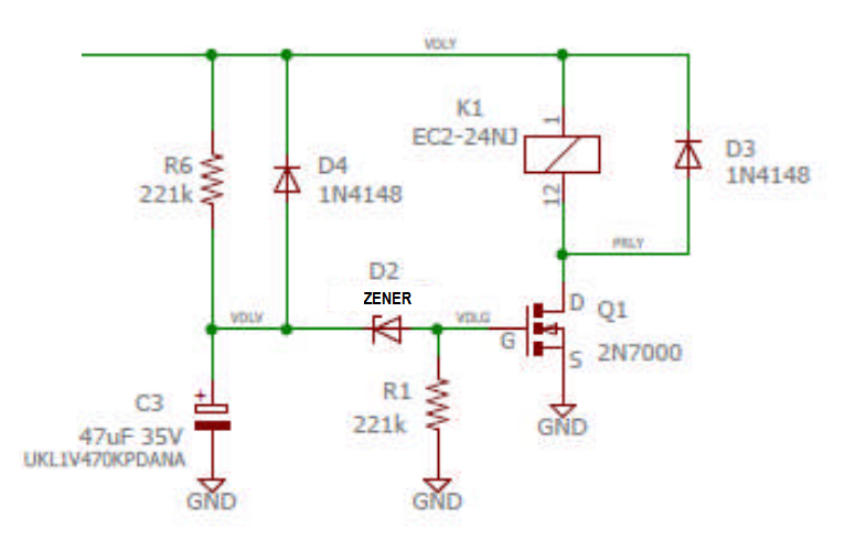

I personally don't like to drive relay coils using an emitter follower; I much prefer to drive them with a common-emitter switch. Or, as illustrated below (taken from the schematic of the Starving Student II page in the diyAudio Store), a common-source switch. The input at top left is a DC voltage, either derived from the PSU or from its very own half-wave rectifier as shown in post #1. Whichever is easiest.

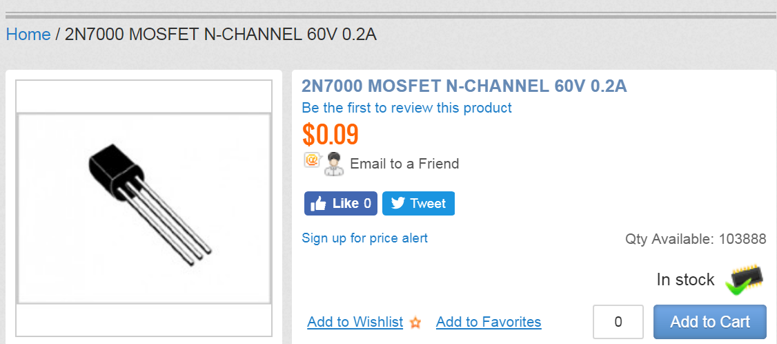

The 2N7000 is an inexpensive small signal MOSFET in the TO-92 package. Hobbyist sites like Tayda and Futurlec sell it very cheaply. And of course Mouser and DigiKey sell it too.

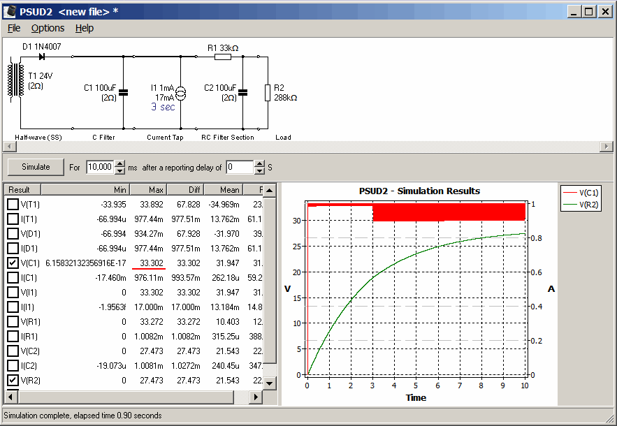

The half-wave doesn't add much delay. It comes to "full" on the first half-cycle going its way. Dozen milliSeconds?
Assuming 24vdc, are 35v caps enough?...
24V rectified to a cap tends to make 33.9V. Minus ripple, minus a part-volt for diode drop, but +plus+ transformer regulation (it may be 28VAC at this very light load).
Just assuming 24.0VAC, I get first cap voltage near 33V. Yes, I have put 35V on 35V caps and they lasted a long time; this is a poor bet. And transformer un-sag puts you nearer 39V. And we like to have 20%-50% de-rating on any cap which will be full-volted "ALL" the time, as this one may. The 35V part will last a while; get a 50V next time you order goodies.

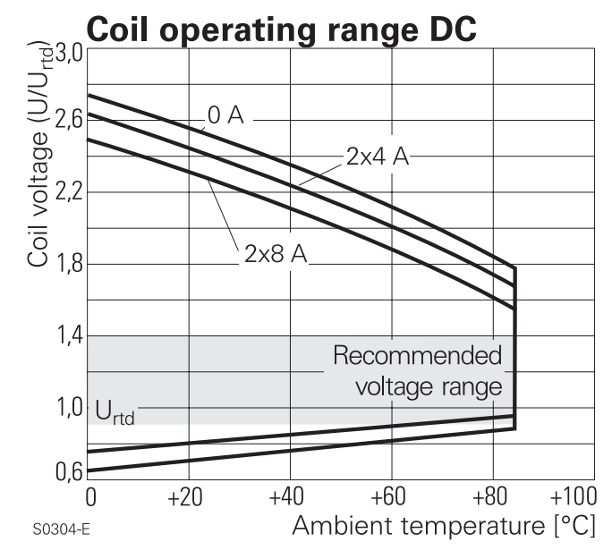

771974d1564673899-amp-output-delay-circuit-amplifier-output-delay-relay-gif
With transformer "un-sag" the circuit applies 37-38 volts across the relay coil. UNFORTUNATELY this is a relay coil rated for 24V DC. Ouch. That takes you well outside the shaded blue "Recommended Operating Range" from the TE Connectivity / Schrack datasheet.
Being good German engineers, the datasheet writers at Schrack denote voltage with "U" and decimal numbers with a comma. Their datasheet figure tells you: if you want to stay out of trouble, especially at high temperature, design your circuits to keep the relay coil voltage between (0.95 * 24V) and (1.4 * 24V). Therefore 37-38 volts is right out.
