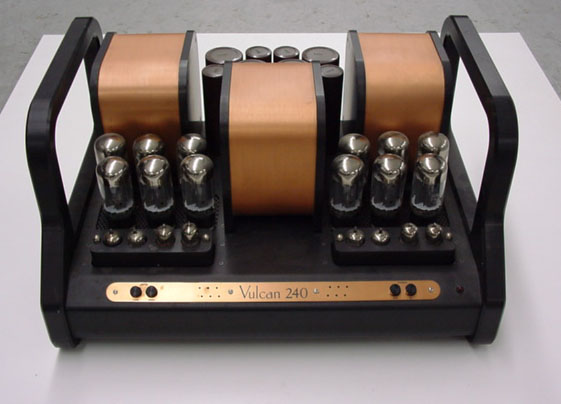

Does anyone know this amplifier? It is labelled "Vulcan 240", the manufacturer is "Unison Soundsmiths Corp." - which doesn't seem to be the well known Italian brand "Unison Research". Any information welcome!

Hello,
I see you have a Vulcan 240. The story behind this amp is this. It was designed in Canada by Franco Vila, a somewhat poor business man, but apparently a terrific designer. He even wound the transformers himself using a machine he built. He is no longer in the audio business, having sold the rights, spare parts and plans to a fellow by the name of Mark Schrauen (also in Canada). The amps are still being produced in made to order quantities. Your amp probably came via the Asian distributor Franco had early on.
I have personally repaired about a dozen of these amps. Every amp was slightly different in parts and construction. The owners of them, love them. It is a service tech's worst nightmare though.
One hint - use the best quality output tubes you can. The unit should auto bias them.
Please note, that the above mentioned people do not service or support these amps. I have some circuit details if your interested.
