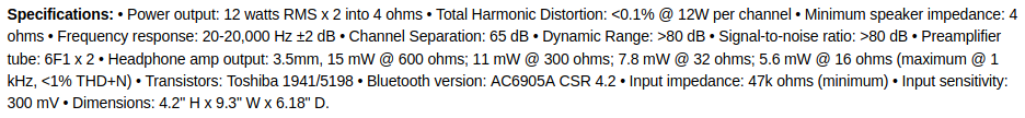

This may be wrong but I was reading something somewhere I can't remember where about an amplifier that may have claimed to be Class D with tubes but turned out to be a Class B amplifier with tubes and a pretty poor implementation to boot.
Somewhere on Audio Science Review?
From the specifications.. Transistors: Toshiba 1941/5198
2SA1941 | Bipolar Transistors | Toshiba Electronic Devices & Storage Corporation | Americas – United States
2SC5198 | Bipolar Transistors | Toshiba Electronic Devices & Storage Corporation | Asia-English
Plus the 12W per channel specification.
If it were really Class D with a tube preamp then you would expect a similar output power to the other unit you link to. Better to buy one of those but if your son has his heart set on glowy things there are some/many members here that would be able to pile in with some esoteric suggestions for add on valve preamplifiers that would plug into the aux input.
