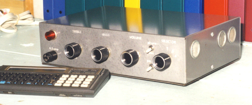

Depends on whether we listen to the program material, music, Etc or we listen for the artifacts, the problems. Or perhaps the amp is built to look at, complete with obscure parts to impress our friends. So today I went cross country skiing, right out the back door. Perhaps tomorrow will be the day to plug the soldering iron in again. And listen to my home brewed in 1968 completely integrated 3W amp. With its feedback pair 6AU6/6AQ5 amp driving a replacement auto speaker in a sealed box.😀 And no boutique parts. At all!😱
