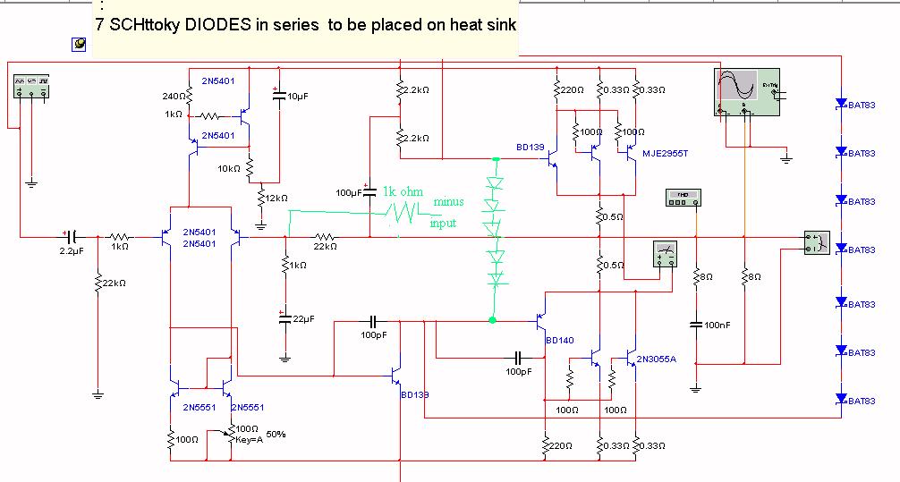

as u r nt angry on me I have few more question I know how to bridge two amps using two opamps using one one as a inverting and another as noninverting one but how do bridge two amps by keeping one amp at a unity gain what is the advantage of such a design and is the any sonic disadvantage on normal bridging ,,,,,,
I am posting my original design any changes needed to it plz specify

I am nt quit familiar with the type of bias setting ur recommending kindly help me understand is it in this manner that the diodes r supposed to sit on the main heat sink so that when the transistors heat up the conductivity of the diodes reduce and in turn they reduce the bias of the output transistors.....correct if iam wrong I have placed a ciruit kindly look at it and tell me is it done right or wrong .......& which schottky diode to use which one is most commonly avaiable ............
And bout using the 2nd amp at unity gain ........... how i am supposed to do it plz give a block diagram with the component values and tell me how does it work better than a normal bridge config,

Okay and my apology. With this circuit start with 3 1n series 1N5817 in series and then try 4 and then 5. Please recall I do not care for gain on the output stage and there it is 7. This will bias somewhere in this range. Bypass the string of diodes with a 100uF fast cap.
Also shown is an inverting input for the amp. Trim the gain under load to achieve unity inversion. Maybe use a 953 ohm resistor and a 100 ohm trim pot in series. Measure the output of each amp to ground when it is bridged and adjust gain of the inverter so the exact same voltage is produced by both amps. I use 3kHz sine wave at 20% power 8 ohm load for this test, stable oscillator and a 4.5 digit volt meter.
Hope this covers it-:vampire:
That is a gain of 2times. The amp would have to be stabilised for this gain and as a result will be different from the full gain amp.
You can add a divide by 2 resistor ladder to get the overall gain back to 1times.
Not a good way to do this.

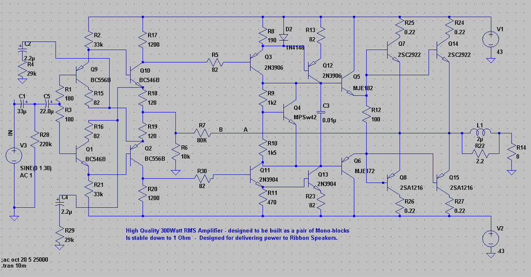

here's a variant to poke at
Hey guys -- criticise the hell outta my little offering 😉
Done in crappy old LTSpice -- unless anyone knows any other decent simulators out there I should try 😱
This amp (see pic) is being designed specifically for load condition - driving the ribbon speakers I intend to build at 8Ω nominal.
Ribbons have very little mass in their own right - though are expected to push a huge surface area of air - which pushes up the mechanical impedance. The amplifier will be presented a load that is the mecahnical surface impedance + resistance x the input transformers turn ratio squared.
I use the above as an example of course....because ...surely in order to properly define Sekhar's lovely little amp - load is a design consideration. If how the load works on the amplifier and it is understood how load is to be driven ...doesnt the PSU become a design parameter of prime importance?
