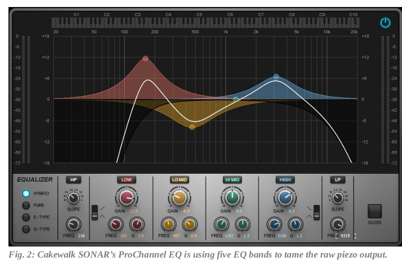

I thought so too, but then I found a very interesting article by Craig Anderton: Better Sound from Acoustic Guitar Piezo Pickups - Guitars - Harmony Central
I've attached the EQ curve Anderton used to make the onboard piezo preamp in a Gibson acoustic guitar sound more like a microphone placed in front of the same guitar. Note that the bass is rolled off heavily below 160 Hz, and the treble is rolled off heavily above 3 kHz!
So it appears the usual electric-guitar speaker may actually have all the bandwidth necessary for acoustic guitar. It definitely doesn't have the right EQ curve, though, so that will need to be fixed in the electronics. My guess is that this is exactly what's done in the Katana 50 and 100.
