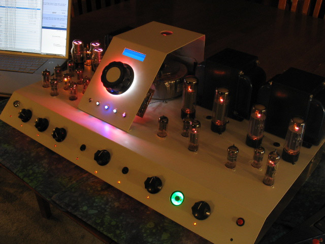

Eric, BHD,
I've attached a pic of my version of the Rozen SC150 amp. What I did was combine two monoblocks, the grounded-grid preamp, gas-regulated supply and an active 3 band EQ into one unit with microprocessor control, LCD display, motorized pots for remote (and Cadillac pearl paint!), etc.
If you want loud, this amp will deliver it! But, notice I'm not running the EL509/519s. Even though they're fairly inexpensive and readily available from ebay/russians, they have a tendency to crack (because of the basing and stress the modern production sockets place on the pins) AND flashover when the going gets tough. Trust me, I had to redo part of my output stage because of components literally catching fire when one of the 519s bit the dust (and early in its life). I must've gone through 5 tubes b/w of short-term (day or two it would appear) cracking and flashover
Both of these problems are not unheard of at all with the quality of these tubes these days. Because of that, I changed the outputs to EL34s, running the plates at absolute max ratings, and screen voltage of 400 (IIRC). All together it sounds great, but Bruce's designs have a tendency to be very clarical, more of a solid state, detailed sound. A different preamp would probably make a difference in this regard.
I love the fact that there is absolutely no hum whatsoever, even with your ear to the speaker. You'd be hard-pressed to know it's on. My PP 6L6 has that great tubey sound, but the idle hum drives me nuts.
Overall, the most expensive part of the monoblocks are the Hammond 150w transformers. Mine are actually vintage off of ebay (new are $$). You wouldn't necessarily have to run these if you went with different output tubes like I did (converted I should say). Go nuts, use 4 per stage in parallel push-pull and have SS power with the tube advantage!

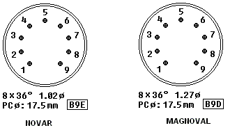

Nope...
Because of many people just use the wrong type of socket (not saying you did):
Magnoval and Neonoval (AKA Novar) are not the same socket even if they do look suspiciously similar.
The EL509/519 requires a Magnoval type of socket, when force pushed into a Neonoval one the glass base CAN crack.
Flashovers? Hmmm...Never seen any with those tubes, these are about as tough as a boot AFAIK.
