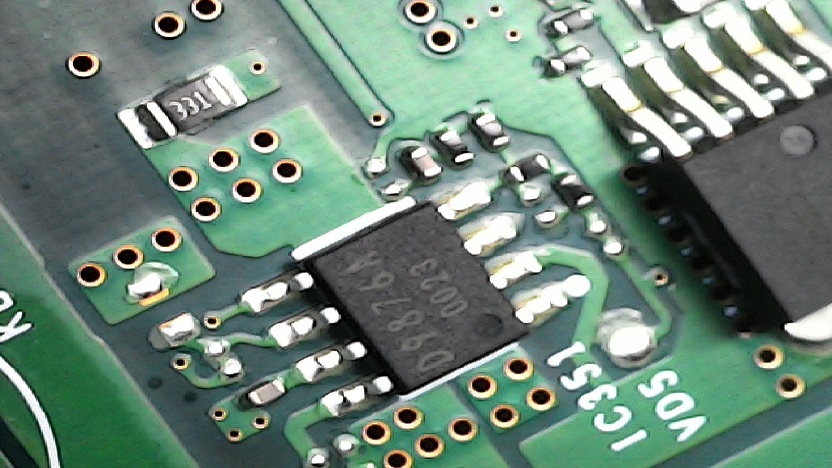

Hi everyone, I'm posting this in hopes that someone has experiance with repairing head units.
I've had this head unit for some time but just last week it started to show this error after being powered up for only about a minute. With nothing else connected but positive and negative for power. I'm assuming with it saying "AMP Error" then it might have something to do with the internal amplifier. Is there someone that might be able to shine some light on this problem and make some recommendations. Thank you in advance.
For some of these ICs, the through-holes are VERY tight and even with ChipQuik, they can be difficult to remove without damaging the board. If yours are that way, cut the leads off at the body of the IC and remove the individual leads one at a time. I use a razor knife to cut them but a fine-tipped pair of nippy cutters will also work.
that worked out great. Replaced the IC and the error is gone. Head unit functions top notch again. My brother told me he didn't want it anymore and told me to throw it away when he took it out of his truck. I decided to see if I could fix it. $27 for a part and a little troubleshooting and I have a $300 Pioneer MVH-1400NEX. I call that a WIN!! Thanks for the help! Just wish my amp was so easy to fix!!!
