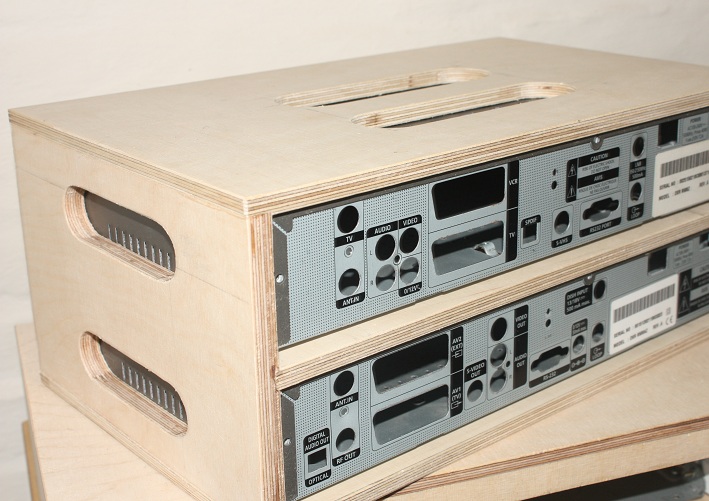

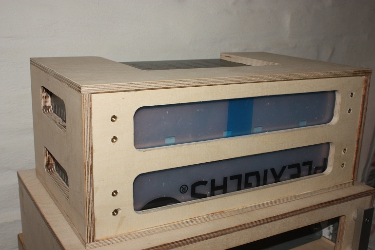

there could be many ways around this, but the cost effective is probably to use a Modushop Pesante box
modushop.biz
me..? I would also use plywood
but man, that Orange design is ugly...sorry
but I guess ugly is a way to be noticed too 😀
modushop.biz
