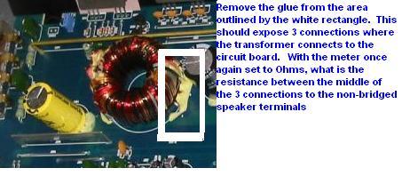

Disconnect every speaker wire from the amplifier. Dixconnect the RCA cable also. With an ohm meter set to the Ohm selection, what is the resistance from the 2 non bridge speaker wires to first the shield of the RCA jacks? And then from non bridge speaker terminals to actual ground of the amp.
Also can you remove the bottom cover of the amp so we can check one other thing?

See the picture

Disconnect every speaker wire from the amplifier. Dixconnect the RCA cable also. With an ohm meter set to the Ohm selection, what is the resistance from the 2 non bridge speaker wires to first the shield of the RCA jacks? And then from non bridge speaker terminals to actual ground of the amp. Also can you remove the bottom cover of the amp so we can check one other thing?
I don't have access to my multimeter right now, but I'll try it later on.
