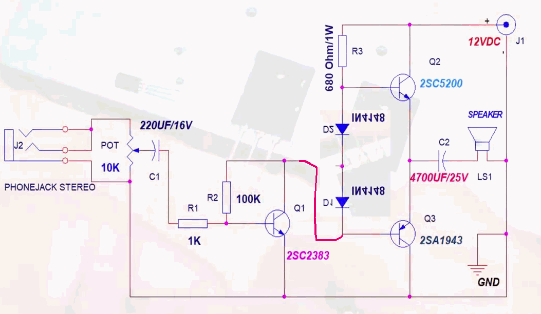

What i mean is there anything that can be done to my amp to get it working.
Yes, correct the bad design into a working one.
Please, not alternative designs.
You want to keep it as is?
But it does not work that way.
It is a cheap and cheerful project with a bass disortion problem,
No, it´s a poorly biased (the understatement of the Century) half braindead project, which must be MODIFIED to work.
It could put out up to 2W RMS if corrected but as is it can only put out some 20 to 50 mW and quite distorted.
You can "acceptably" hear it on high mids but as soon as you want to push some Bass through it it fails miserably, because Bass needs real power (even if 1 or 2 W).
not intrested in negative feedback
So you are not interested in undistorted sound.
Fine with me, but then why complain about distortion in the first place?:confused:
or trying to make it a high quality amplifier.
We are suggesting how to make it a working amplifier.
Nobody talked about high quality.
Just want it be stable and make sound.
Ok,then follow instructions instead of rejecting them.
You can EASILY turn your project into a working one, using 90% of what you already have.
Such as OldDIY´s schematic on posts #4 and #7.
Use the transistors you already have, leave them mounted on heatsinks, but correct the wrong circuit.
You´ll only need to buy a couple cheap resistors, maybe a capacitor or two.
Cheap and easy.
can you please answer the questions i put up as well to make life easier for me
We are answering from day 1 but you reject advice.
I´m not even tring to make you learn Electronics, go figure, just to turn your non working project into a working one.
And no, putting out 20 to 50 milli Watts from a project capable of 2 full watts does not qualify as "working".
I have read the tutorials and am not trying to be difficult, i just want to know why lowering the value of R3 from 680 ohms down to 100 ohms is better. There is nothing in the links provided to explain this.
If you can answer this i will end the thread, and thank you for your time.
BJT is a current amplifier.
The current through the output transistors is determined by the current in the load (speaker). To get it, you need to supply enough current to the base of the transistors. It is provided by the first stage - a transistor and a resistor. The current through an open transistor is determined by its gain and input signal. The current through the resistor is limited, but must be sufficient for the output transistor to operate. Less resistor resistance means more current and vice versa.
