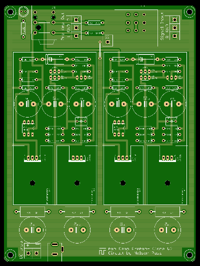

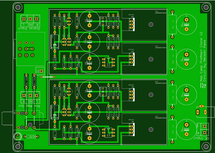

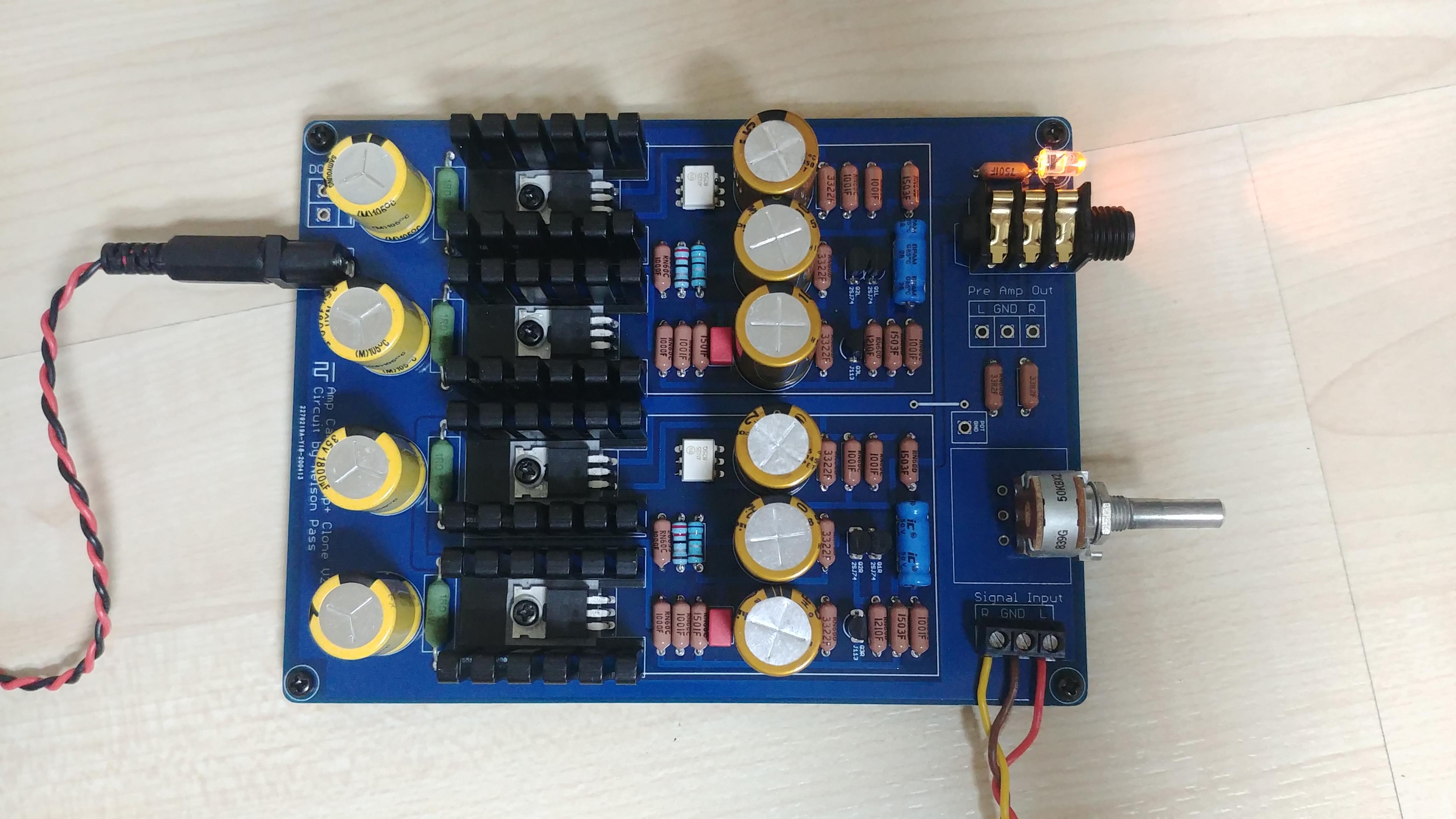

Gerber for my proto board.
I have fixed error in my PCB, sharing gerber for those who are interested in.
BOM differences :
C1 : 106BPA050M
C2 : 16mm dia, 7.5mm LS
C3 : 16mm dia, 7.5mm LS
C4 : 16mm dia, 7.5mm LS
Power filter caps : 13mm dia, 5mm LS
Case : 1455Q1601
Smaller pot (RK16 or DACT) can be used.
All other compoments are same as original.
BOM differences :
C1 : 106BPA050M
Case : 1455Q1601

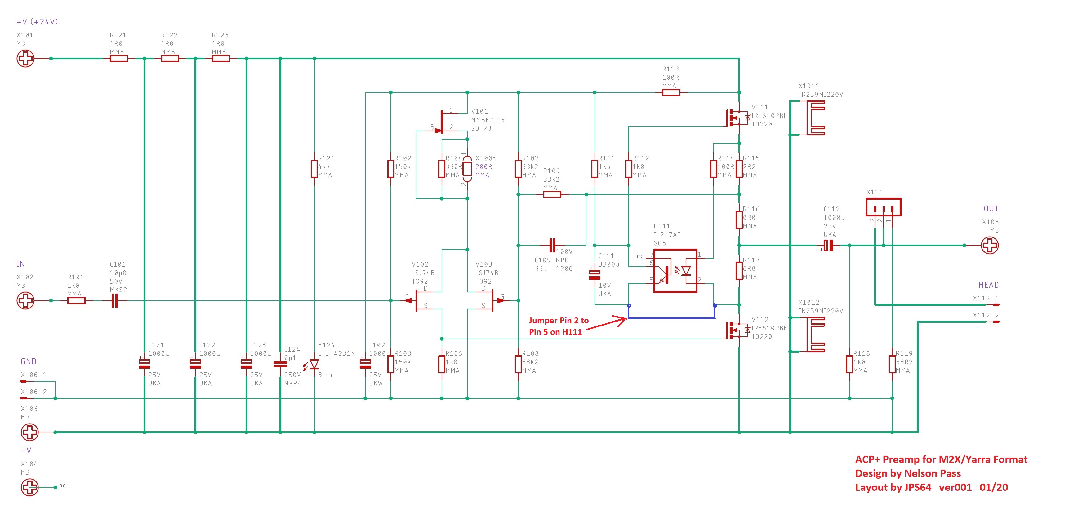

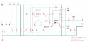

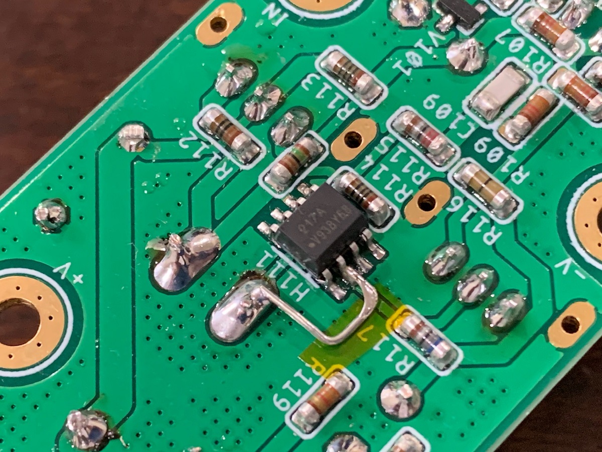

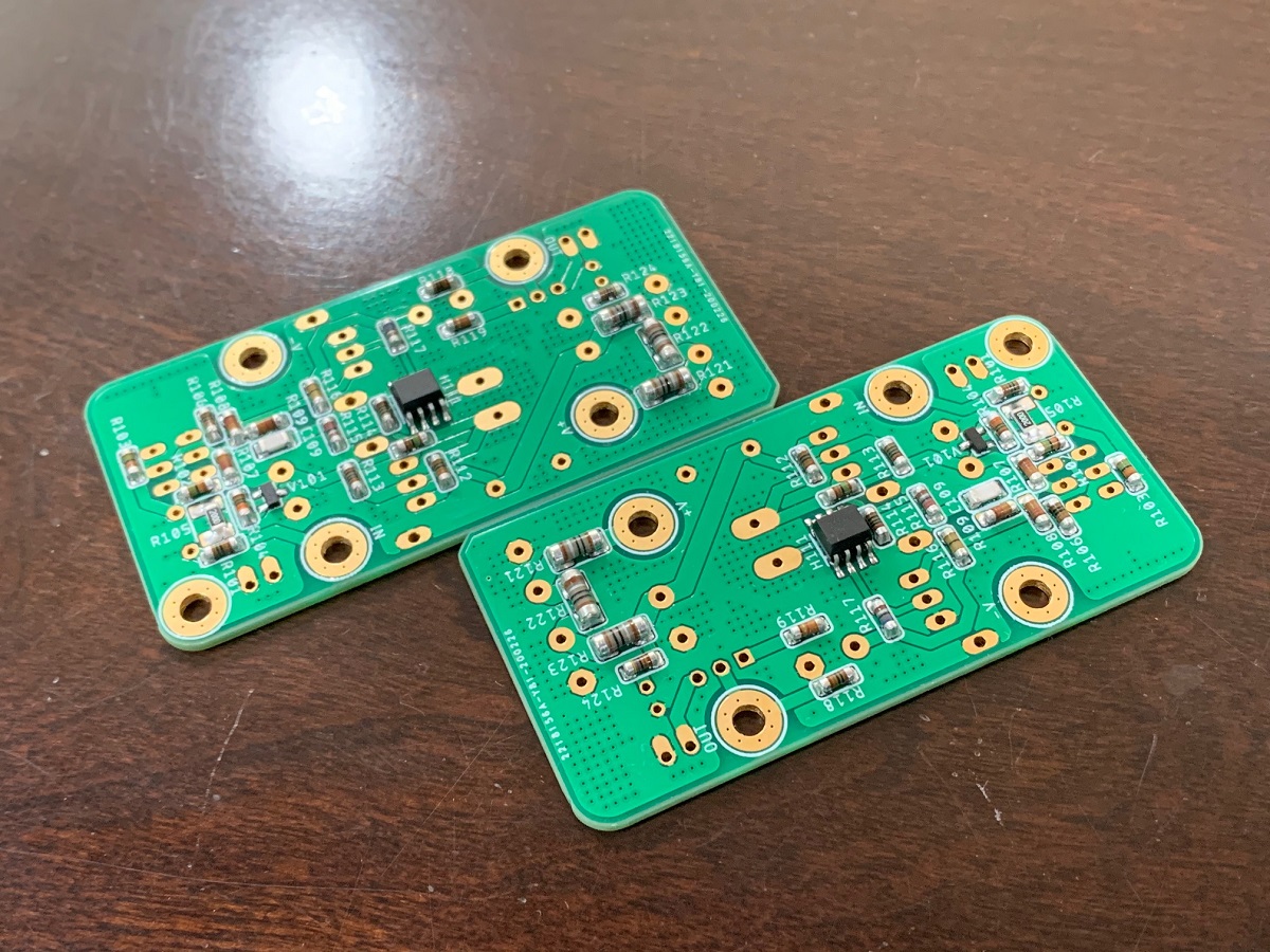

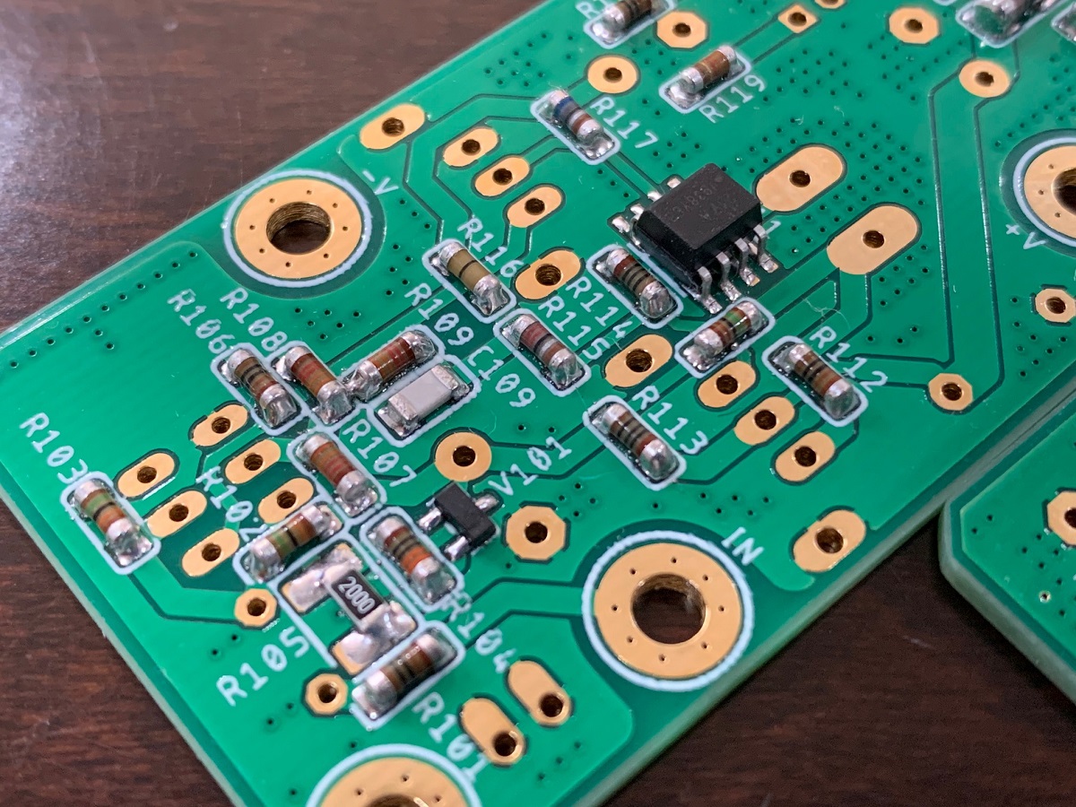

I just completed the verification build on JPS64's PCBs. The SMT side with MELF MMA and MMB resistors was actually fun to make. Definitely use solder paste and a hot plate. The parts per the schematic/BOM work well. There is an error on this prototype schematic and layout that was not caught before we made the PCBs as shown in the schematic. However it was an easy fix to jumper pin 2 to pin 5 on the optoisolator. The production PCBs will have this error fixed. The preamp/HPA sounds great! Listening to it now on my 55ohm OB-1's and they really have a nice powerful dynamic feel and great soundstage. Super quiet - no background noise or hiss/hum. Very nice sounding headphone amp.

Schematic with Error Fixed:
SMT parts populated:
Closeup after cleaning:
Detail of jumper from Pin 2 to Pin 5 (connected to -ve of C111 cap which is same as pin 5):

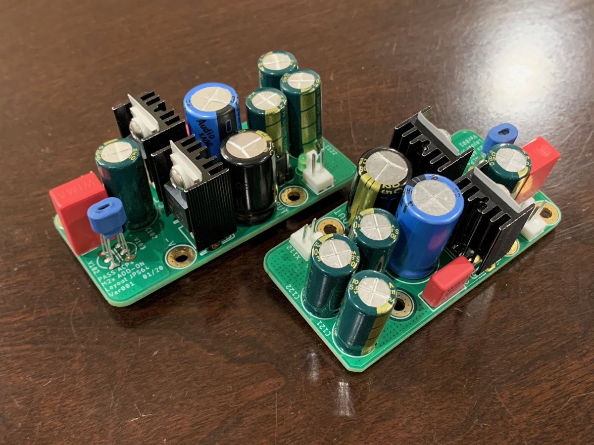

Topside through-hole components completed:

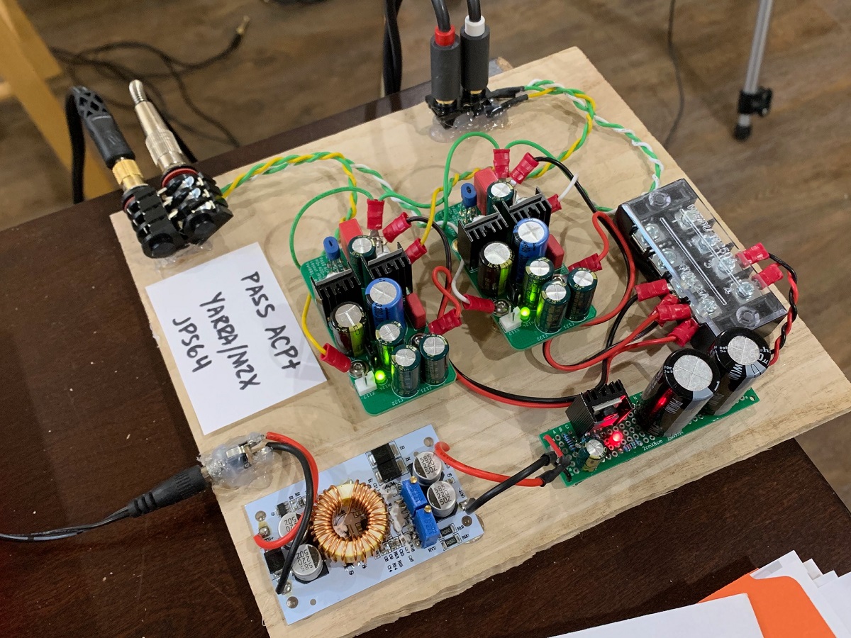

Amp on a plank test fixture with DC-DC SMPS supply and MOSFET cap multiplier for slow ramp up and ripple reduction with 24.0v DC output (measured at amp MOSFET drain):

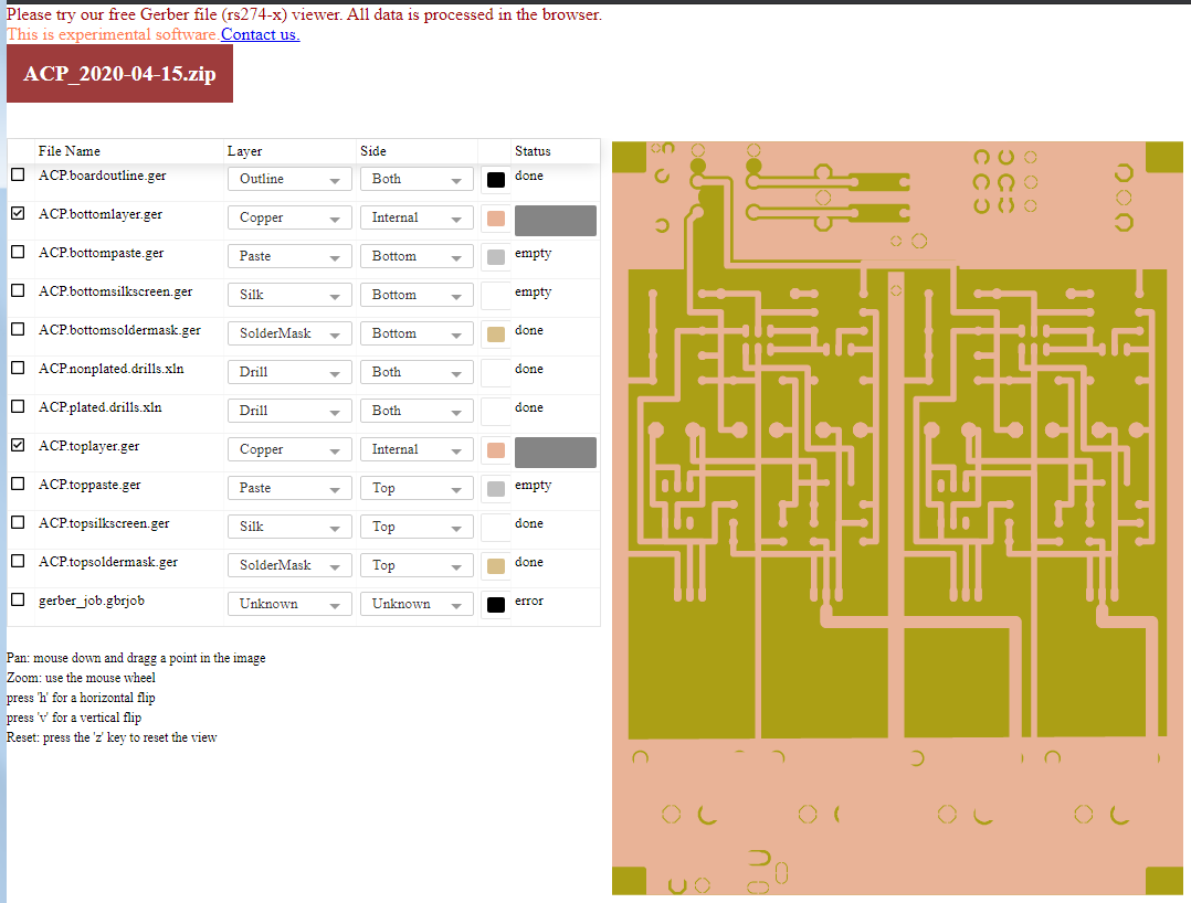

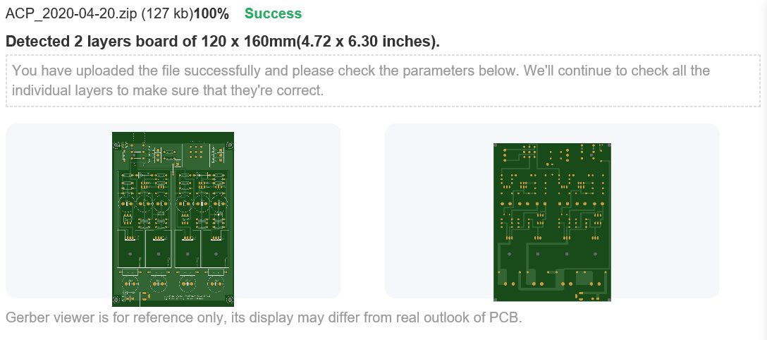

Thanks for posting the Gerber files but when I upload your Gerber files on the pcbway site I get an error like:
Failed reason:
file cannot opened. gerber/.pcb/.pcbdoc./cam formats are supported(we need gerber file in fomat of RS-274x;
The .zip archive of Gerbers in post #303, reads just fine in the free online Gerber viewer at http://www.pcbxprt.com
_
_
Thanks Mark, it works fine on the jlpcb.com site but not on the pcbway.com. Anyway your online Gerber viewer site is good 🙂
Rgds
Rgds
Rgds
I will try to generate gerber once again and check with pcbway! Apology for inconvenience.
Thanks withmatt, it worked with jlpcb and also the online Gerber viewer so no issues. Seems to be some odd file naming or some other issues on pcbway site. Appreciated 🙂
Yes please.
Drills also attached.Thank you!

I have been listening to this preamp for past couple of days and still really enjoying it. I finally flipped it upside down in order to measure the bias current across R115 and R117 and got 141mA. That's a pretty healthy Class A bias current. It would explain the 76C temp on the little heatsinks that I have.
