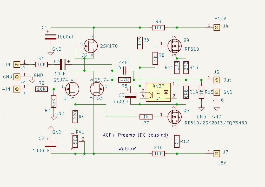

I've just got myself one of these and before I get too carried away I have a couple of questions.
1) Can I simply remove & bypass C1?
2) R2 and R3, do they absolutely need to be 150K, is there any wriggle room? Ie I've already got lots of 100K and greater values etc, etc.
Thanks 🙂

1) As this uses a single supply and not a bipolar, removing C1 would connect your sources to approx 12VDC. If you like your source electronics, I’d strongly suggest you don’t try It.
2) 100K would work fine. If you have lots of various larger values perhaps you could parallel resistors and get something closer to 150K, though it’s not particularly critical
Do you want low frequency performance at all? 0.22uF will have a cutoff frequency of ~60Hz. (And phase will start to get topsy-turvy much higher than 60) For full range performance, you’ll need to target a cutoff of around 5Hz or less, to insure that you have good phase margin in the lower frequencies.
However, reducing R2 R3 will require a larger cap, not smaller.
Assuming you can get close to 150K for those positions, 1uF will roll off at 13Hz, 2.2uF 5.5Hz, 3.3uF about 4Hz.

No. That cap is 1000uF for a reason... the headphone resistance can be as low as 25 or 32 ohms, not hundreds of K.Assuming same applies to C3?
This means I'll need to think of something.
I'm just not going to accept a 1000uF Silmic 2 as my output coupling cap. I could delete the headphone section (I'll never use it), or just box it up and move it on.

My ACP+ has been built with 1000uF Elna Silmic 2's. I've a strong allergy to Silmic II's, can't listen to them. Have now swapped them for some normal Elna caps.I don't understand what you mean by this. Can you explain?
The headphone section IS the circuit. You can’t delete it.
I meant remove the headphone jack and switch, not the circuit
Now we are talking! Thanks @WalterW 🙂
Guessing that in the above schematic the input cap is just there in case a power rail were to drop out (ie c3 could be removed).

But can you use the PCB as sold here?Maybe you should try to build it with a dual PSU. No need for the input and output capacitors. See pic.
Can you provide some guidance what needs to be changed to achieve that?
