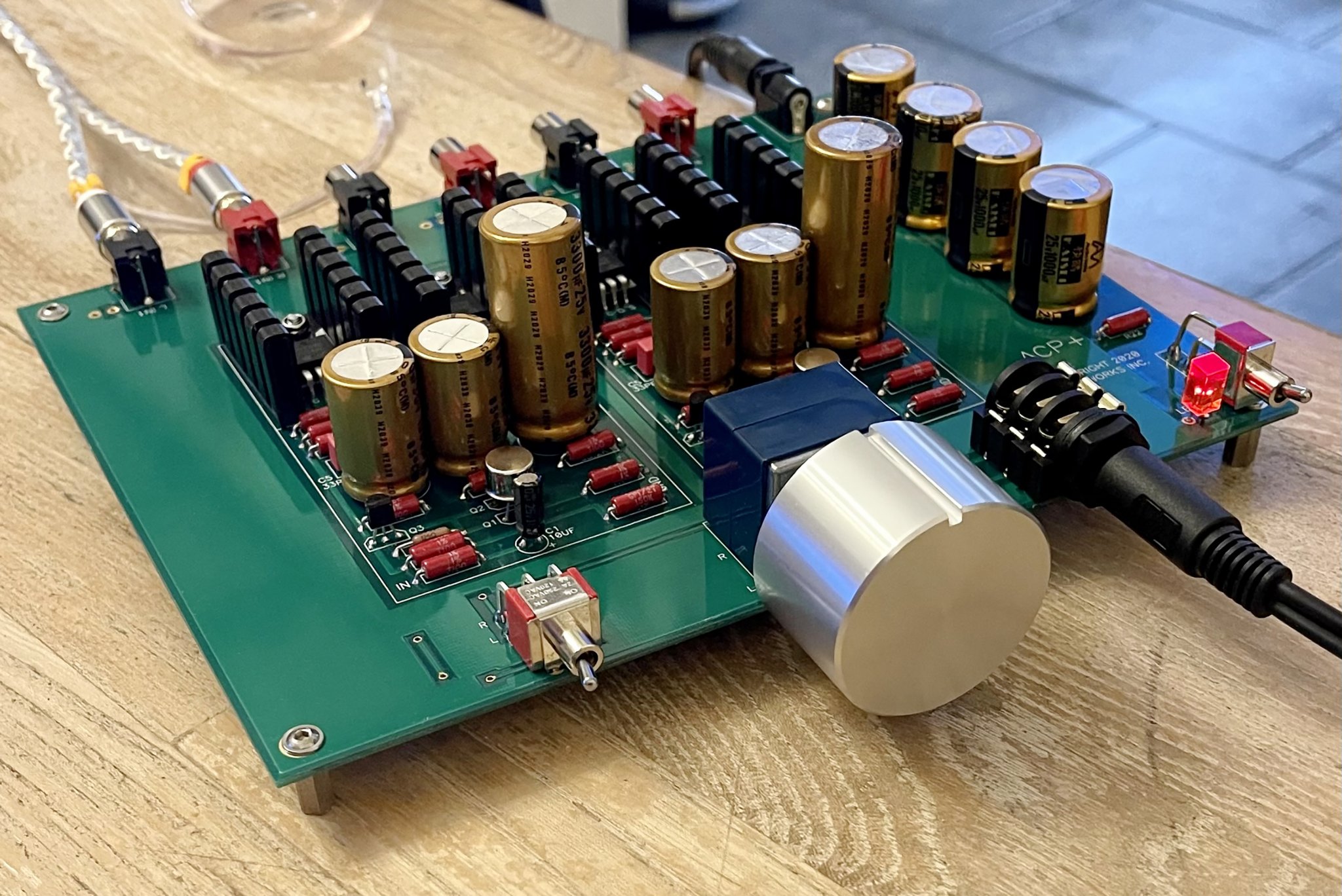

I built the ACP+ from the kit, and I’m really happy to say that it works on the first try.
I had huge problems with the ACA, but it seems I learned from my mistakes there.
(I was using way too much soldering paste there and I didn’t clean it off…)
Just some funny things about the kit.
I think there were a bunch of resistors that were missing, while there were a set of capacitors that I did not end up using. I could not find any 125Ohm resistors so I replaced them with 120Ohm (would 130ohm have been better in this circuit?)
also the resistors I had at hand were 5% instead of 1%, so the values were a bit biased on the lower end of the scale though they did not spread very much.
Anyway it works and I will let it burn in, and then give it a proper test.
I’m really happy that it works on the first try!
Hmmm… After checking, I realize those extra “capacitors” were in fact the missing resistors.
I will replace the resistors I added. I’m guessing the do make a difference…
I removed the 5% resistors I added and added the high precision resistors that came with the kit.
This is what it looks like. For any other noobs needing a reference.
