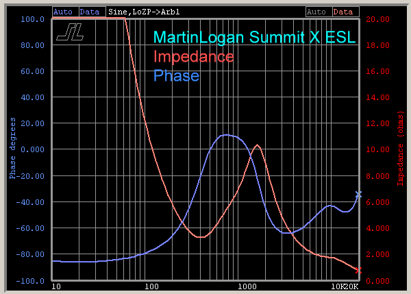

The speakers impedance curve looks like this:
The impedance goes down to 2 Ohm above 6kHz and touches on maybe 0.7 Ohms at 20kHz.

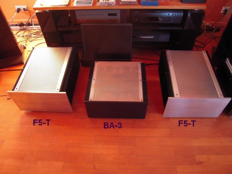

I have a slight tendency to recommend the BA-3 over the F5T V3. Both amps sound great.
I prefer the BA-3 in the bass-region over the F5T V3. But this doesn't come into account because of the
implemented bass-amp in your ML Summits.
My experience with my F5T V3-monoblocks is, that they sound very analytic and clear (although this is slightly adjustable on the frontendboards). This can be a tad too much with a very analytic sounding ESL.
My Audiostatic ES300R sound very good driven from my F5T V3-monoblocks. They sound also very good
driven by the BA-3-amp. Although my preferred combination is F5T V3-monoblocks driving the ESLs,
BA-3 driving the subwoofer (crossoverfrequency at 80 hz).
And I agree with the statement of ZenMod, that the BA-3 seems easier to build. Both amps need some patience for the biasing-procedure.
