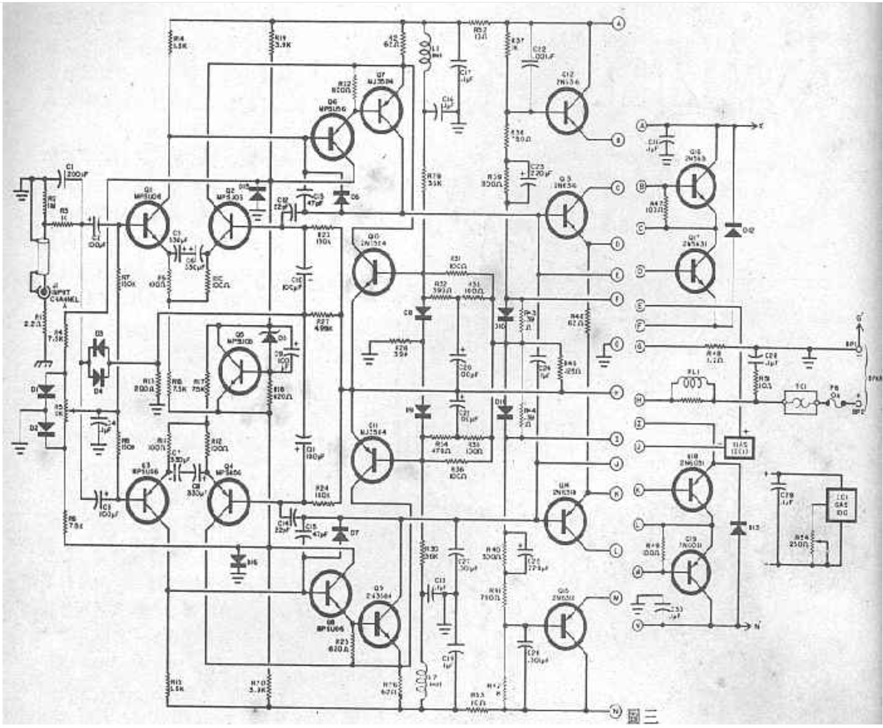

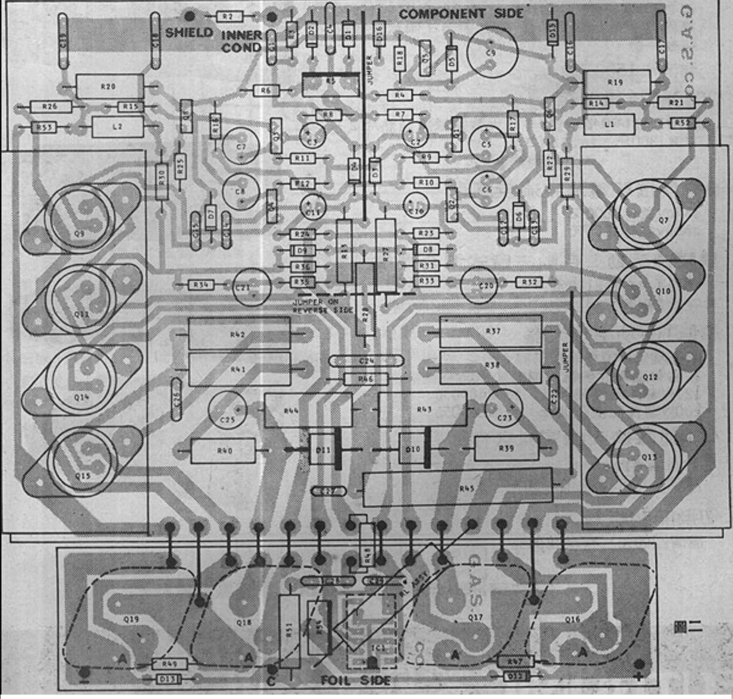

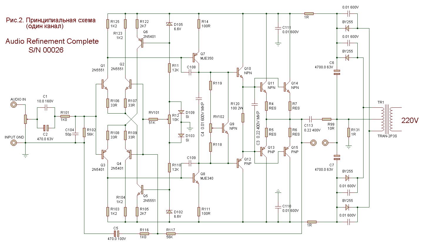

According to the amp circuit, if the original PCB condition is good, you can modify the amp to a modern amp as the last circuit by replacing all the new modern transistors and parts. You can use two pairs MJ15024/Mj15025 (250W Ic 16A each) high output power trnsistors.
I always mod the old amp with new parts and new circuit with the same old PCB. It will save time in design new PCB and the difficulty in heatsink and chassis mod works.

Thanks patrick - clearly you're familiar with the original Ampzilla circuit. Board is in pretty good shape other than showing its age. So I think you're suggesting that I modify the PCB per the new schematic on the right? An interesting idea. Is that something you have successfully done? Guess I'd need to see how many cuts/jumpers would be needed.
I have a few old amps, I will check their circuit and try to MOD them to improve their performance. Some good circuit amp just simple recap, replace modern parts like diodes,transistors,op-amp etc. Other simple designed amp I will rebuilt part of the circuit or even the whole amp circuit.
To do the mod, first step I will check the amp circuit and the PCB layout to make sure it has the potential to mod and fit the new circuit components, so that I've checked your amp circuit and the PCB layout and confirmed it can mod to the new schematic on the right.
If you like to mod the amp, I can help to study the PCB and make the mod changes like the cuts/jumpers would be needed, so that you can finish the mod in quick steps.
Each channel two pairs MJ15024/15025 (250V/16A/250W) working at +/- 69V DC is quite good enough for an amp, especially this amp has active fan cooling.

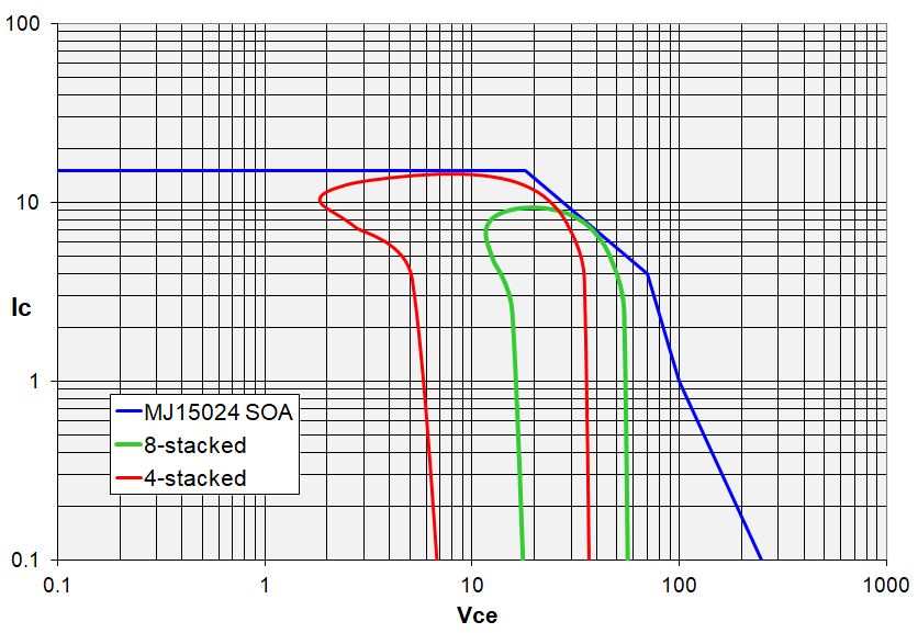

Yes, you are right - my diode bridge has also failed causing some bad readings. 80V it is. I did some quick calcs and it looks like with an 80V supply and an 8-ohm resistive load, I'd hit SOA with stacked MJ15024/MJ15025 around 100W, and at an even lower power level with paralleled devices. This is disappointing, but I guess not that surprising based on how many device pairs people use these days. It does make me question whether it is worth re-building.

I don't believe SOA, which covers secondary breakdown, was "invented" until the late 70's, sometime after JB's Ampzilla design. I thought the calculation would be simple, but it is taking more research than I expected. I think the biggest issue is how reactive the speaker load can get. I've been looking at an article by Rod Elliot (SOA), and his standard procedure is to assume a 4-ohm speaker can go as low as 3-ohm with 45deg phase angle. That load does not look so good with Ampzilla, either stacked or paralleled, but consistently the stacked arrangement performs better. I just built a subwoofer and need to review it's impedance as that is likely the first speaker Ampzilla would drive. I think if I can convince myself I can re-build it into something reasonable powerful and reliable, I'll do it.
Found a relatively simple spreadsheet to determine SOA compliance - see "SOA Spreadsheet". Had to rewrite the equations to allow for stacked devices since it was written for parallel. Per Rod Elliot's suggestion, I used 6-ohm / 45deg for an 8-ohm load and 3-ohm / 45deg for a 4 ohm load, with +/- 80V supply and MJ15024 SOA. Pic below shows curves at 260W / 8-ohms and 310W / 4-ohm - right at the SOA limit. Paralleled devices performed more poorly. The analysis of course assumes perfect splitting of voltage between devices, so is best case, but overall I'm pleased that it looks as good as it does. We know the design is a bit weak, but maybe resurrecting the amp is warranted.

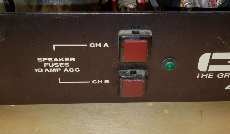

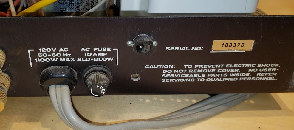

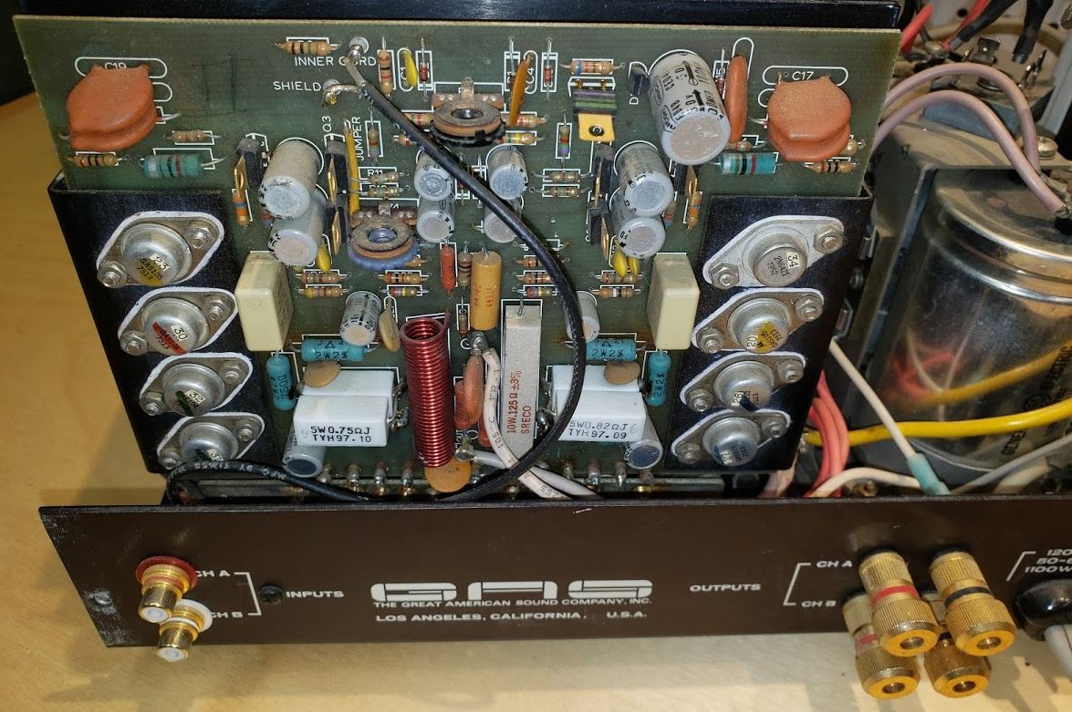

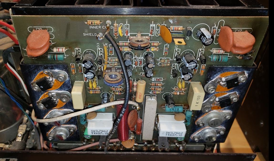

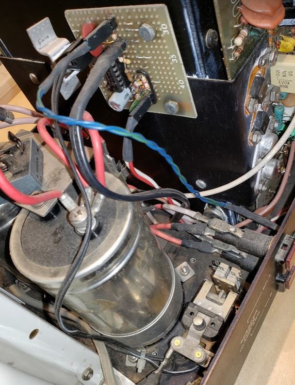

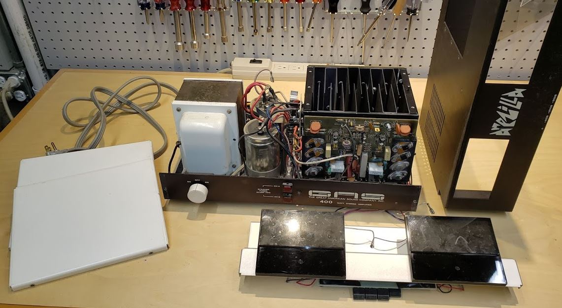

Thought I'd post a few pictures of the Ampzilla under question. First pic is all the pieces setting on my workbench, mechanics in mostly good shape - just a few scratches. 2nd pic shows added fan control bd on the side of the heat sink and remote turn-on relay at bottom of chassis. 3rd pic shows Ch-A amp bd, and 4th pic shows Ch-B amp bd (still with all its TO66's), as well as replaced speaker and RCA connectors. 5th pic shows replaced speaker fuse holders - one of the originals broke so I replaced both. You can also see the added green LED which comes on when the fan is active. 6th pic shows serial number - you can also see the added input connector for the relay. Just noticed the warning - DO NOT REMOVE COVERS - NO USER SERVICEABLE PARTS INSIDE!!! 🙂

I see your main problem, your workbench is far too clean! 😉
Craig
I spent the entire morning cleaning it off so I could take the pics and not embarrass myself! I'm actually more of a hobbyist woodworker, but spent 40 years as a EE development engineer for public safety communications equipment, so also enjoy electronics. Been retired about 5 years.
