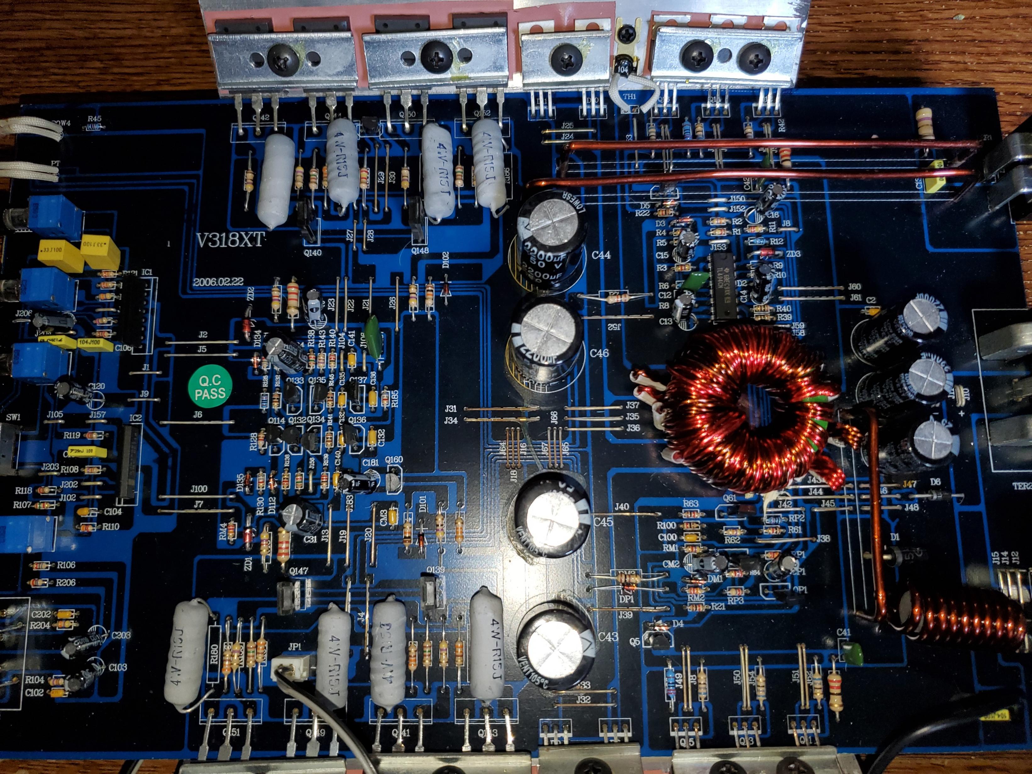

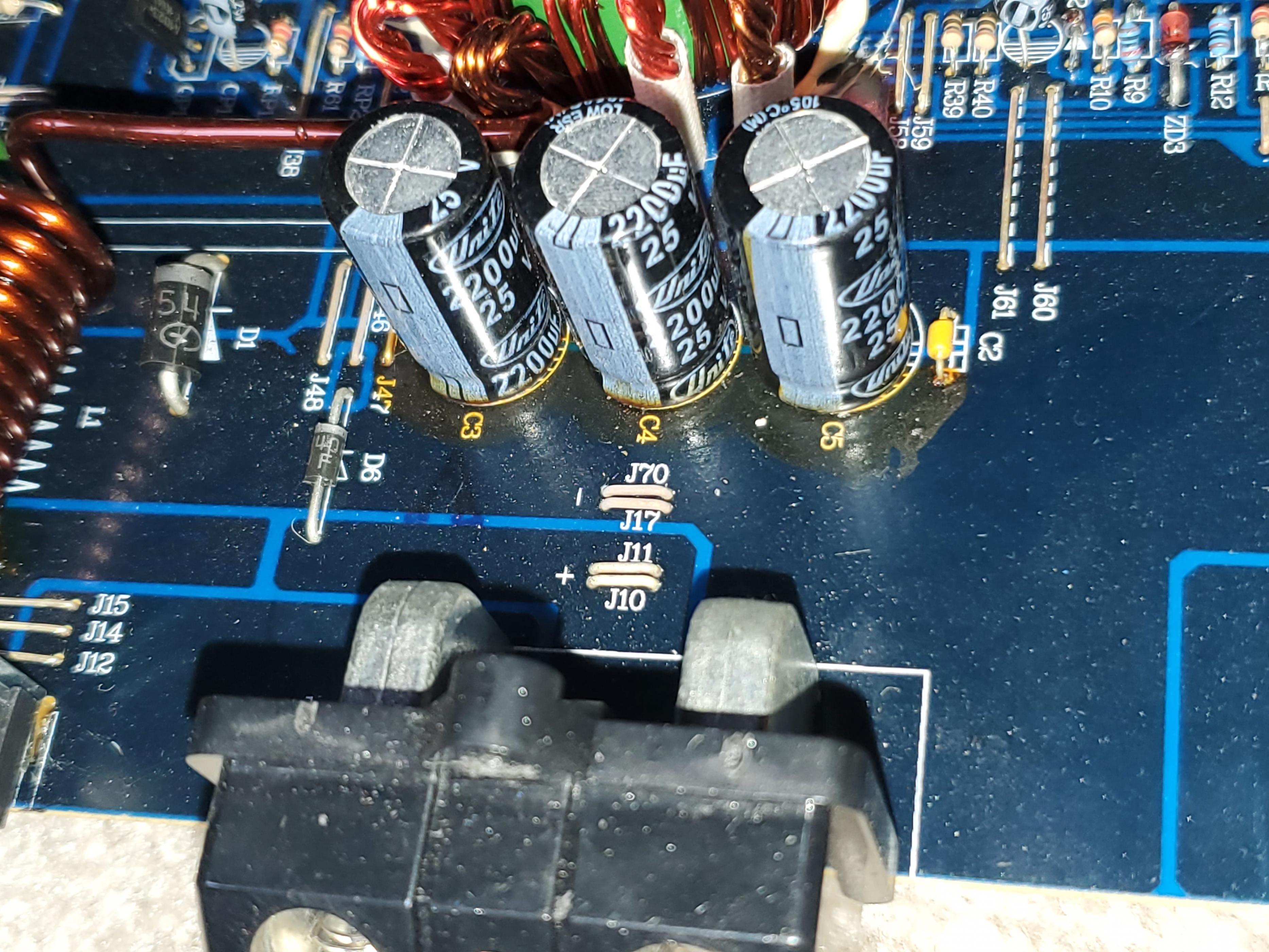

That brown fixative that's at the base of some of the filter capacitors may be the type that becomes both corrosive and conductive. If it's conductive, it can cause various problems.

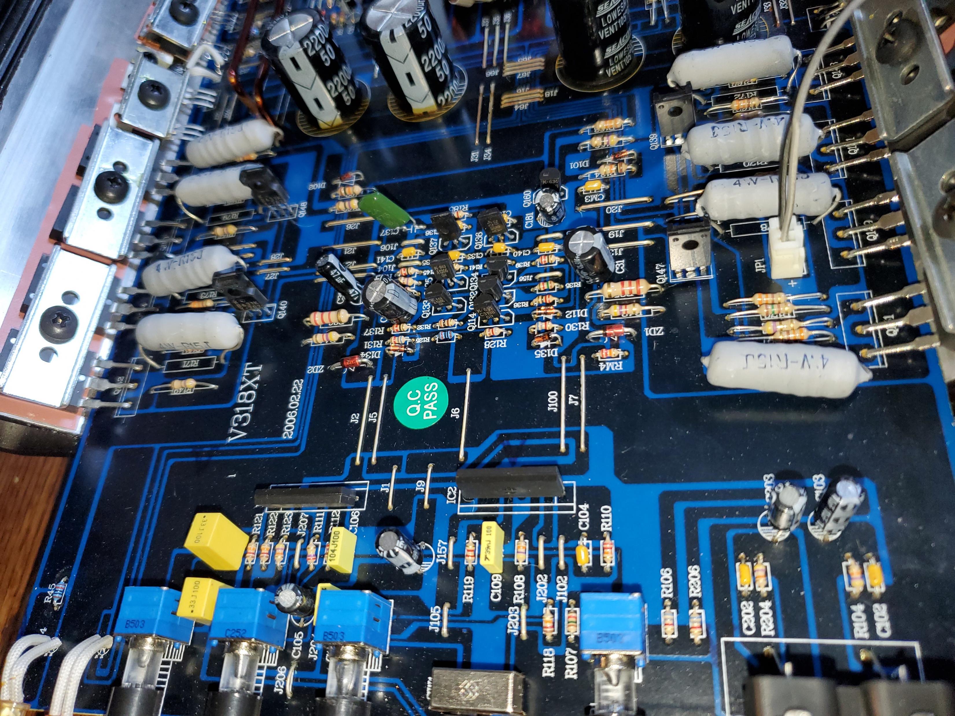

If the DC voltage between the gate (first) leg of the FETs and ground is 0v, I don't think there's a problem that needs to be repaired.
Are you referring to the brownish discoloration at the bottom of these 3 fuses in the pic?

Would you mind circling it in one of the pics please? I'm not familiar.
Those are capacitors. Yes, it's the material at their base that's causing the silkscreen to appear yellowed. It's possibly causing corrosion on one terminal of C2.

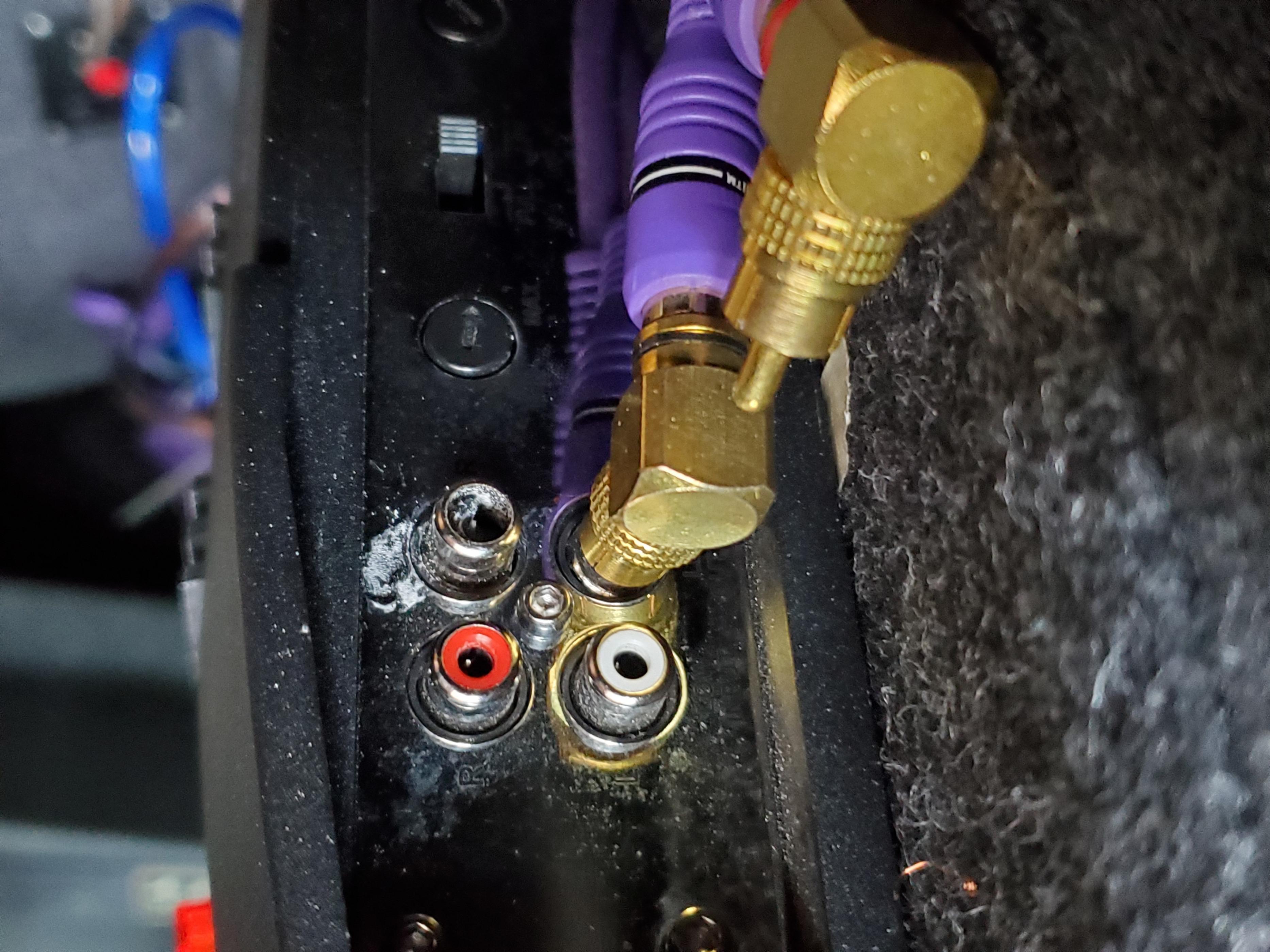

Hi, I have some news after double checking my wiring.
Power wire, Ground wire, Remote wire.... all fine, no battery draw
Positive RCA jack on amp = PARASITIC DRAW
When i disconnect the positive RCA cable on the amp, the draw is gone.
The RCA jack looks a bit beat up and a possible scorch mark in the pic.
I recall, the red circular rubber piece was loose inside, so i cut it and removed it.
When I did that, the outer rca 'shield' on the jack itself, came off but i was able to line it up and re-insert it....
with the multimeter + probe on the + of the amp, im using the - probe to touch the rca jack.
2.591 outer
2.580 inner

From what you posted, it sounded like the draw was eliminated by only removing the RCA jacks from this amp. What did I get wrong?
That's not likely ohms unless you have a very high resolution meter.
What's the resistance between the RCA shield from the head unit and ground?
Sorry for that, i still had it on DC on the multi. When switching it to ohms it displays 0. I put the + from the multi, on the - frpm the Amp, then used the - from the multi and put it on the outer shield of all 4 rcas.
Hope thats correct
The drain is isolated to those RCAs on the monoblock amp, you are correct.
