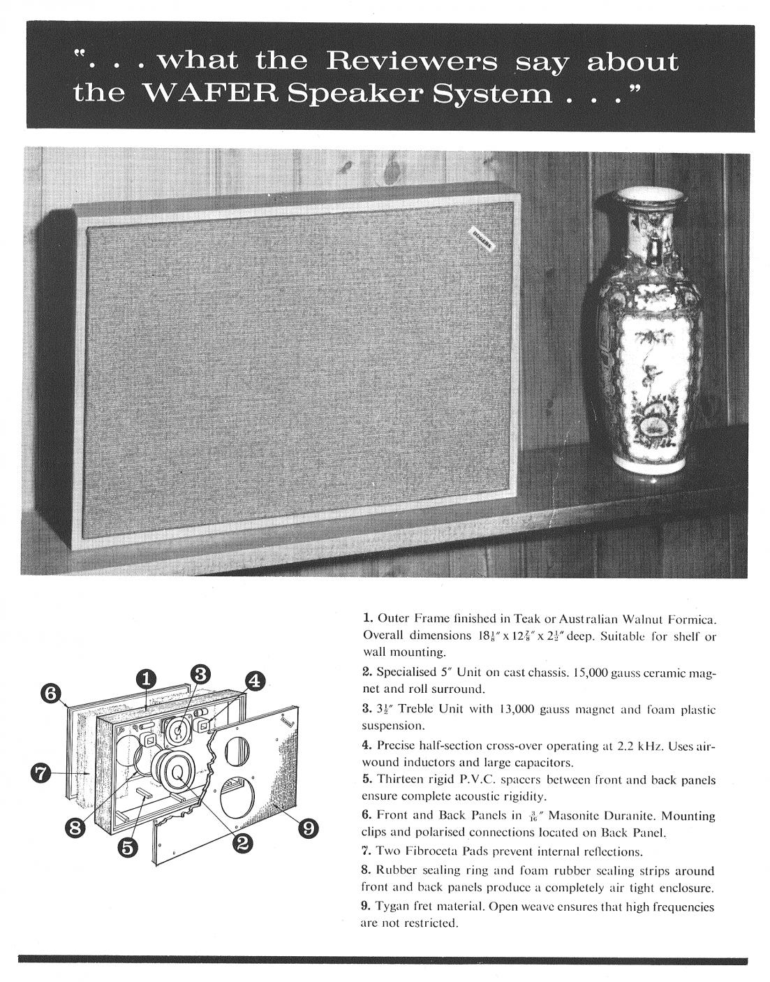

I've seen & pondered some really shallow baffles...my 2 cents.

Wow, apparently you can still get Tygan fret grill cloth...

Never mind the grille cloth many of the drivers from the 70s are back in production. I knew about the KEF B110 and T27 from the LS3/5A hoo-hah but the KEF B139 and the Coles 4001G are also being manufactured again.
