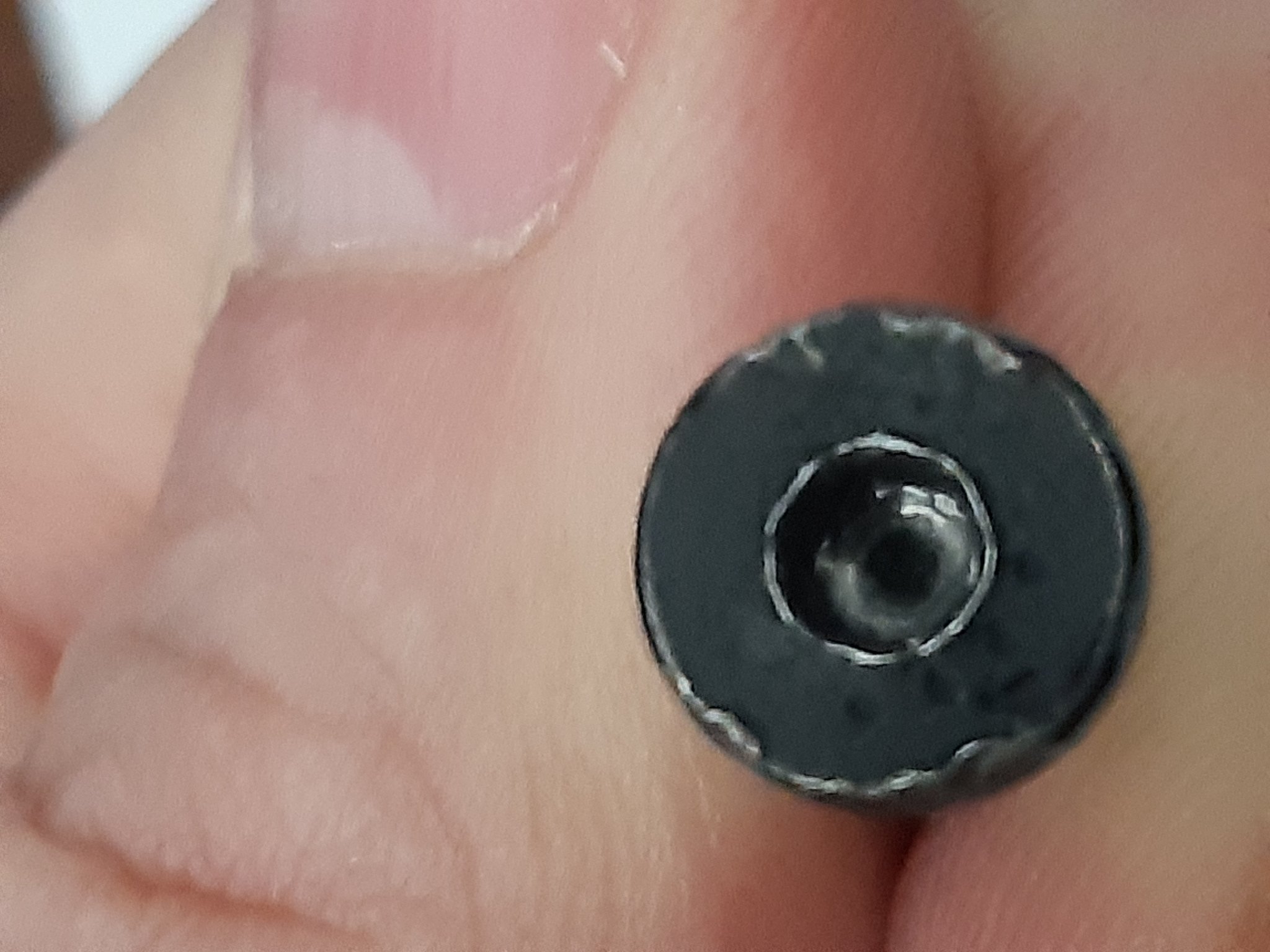

Yes, it looked like Torx until I enlarged it and it became Allen in a hurry. What is that in the center? Conanski mentioned the security pin and it kinda looks like that.
Hi Cal, I am to take a cleaner picture. But no doubt, will the given links above I have seen it is Allen BTR, simple (no sec) Hexagonal hole.
Just by removing too much time with metric allen keys that not match exactly imperial size, it smoothed them, making the hole rounder wiwth no grip.

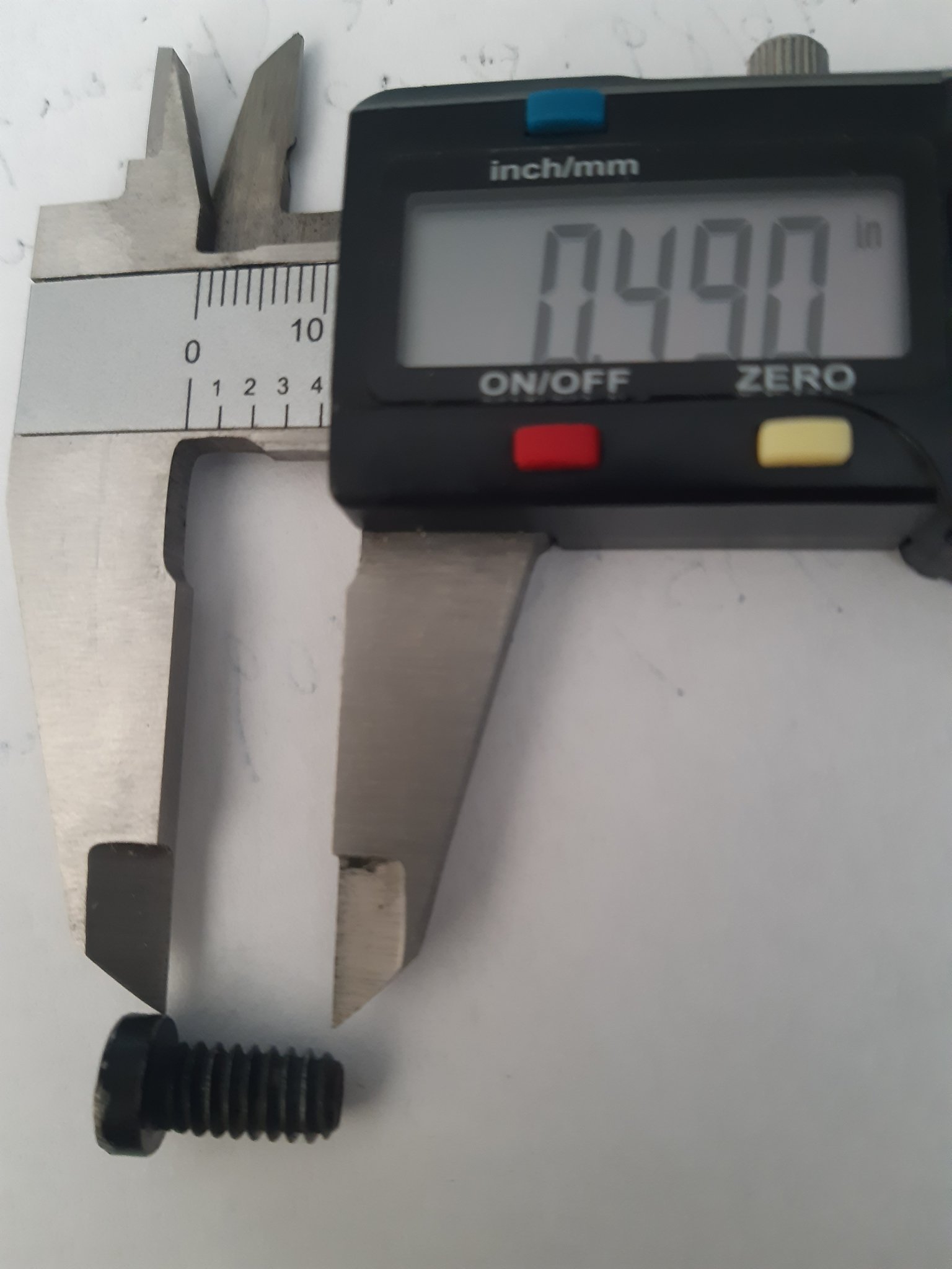

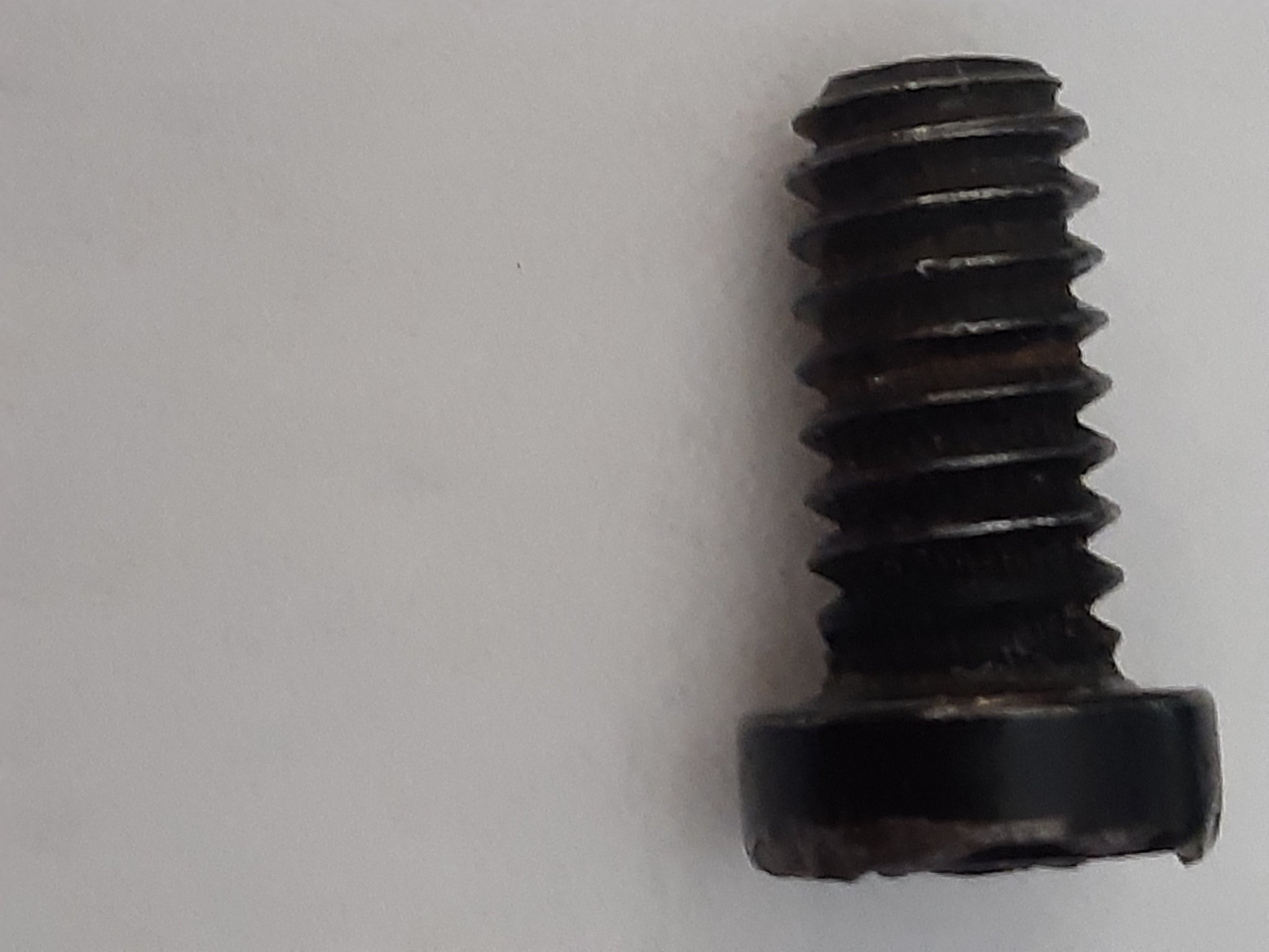

Measurements in inches : picture 2 : has 9 edges on circa 0.494" length by substracting total length from head length (well 0.49" on picture " but hard to take with precision)
Maybe so, but pictures looks like a very worn/abused TorxThey are hex.
I clearly see the Torx "star ends" in this picture, and the center pin:
I´ve never ever seen Hex with a "safety" pin/nipple in the center, so ....
And a worn Hex would look rounded, never with (remains of) star tips.

It is hex not torx because it is not a nipple but the curve hole that looks like so.

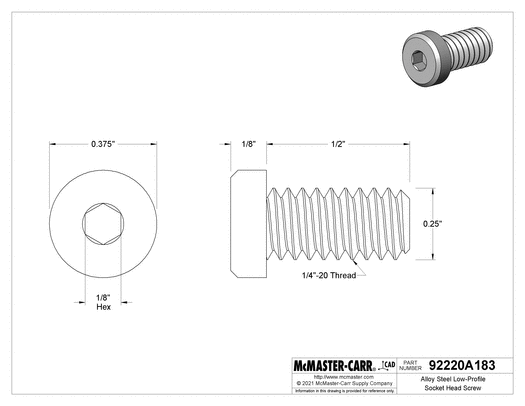

It looks like a plain black oxide socket head cap screw. 1/4-20. The hex has been worn into more of a star due to mounting and unmounting using a hex key that's too small.
The only snag here is that the head is a low profile type which is about half the height of a normal socket head cap screw. If you need an exact match you'll have to go to a real hardware/fastener store or to McMaster-Carr (linked to above). You may have to buy 50-100 of them to get the one you need.
I'm thinking this is what you want: https://www.mcmaster.com/92220A183/

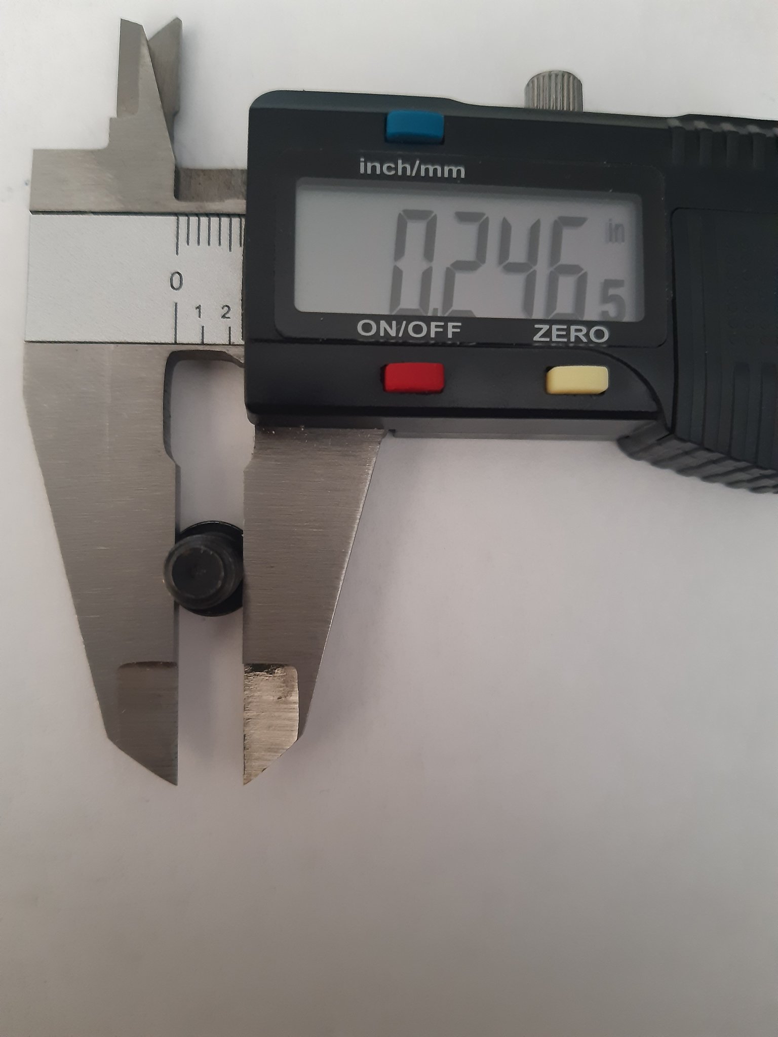

This won't work for American threads. Pitch is designated as threads per inch. The method above does work for metric threads, which is number of threads per millimeter.You can measure the pitch with a caliper, use it for ten pitches, measure, divide by 10, that is quick.
Verify the pitch, then order.

Who mentioned millimeters?This won't work for American threads. Pitch is designated as threads per inch. The method above does work for metric threads, which is number of threads per millimeter.
Measuring length of 10 threads and then dividing by 10 is a universal way to get more precision, measurement scale is irrelevant.
Same with weighing 10 screws or anything else; it is averaging.
Helicoid inserts need a special tap here, so expensive to do in small quantities, the inserts are not expensive....the tap is extortionately priced.
The reason I mentioned measuring pitch was that it would remove confusion between 10-24 and 10-32 screws, which have different pitches, and checking with a nut would also clear that up.
