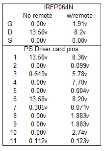

When I apply power and ground there is no current draw. As soon as I apply remote power there is huge draw on the 2ohm 50watt resistor. Power drops from 13.54v to 8.3ish vdc. The resistor gets hot to touch in a couple minutes. None of the ps transistors get hot at all.

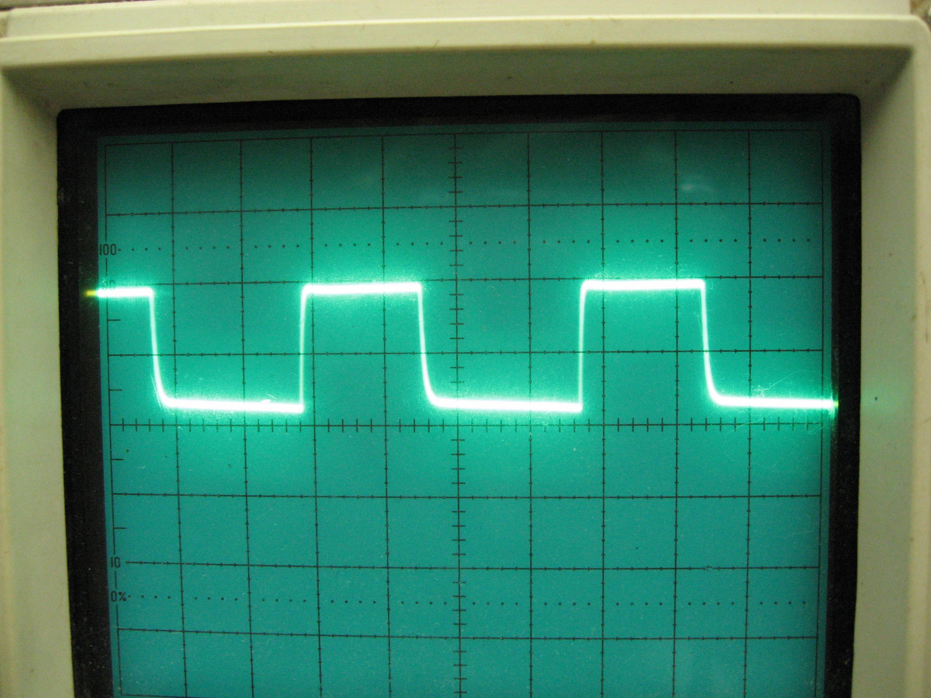

I have a nice square wave on the gate (only2v though, I assume due to the power drop. B+ voltage on the drain (which drops to 8.2v with remote power applied), and 0v (ground) on the source.
Please see attached pics for wave form and power chart for the ps driver card pins.

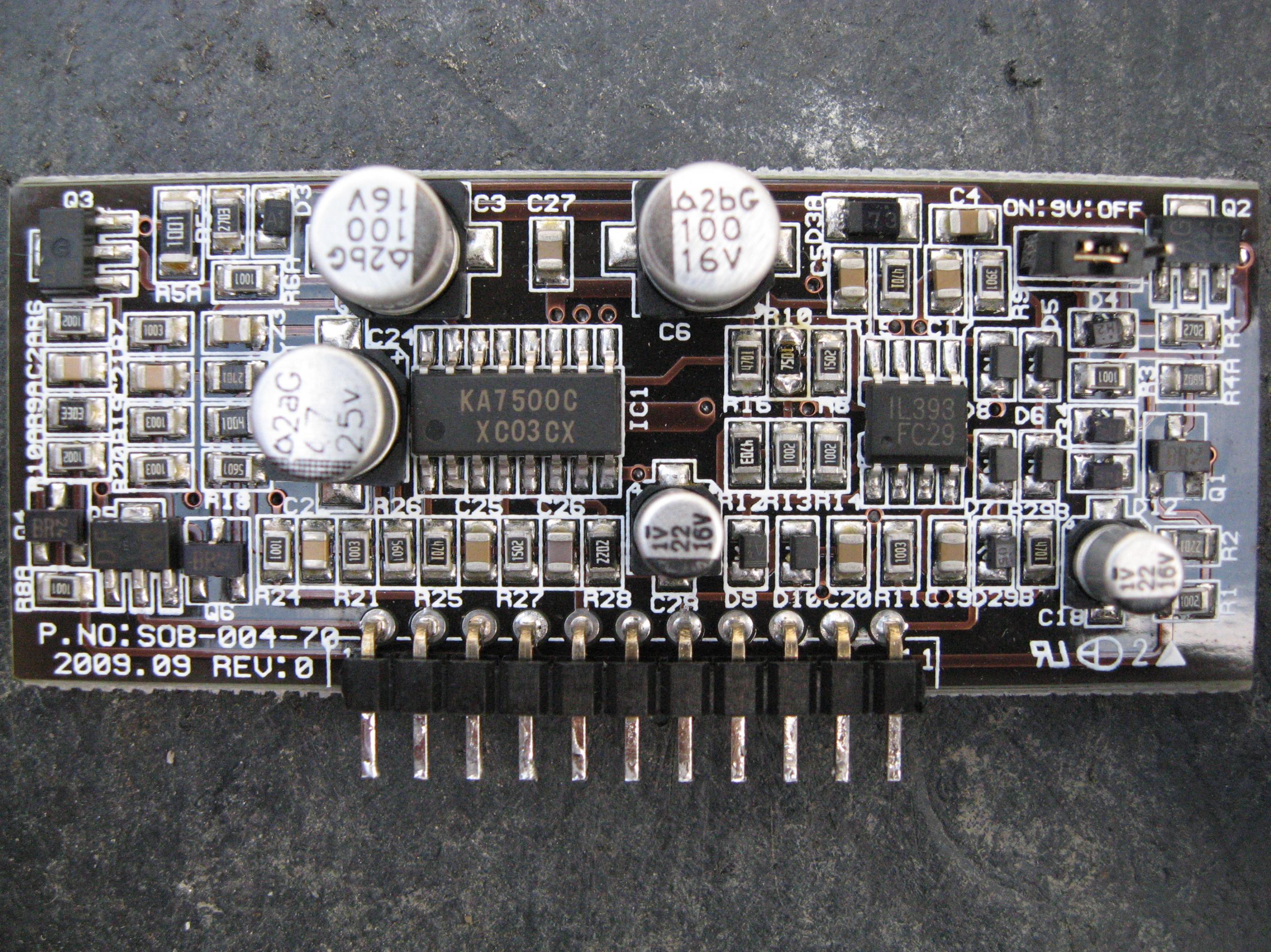

When I checked D3A (ps driver card, removed from the amp) on diode check I get .977v one way and .137v the other direction.... is that normal with this card? I have an older version card that doesn't even have a D3a on it, so I can't check.

I'm a little stuck on advise not knowing the scope settings.
If you not pulling almost to ground on gate drive signal and its not 10v approx of amplitude then your going to have problems.

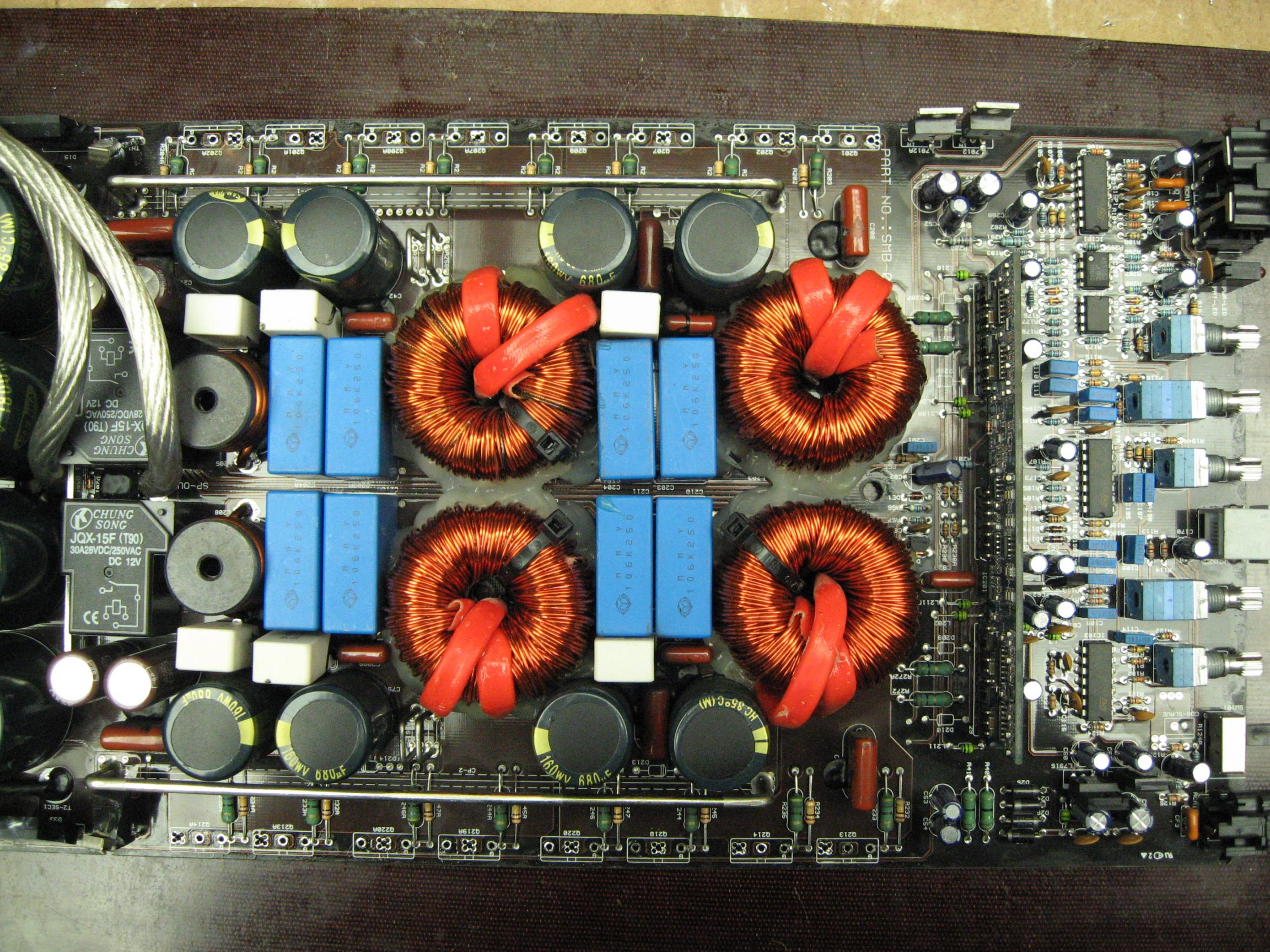

O.K. A little update... problem was not the ps... powers up fine after pulling the rectifiers. Pulled all the new outputs back out and found 2 shorted ones... all legs shorted, but still looks good as new. 🙁 SO, reinstalled all the outputs and replaced the 2. Amp turns on using power limiter, relays release muting, and I have a clicking noise coming from around the output filter inductors, and between -1.24 and -2.5v dc pulsing on the output terminals.

I removed the outputs and the clicking sound stopped. It was coming from one of the small inductors.
Here are the voltages I get from the card. Also I didn't see any square wave on any of the center pins.
I have the following voltages on the output transistor pads
G) -0.561
D) 132.6
S) -0.180
G) -128.1
D) -0.180
S) -132.5

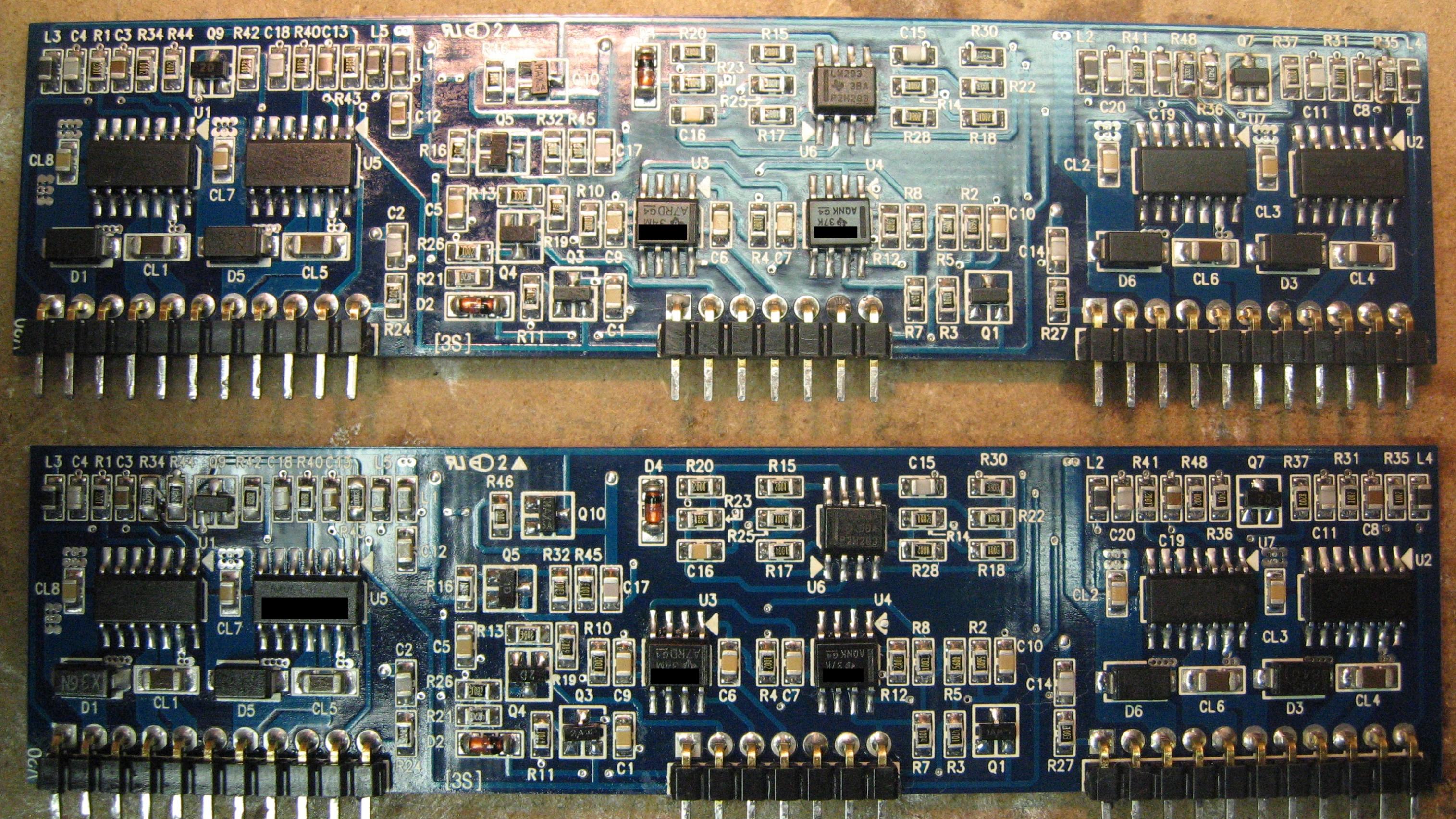

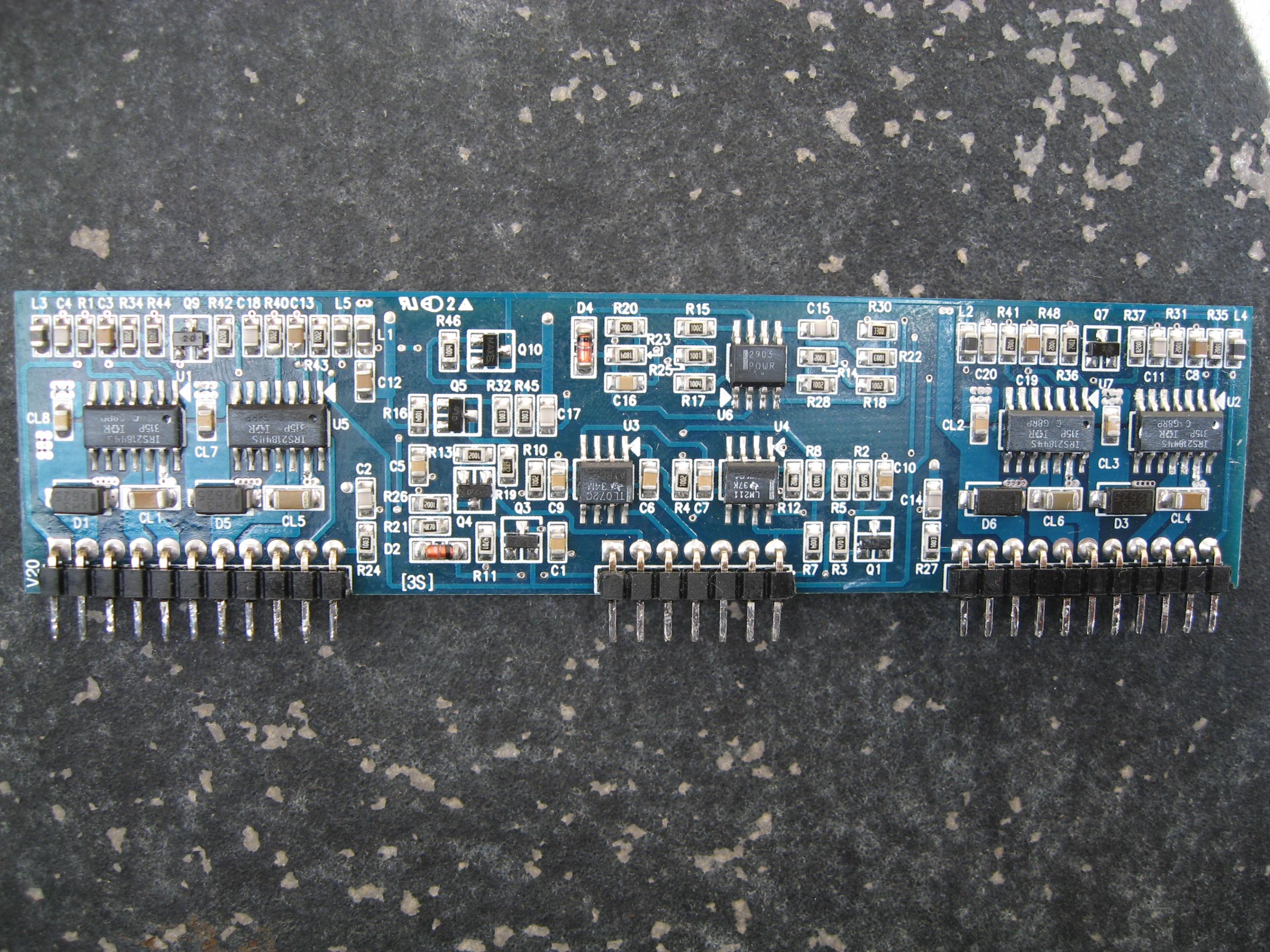

I went over all 4 IC's and the readings all match. However... I don't recall on previous cards having a reading between B6 to R7. Please see attached photo. Would something else cause this or could all 4 be damaged? (R=red probe, B= black probe orientations) This is the first time I've bought these in a cut tape strip... I usually buy them in the hard plastic tube. Not sure if it makes much difference.

I checked another card... and it seems to read OL from B6 to R7. Also another new IC reads OL out of the circuit... so, I'm going to replace all 4 driver IC's again and see what happens. I know there was 2 shorted (all 3 pins but were new transistors?!?) outputs, however not sure from exactly which bank.
Hopefully its nothing external and it just happens again to the new ones Here is a pic of the actual card. I did also replace U3 and U4...

I replaced all the 21844s and back to the same point. On diode check I have .948v with the black probe on pin 6 and the red probe on pin 7... As soon as I soldered each one it changed. I'm quite positive I'm not damaging them. I've installed many of them, never had all 4 fail. And the 4 I removed tested fine out of the circuit. What else could cause this reading between those pins. I checked just the pads and it was OL before I added the IC.
I'm stumped...
