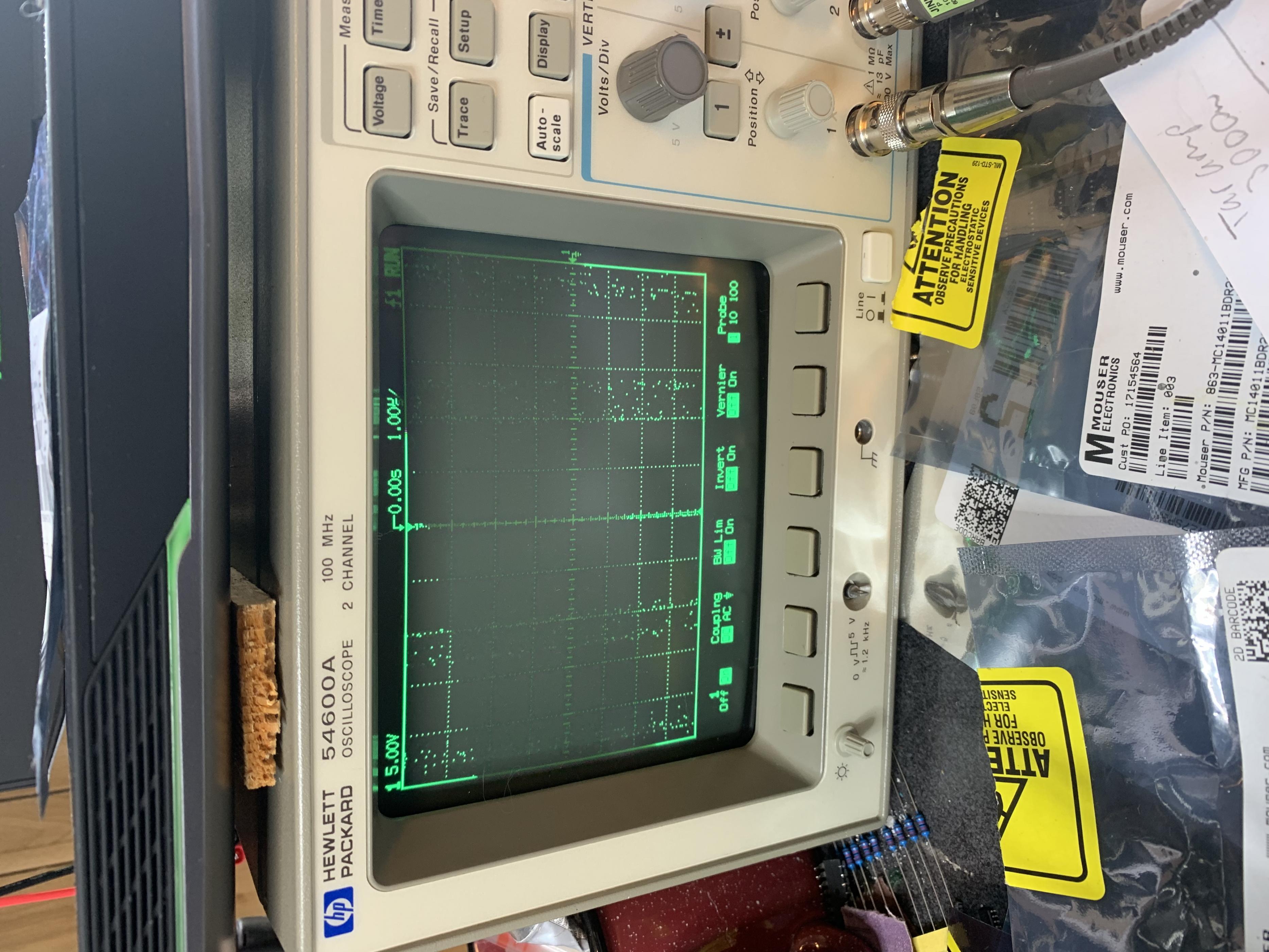

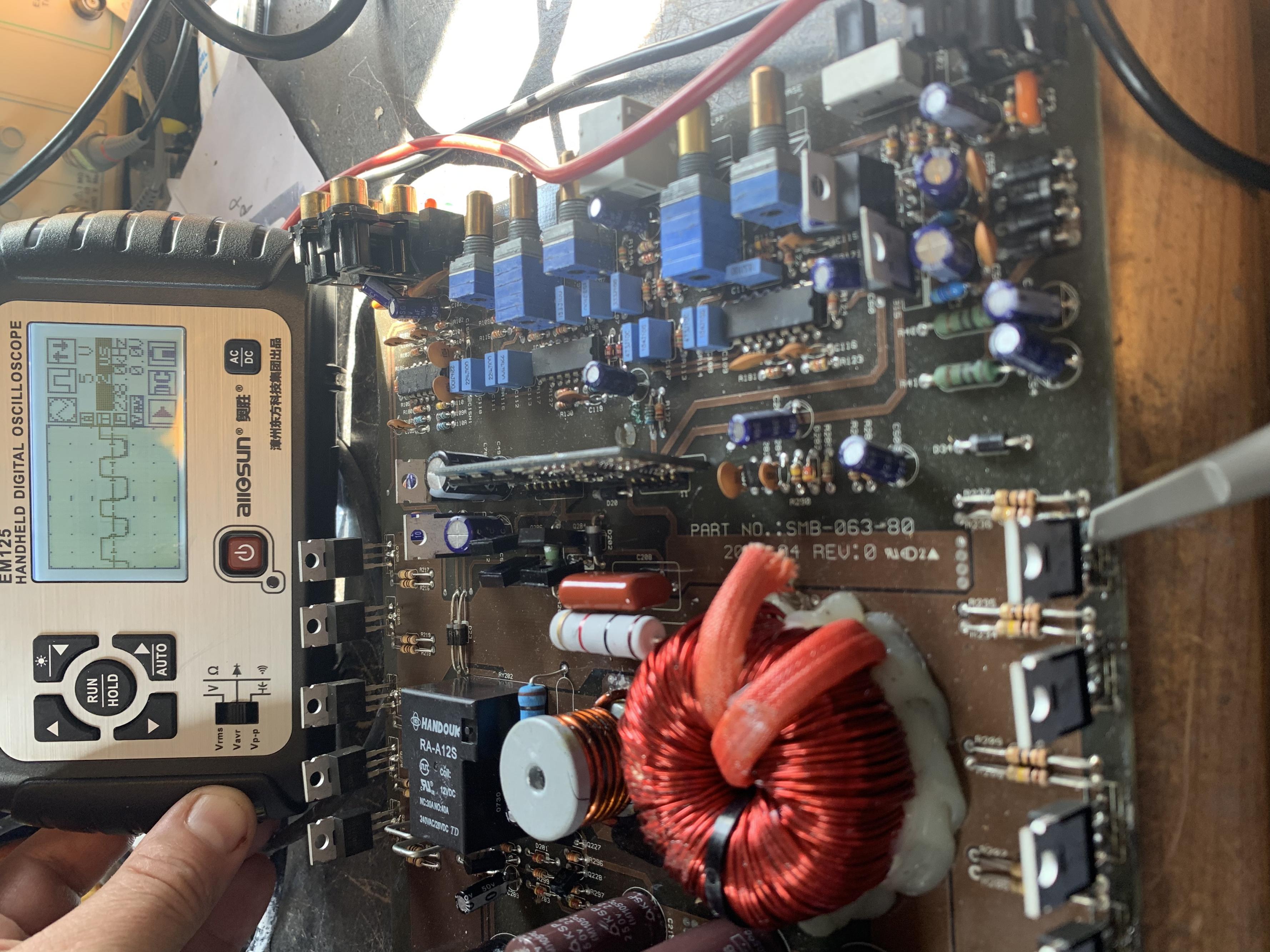

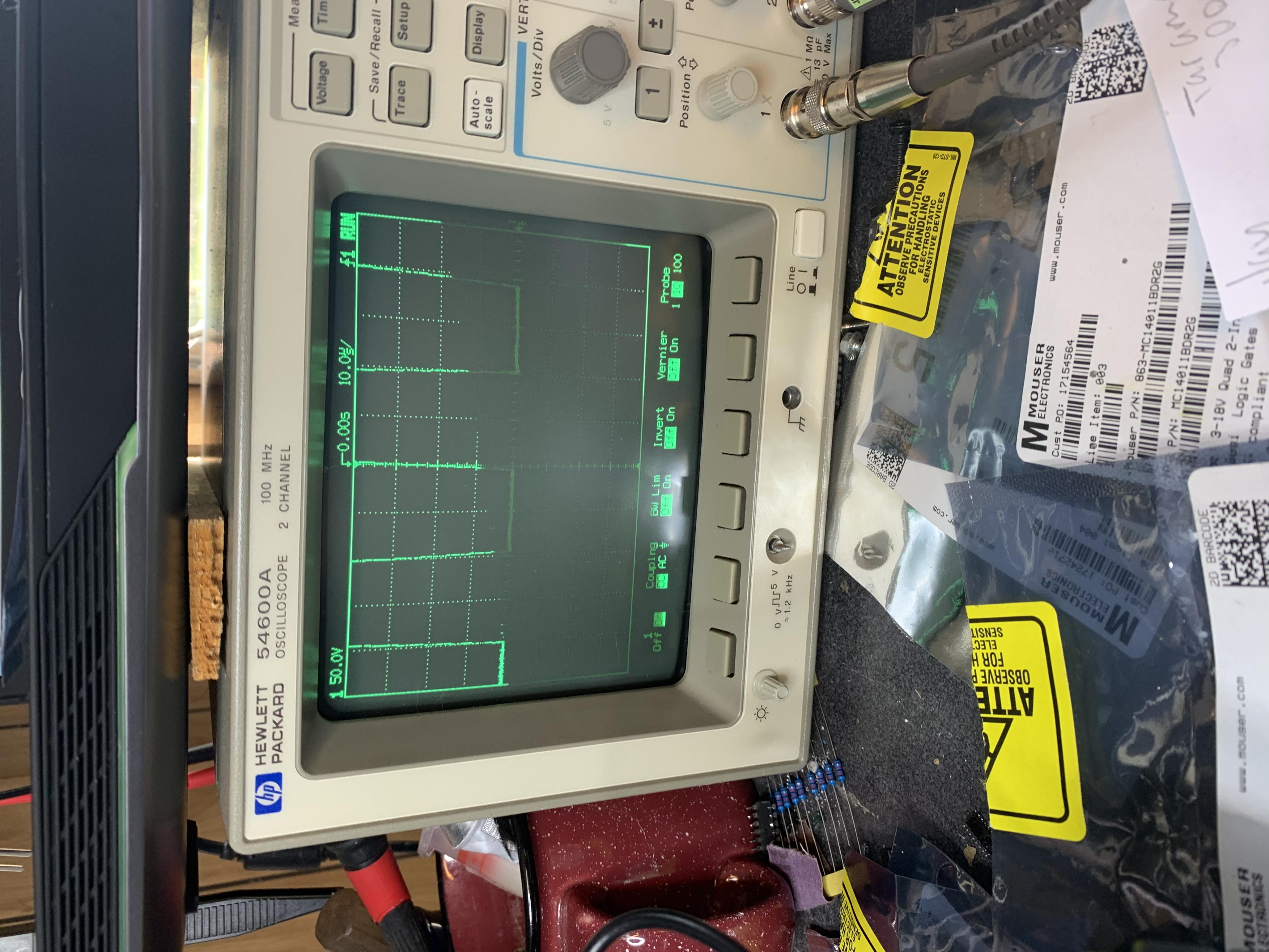

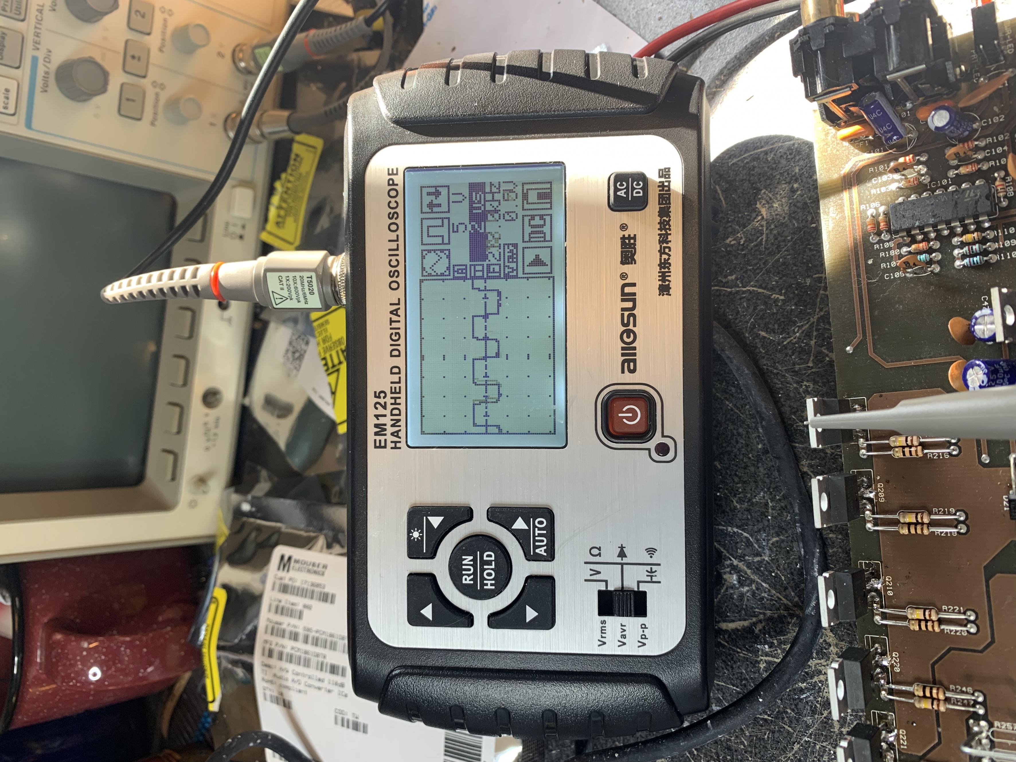

This the drive signal on the high side and low side drive. It’s hard to tell from pictures but the drive signal isn’t stable. It fluctuates between 190 and 230 kHz at 0.5 volts on the high side and low side FETs.
I am using a battery powered Oscope because I can’t get the drive signal to show up clearly on my mains powered scope. I’m not sure why. But I digress.

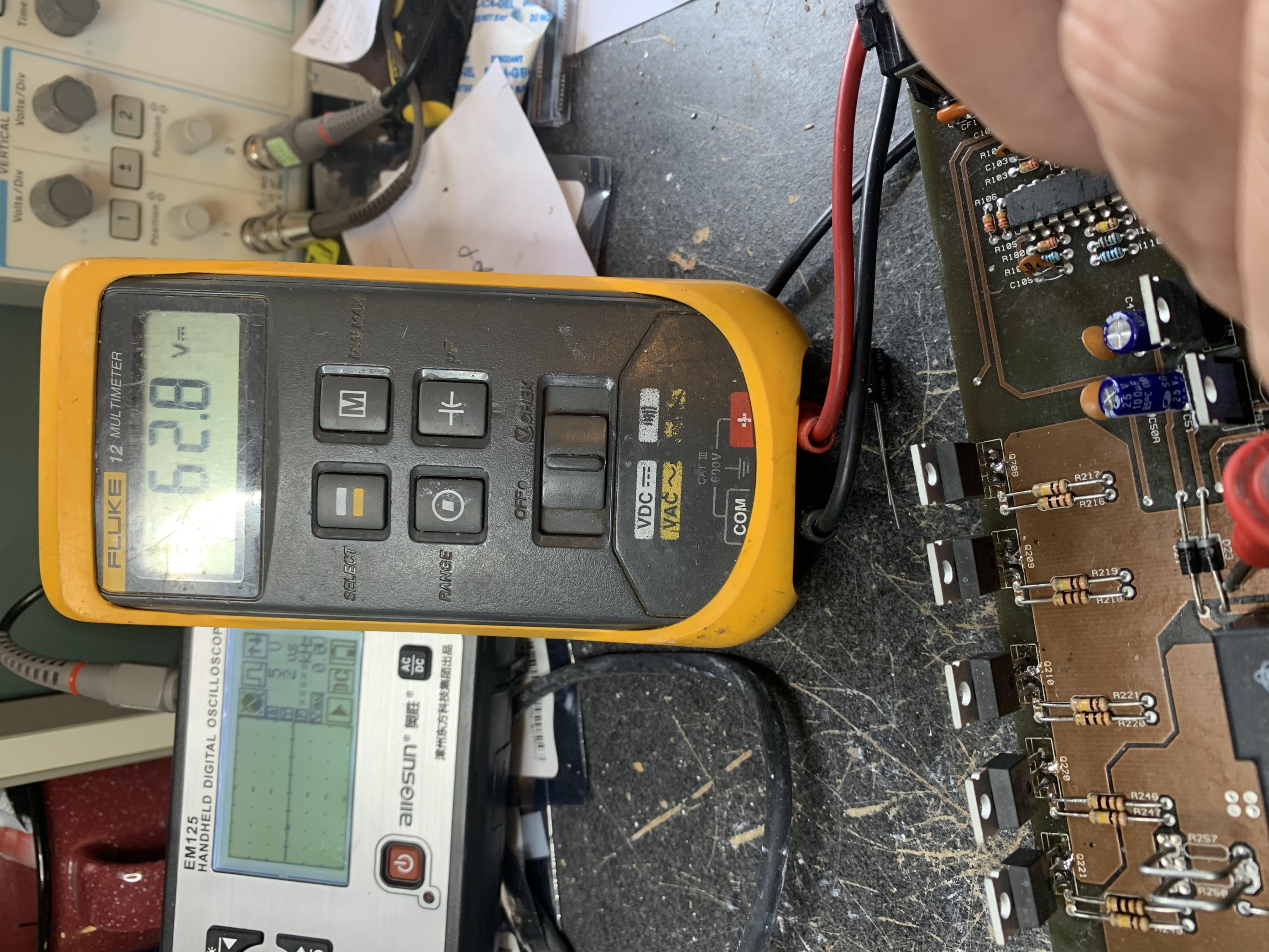

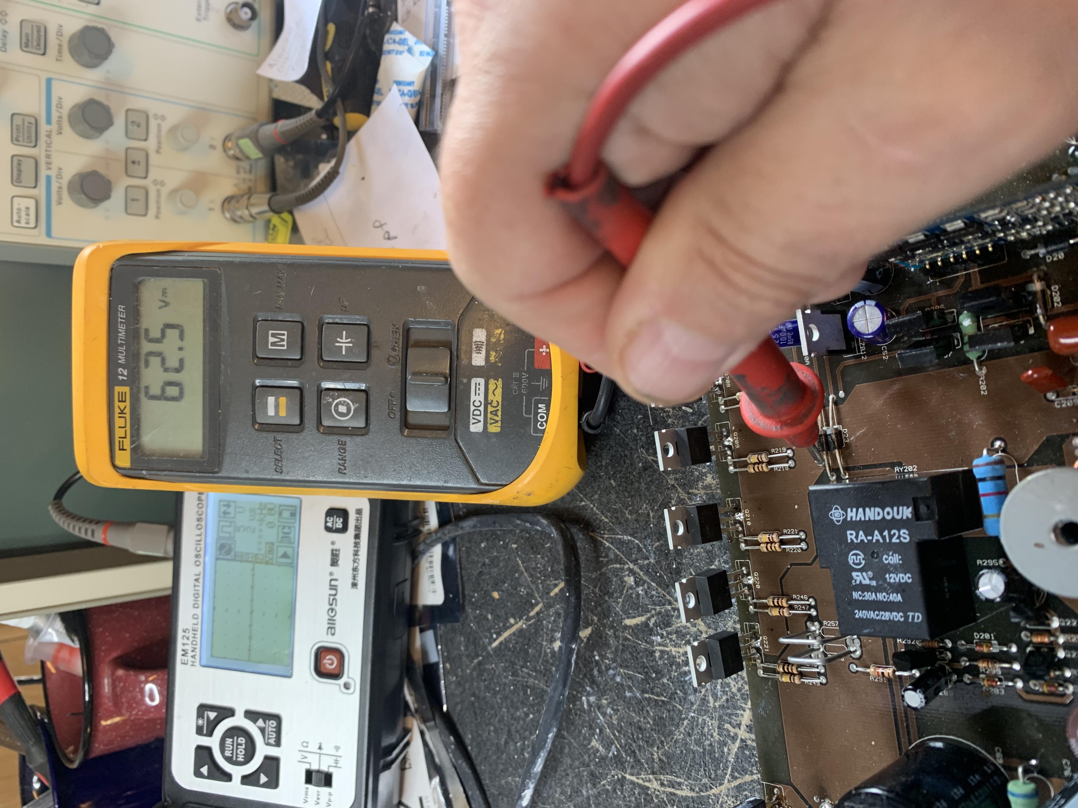

High side rail voltage is approx 59 volts and low side rail voltage is approx 62 volts.
Photo one is high side drive and photo two is low side drive.

Are you using the secondary ground when measuring the rail voltage?
What sort of problem are you having with getting a waveform on your scope?
Have you tried using it in differential mode?
When I try to view the wave form on my mains powered scope all I see is a bunch of scattered dots. When I zoom in with time division I can see some resemblance of the wave form but it is still just a bunch of dots. No defined lines. I am grounding the probe to the negative terminal of the amplifier.
I am measuring the rail voltage with my fluke 12 grounded to the negative terminal of the amplifier.

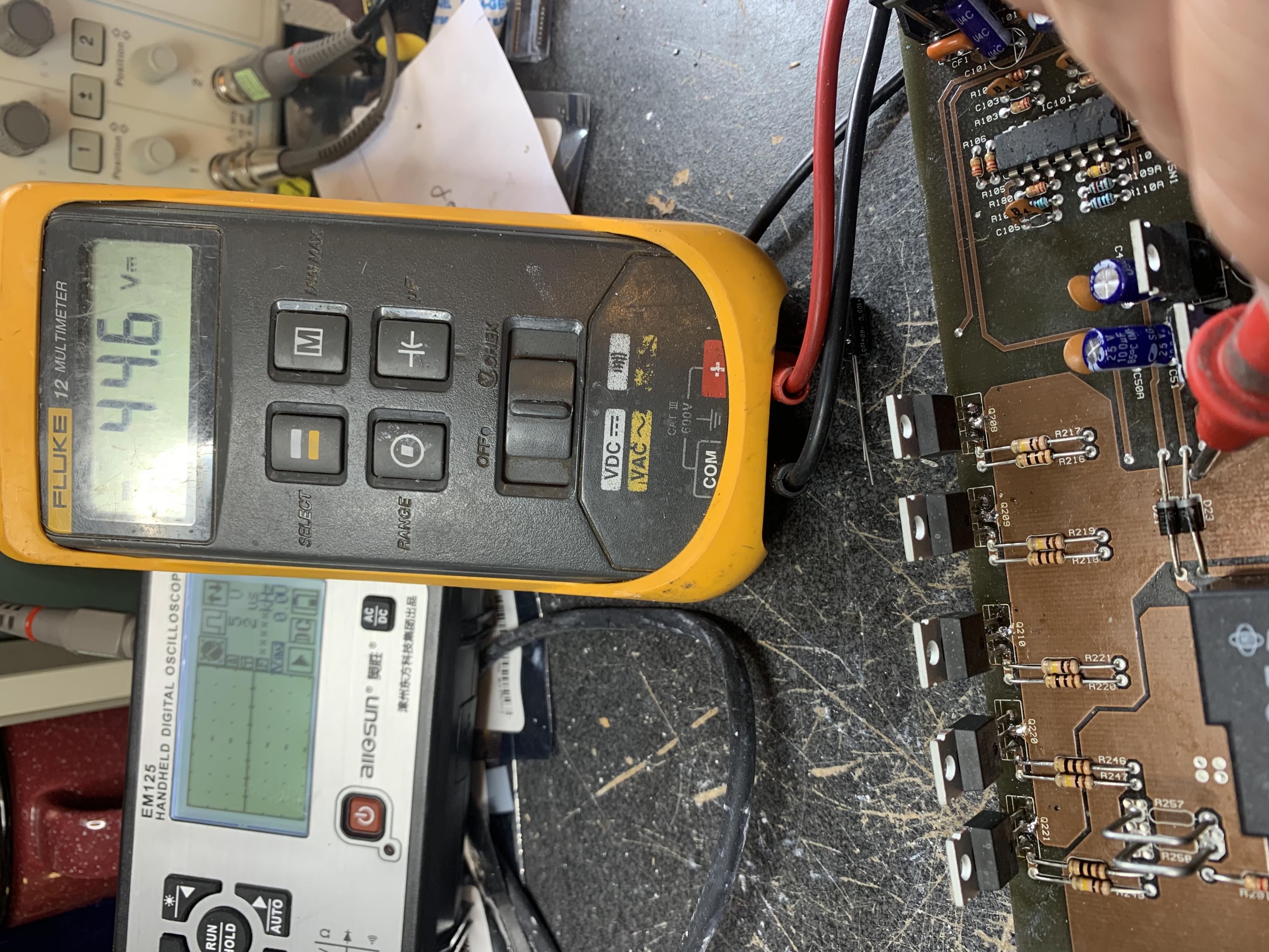

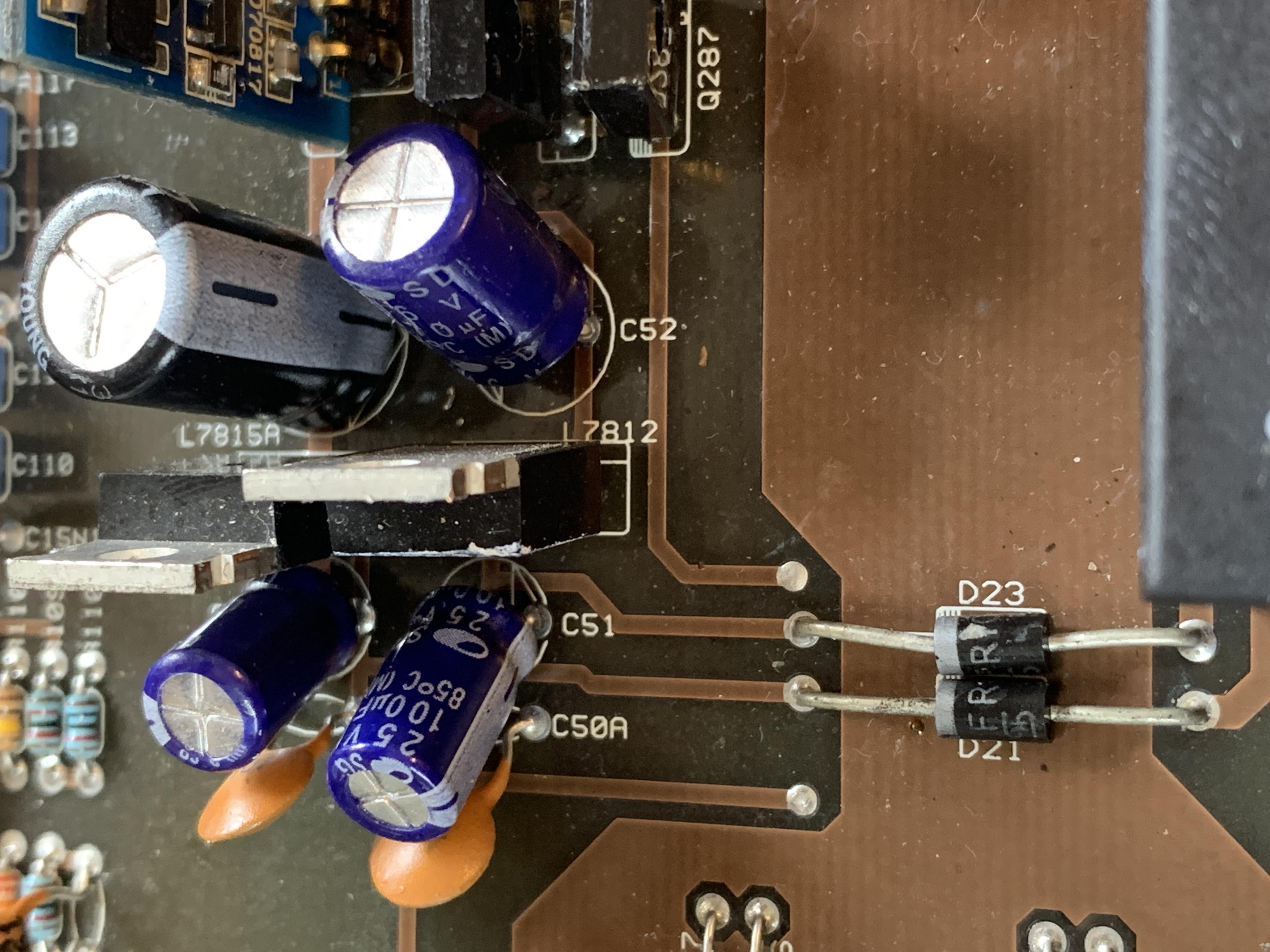

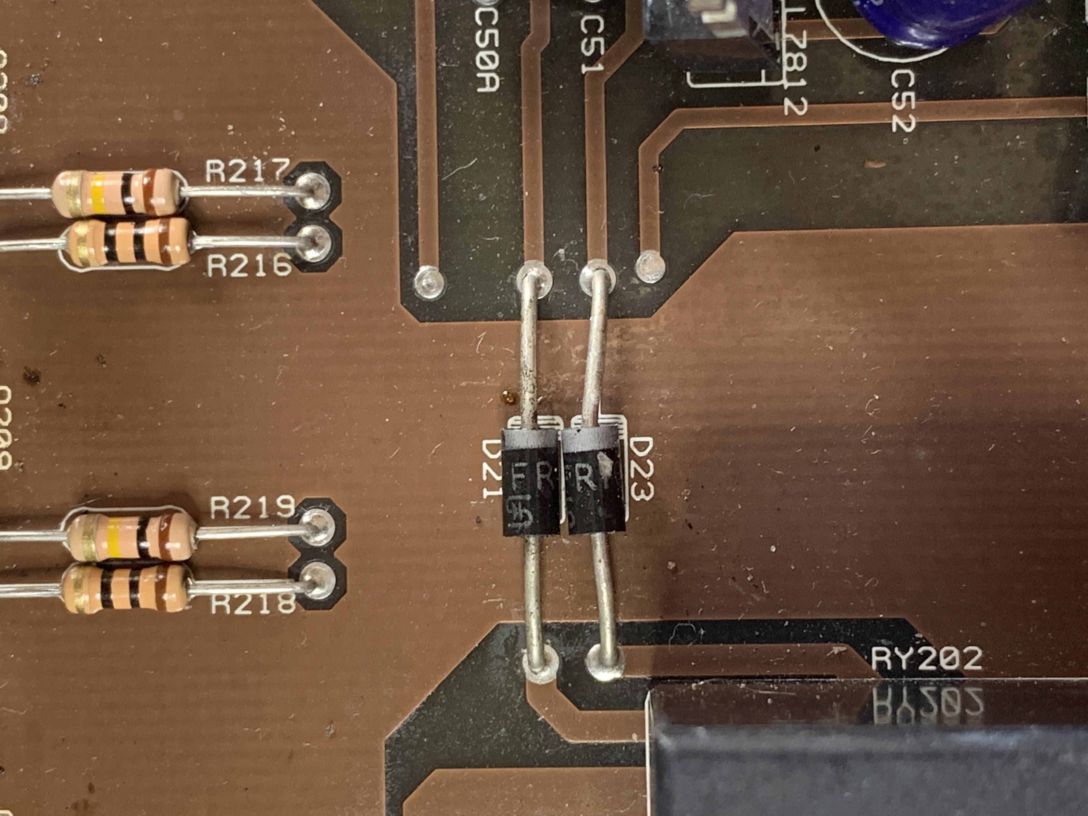

Well. In the repair tutorial you stated you get 46 vdc on the cathode side of D23 so now I’m thinking the reading I got is normal for this amp.

Only dots? Is your scope damaged?
Using the scope in differential mode will allow a much different setting (5v/div) than you'd need in normal mode.
No matter which leg I probe, if the is a drive wave there then I get that image on the scope. If I get on a leg with DC voltage the the trace deflects off the screen.
