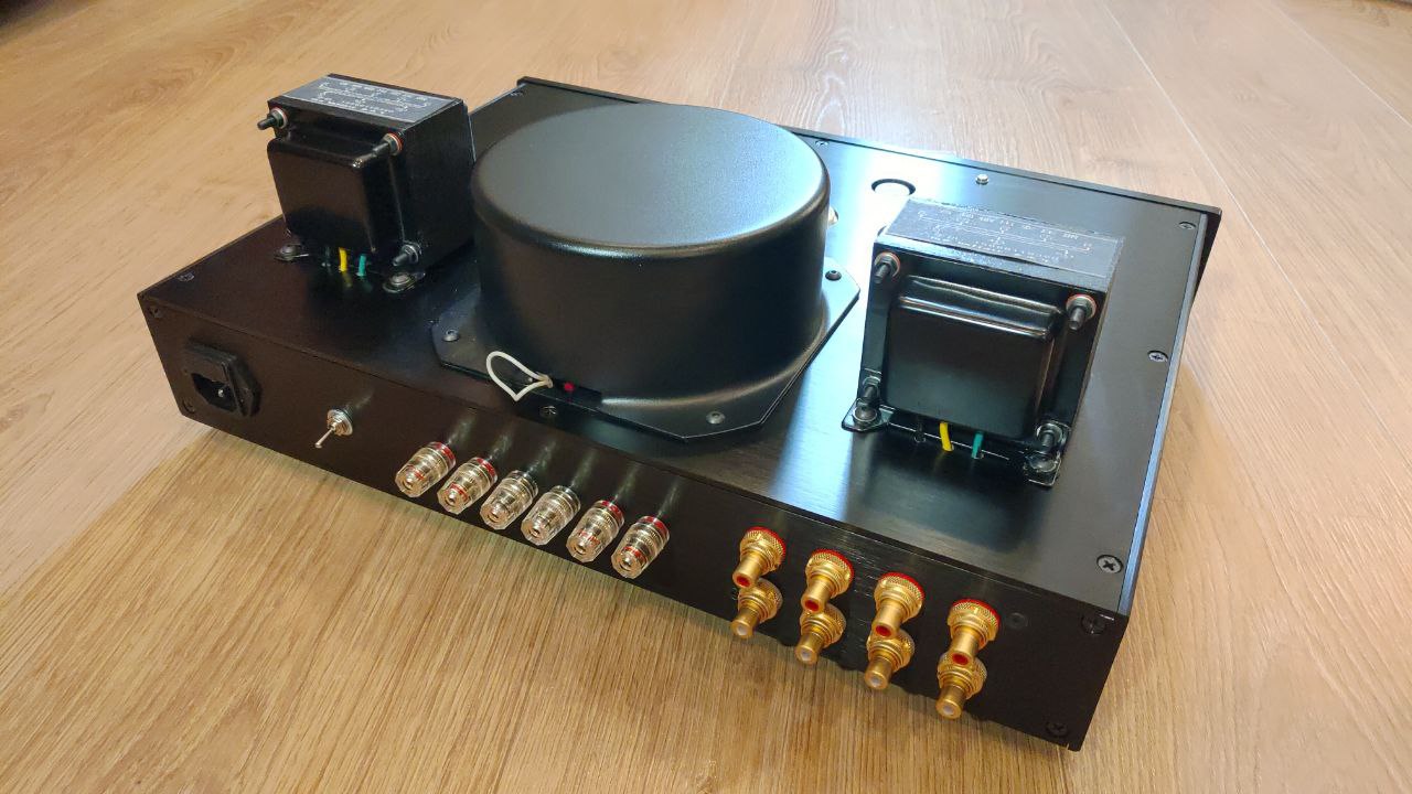

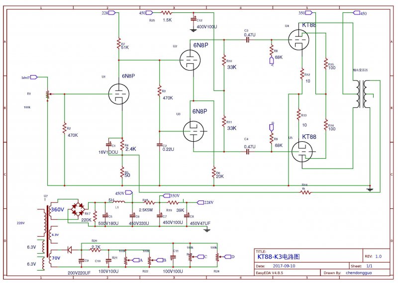

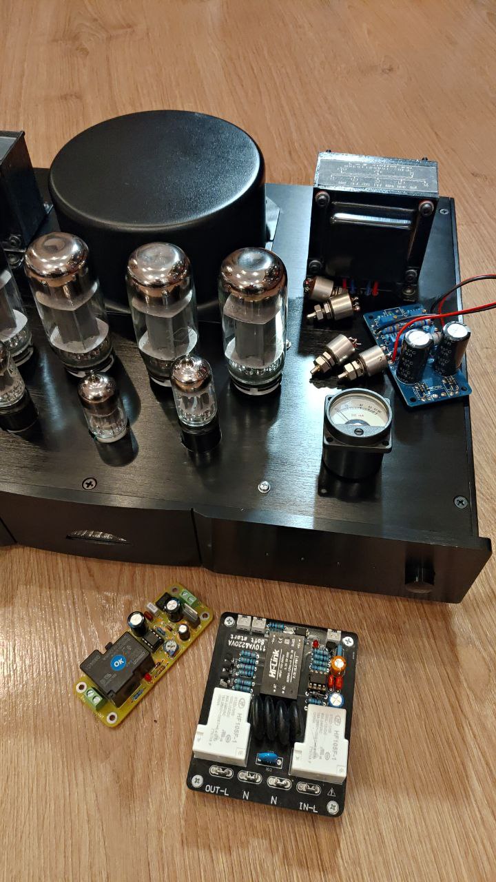

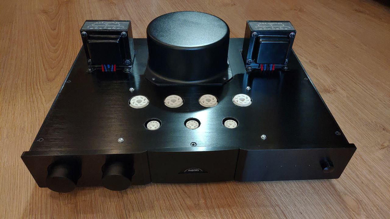

Good day! My process is also slow. I soldered the amplifier a year ago, but then covid19 closed all stores and the project was frozen. This year I renewed it, photo. Look for experiments with another version of the scheme of Chinese engineers. 6n8p=6sn7 ~ ~ 12a ** 7.

Some comments about the Oldchen schematic:
  • C12 must be at least 450V. The 1.5K resistor is not going to drop 50V with the typical 6N8P LTP currents. Also, when the tube is cold, you will have there 450V if B+ is on. Maybe it makes more sense to use the +350 tap to power the LTP.
    • Edit: C5/6/7/8 and C12 must be at least 500V, and that is still below the peak voltage you will get there at power up 360*1.414=509V. There is no B+ delay due to the use of a solid state rectifier.
  • R8/R9 seem quite low, usually 100K is used for fixed bias.
  • Both U1 and U2 are low mu triodes, ~20. Usually U1 would be a high mu one, like the 6N9P (6SL7), otherwise the open loop gain will be quite low, not enough for gNF to be effective.
