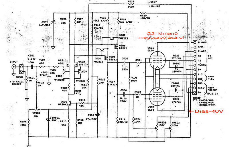

Hello, I have a little problem with my amplifier, It is working very well but time to time it makes a shoot sound - like when powering up an amplifier- while listening to music for some time. I happens one time during a day.
Also the main issue is that when I have received it, it was working very fine while listening during a day, after that when I have turned it off and left it for a night next day it stopped working- the fuse has blow up also soldered connections nearby. I have took off blow tin, put a new fuse and soldered that up. It was working nice for some time and than it happened again - with shooting from the speakers in the meantime- I have repeated the repair and it is working now but the shooting persist.
I have checked all connections on every board in amplifier and resoldered bad looking ones but it haven't solved that, I saw that somebody changed original Siemens EL34 N92 (very used with dark clouds on top) to EL34 TGL 9649 on the second board. So at the moment I have 2 old siemens and 2 TGL (RFT). I will be changing the valves but should I keep these to RFT and buy 2 new RFT or should i rather get 4 valves from Mullard?
Also on board with new RFT valves I have saw odd connection which can be seen on picture, also on preamp board there is a capacitor where I think it shouldn't be, any guess?

Update: after dis attaching the little copper wire seen on the 3rd picture- wire which connects top valve to some part on the board ( some service tuning i guess - I don't know what for) the valve connected by the wire doesn't light up. Still occasional shooting from the speakers appear time to time. I will update if the fuse will fail again.
Up2: after dis attaching the copper wire speakers makes a loud brooom sound when powered back on after running for a while, smoke appeared as one of the wires touched the case and started melting 😀 re soldered the copper wire back again and its running again, I guess this copper wire works as a ground.

I think you should replace the tubes. Once it has "flashed" ( an internal arcing) it will
do so again.
Get a matched new pair, don't care for expensive "NOS" get a pair of new production

Thanks for reply, I will replace the valves for sure, I'm thinking about buying a quad of EL34B/TUNG SOL-RU or EL34 MULLARD-GROOVE TUBES. Do you have any recommendations?
Also how about this wire, should I leave it like that or with the new valve set dis attach the wire?

Regardless of any other solution remove the solder flux and carbonized sectors of the PCB with a cutter, paint thinner and cotton, flux and carbon both conduct electricity at some extent, I have so many unbelievable stories...
Also pay attention to two electrolytics on the left side in your last picture, from here they seem overheated, be sure that the bigger one has its top perfectly flat, in the picture seems a little bit swollen, another symptom of overheating.

Seeing more carefully your third picture, the failure maybe is due to bad solder joints between both sides of the PCB, the copper wire seems to be a reinforcement for one of them, if you put sockets, be sure of the proper contact on the other side (solder side) of PCB, sometimes metalized holes (if any) fail, and do not forget cleanning al solders with paint thinner, or a good nail polish remover, my wife use one with lemon perfume...😀
Cheers everybody for all the tips 🙂 that's very helpful. That is right that the pcb board is a very low quality, all connections are coming apart, and this is probably the reason why there is a wire.

I meant plate, sorry for the confusion. My experience tell if you are as red as around 40 seconds, the fuse will pop. 😉 https://www.youtube.com/watch?v=9SfJJ8A8XNM
I would recommend to replace c505/c506 with a Russian Paper in oil capacitor called k40y; high quality and the sound is for its price really good. If you notice a difference, you can go on from there. You can try for R522/R521 a tantalum resistor like audio note or shinkoh, but you can also take something like a Takman resistor.. see what you notice there!
Also, for the Electrolytics that poplin mentioned.. I would replace them with Elna Silmic II. They're quite old, it would be an improvement anyways, and for the 10/30 cents you'd save on them I wouldn't go otherwise. I've let quite a few caps compete with each other and they're definitely worth the few extra cents. Note that you can always go higher with the voltage value of a capacitor, never lower.

Also I have found that one diode on right of the lower valve is burned underneath and is other size than one nearby top valve so I will replace it as well.

I see yours has this schematic:
Image - TinyPic - Free Image Hosting, Photo Sharing & Video Hosting
the one you posted was this, so I have followed that one:
https://elektrotanya.com/files/CVT3030_r.JPG

@Hvlemmi thanks for the right drawing I received that one from AMC and it was misleading, I wrote down what to buy by looking at the boards.
