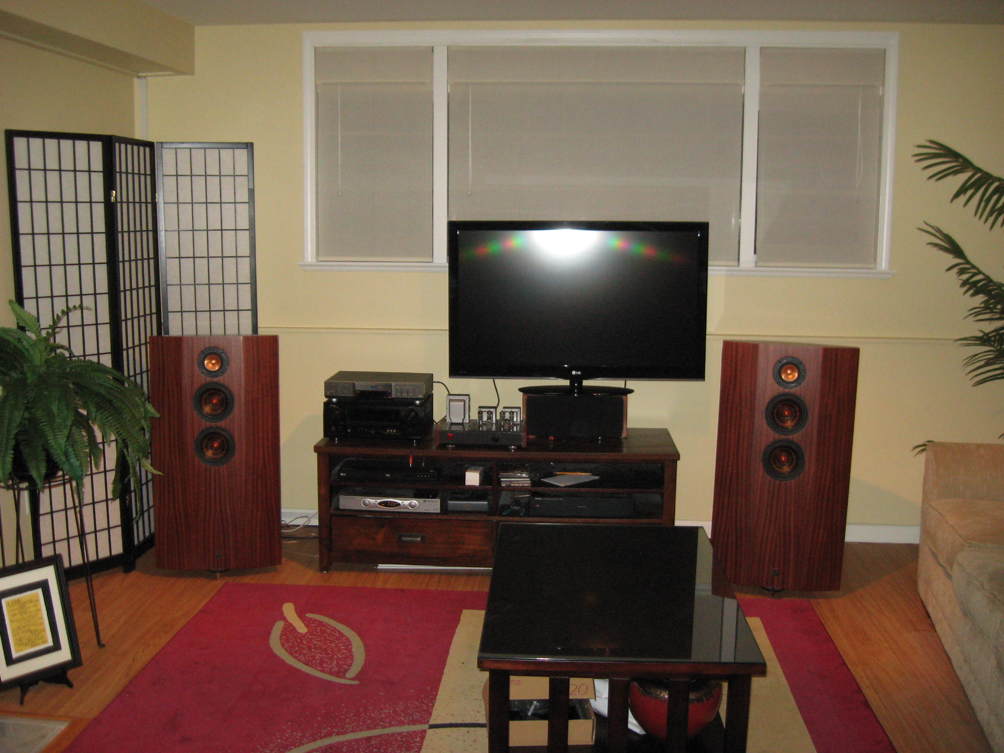

As Erik mentioned above, and regardless of the depth of your pockets, or your cabinetmaking skills, unless you select a well proven DIY design, the chances of your first build being satisfying beyond the honeymoon stage are probably minimal.
I'd suggest starting with something more modest in scope. One of my builds of a few years ago is pictured below - altogether about 200hrs on these puppies.
Be prepared for lots more advice, and best of luck on your journey
